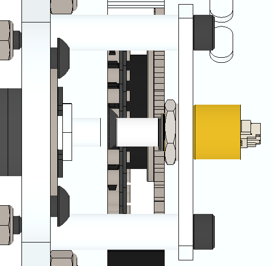

We turn a shaft with a 1/4” boss, and then use a spring shaft coupler to couple the boss with the encoder. The encoder has a slim nut and a spring washer, which you can use to lock it down on a fixed plate.
Here’s a picture of what the stackup typically looks like:
We standardize on the distance between the two standoffs on the outside at 1.75", so all of our gearboxes have room for an encoder in the future.
You can use pretty much any coupler - these Amazon ones are what I believe we use: https://www.amazon.com/6-35x6-35mm-Flexible-Coupling-Motor-Coupler/dp/B00N732LVI
