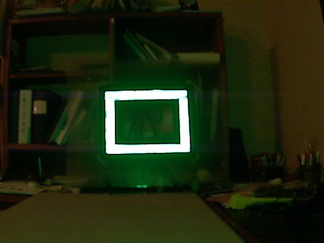

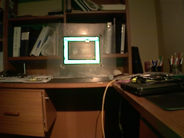

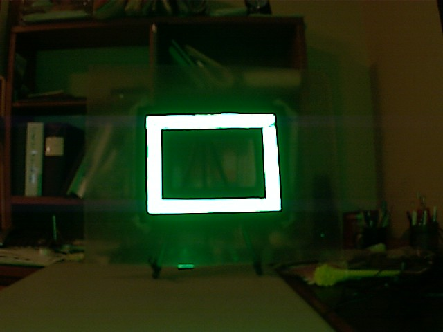

These lights were available as selection from “FIRST Choice” at beginning of season. We found a significant difference between trying to add lighting by positioning lights around the camera and using one of these ring lights mounted with the camera lens pointing through the center.
http://www.superbrightleds.com/cgi-bin/store/index.cgi?action=DispPage&Page2Disp=%2Fmini_tubes.htm
Attached are some sample target shots using a ring of green leds.
