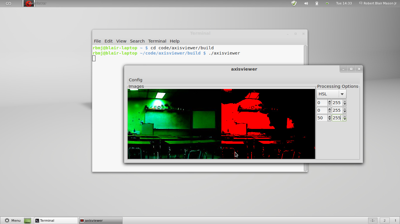

Hi everyone,
I’ve written a small program to help with vision processing for FRC. Right now it only does the thresholding, but you can use it quickly see the results of thresholding ops in real time. The idea is that if you need to recalibrate your vision processing at competition, then all you have to do is plug your laptop in and you can get new values and see the result of the thresholding ops as you change the ranges. I’ve tried to make the thresholding as similar as I can to the cRIO’s.

I’ll put a screenshot up tomorrow.
If you want to use this with your own, just go to Config->Set Camera IP and use that. It should also theoretically work with other IP MJPEG cameras too, you just need to get the correct delimiter. Maybe I can add something to guess the delimiter in the future…
Any suggestions or patches are welcome!

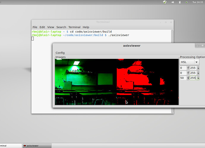

OK, so here’s a screenshot. Should be self-explanatory.
Very nice.

@kenavt: There were a few motivations for me making this program.
  1. I don’t like having to go into the web interface for the camera, grab a snapshot, open it up, process it, repeat the process to see if it works, etc. So of course the logical thing to save 30 seconds of time (for a programmer) is to spend hours on a program that grabs the stream from the camera and processes it in real time :smiley:
  2. Since the source code is available (and will be made more pretty soon) for the image processing, I’m hoping that anyone who wants to look at the calculations for HSL and the thresholding (and maybe more algorithms in the future) can just open the file and learn from that. You can’t do that with NIVision.out (unless you use objdump! - no random NI person who’s reading this, I did not disassemble your proprietary code)
  3. I like having applications that are crossplatform and lightweight. I personally use linux for all of my development, robotics included, and I prefer to have native builds of my toolchain and development tools.
So, in essence, convenience, open source, and portability provided the reason for writing the program.
