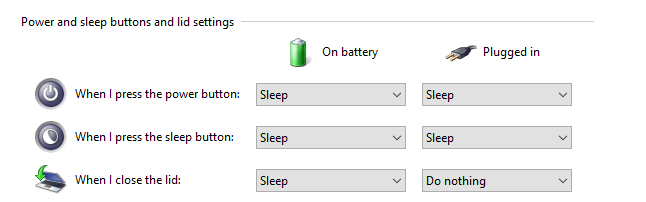

We had a similar thing at our comp. I noticed it was behaving weirdly when I shut the screen (it went into hibernation, which is not default, and is a weird choice that I feel like I would’ve been told about), and when I checked the define power button settings, all 6 of the boxes were blank. I just assumed that was big bad so I changed all of them to settings that made sense and then restarted the computer.
After that, we restarted the driver station before every match and didn’t have an issue. That all to say, I think something silly goes on with some combination of Driver Station and Shuffle board where some cache somewhere gets super clogged, and sometimes just restarting can help.
