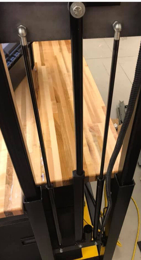

Does anyone have any tips on balancing load when using pneumatics? Some of our projects use standoffs to add spacers from where the piston mounts to the shaft, but the shafts of the pistons always are either bent or violently screech since they are not perfectly straight when they extend. As context, we are using pneumatic cylinders from McMaster-Carr to create an extension for our Super-Pit build, and we keep getting nails- on- chalkboard feelings from when the pistons fire.

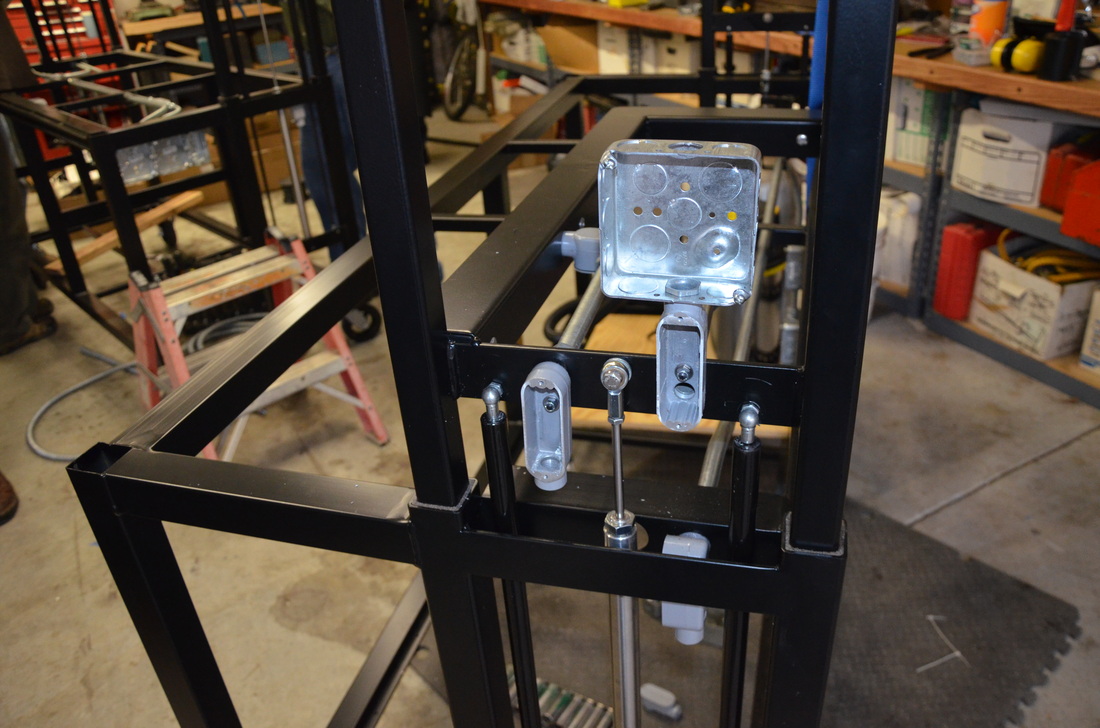

Here is the thing. As in the diagram we showed earlier in this thread, we are using the same design as Greybots. Two unpowered pistons to guide the one driving piston. The problem we have is spacing the piston off of the metal bar. Because the piston is attached to the outside of the metal slide, the top of the shaft, or the piston head, is spaced further from the metal tube than the base. Because of this, we have about an inch of space, causing the piston head to bend when it fires, and the connection point to the top of the gantry is also now bent due to the weight of the top of the pit setup.
The usual solution is to use trunnions or ball joint at both ends of a cylinder so that the rod does not have to bend if things are not perfectly aligned.

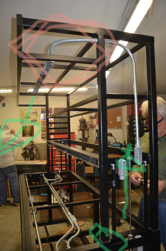

We have a few compressors that work with FRC robots, the small 12v one that’s just a motor with piston. Since we are using Bimba pneumatics, we can just use a threaded pneumatic coupling and some pneumatic air hoses for the job. That’s not a problem. The pistons not being balanced is more of a problem. I think we need to either have a second linear slide attached next to the piston or behind the workbench to balance it, since whenever the piston fires, the shaft bends and screeches since the top of the gantry is heavier on the opposite side of the workbench. Here:
(This is from Greybots, I don’t have access to mine right now since I’m not at the workshop)
aw. So there is a moment (torque) on the upright of where the tubes come together. Got it.

You are getting binding because of this offset of center of mass vs applied force. To address this you will likely want to reduce what can bind from the clearances. The gas springs and pneumatic cylinder are 2-force members, which will not be taking up any torque load the tube is experiencing. You can tackle this a few ways.
  1. Use something like PTFE (Teflon) Tape. Everything must be very clean and deburred. Apply this on:
  • the front most upright inner tube (whole length that slides)
  • the front inside top ~3" of the outer tube
  • the inside back of the outer tube (whole length that slides)
  • the back bottom ~3" of the inner tube
  1. Apply a bearing or bushing situation - a bit more involved, but you are basically making a tube-in-a-tube slider. You will need bearing down inside the outer tube attached to the inner tube likely as well.
  2. Use a much more powerful gas spring on the front, as this is closer to the center of mass. This spring force is calculable relatively easily using a free body diagram if you know where you center of mass is on the upper portion.
Keep in mind that when selecting gas springs and cylinders these are for a relatively narrow range of mass up top and it may be sensitive to changes (including tipping, moving, or other dynamic scenarios)
Yes, thank you for the summary of my problem. Someone finally gets it. Finally. Yes, we are using pins and holes to hold it up. Yes, we have PTFE blocks that allow the tubes to slide in each other. Yes, I have tried all of these things, and they are helpful, but I think the solution is to use a thinner-wall aluminium tube for the overhang. I also think having bars that can be detached from the top to support it (kind of like a car hood or a piano) will also help.
