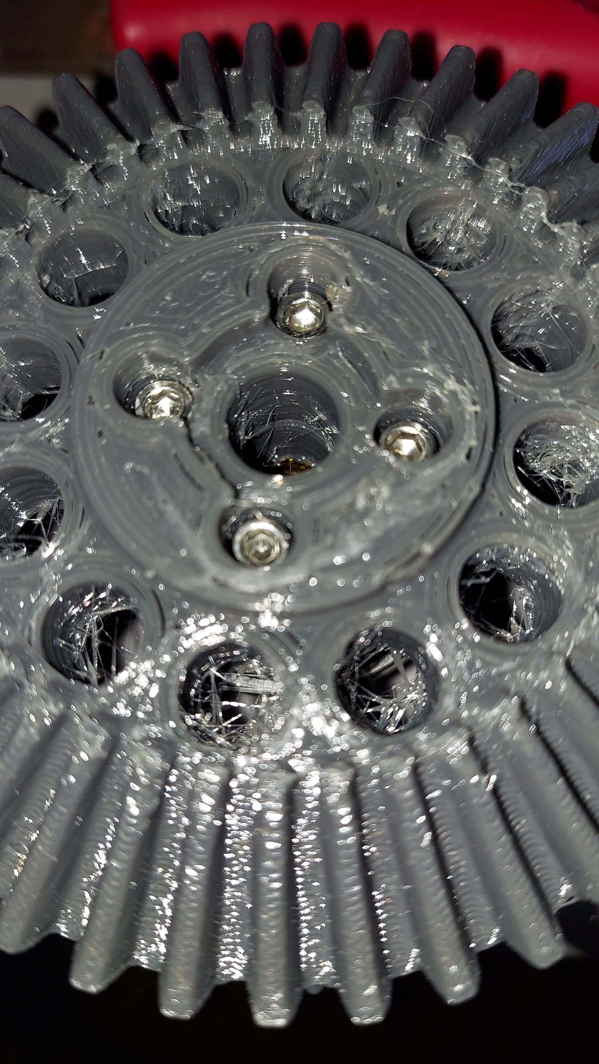

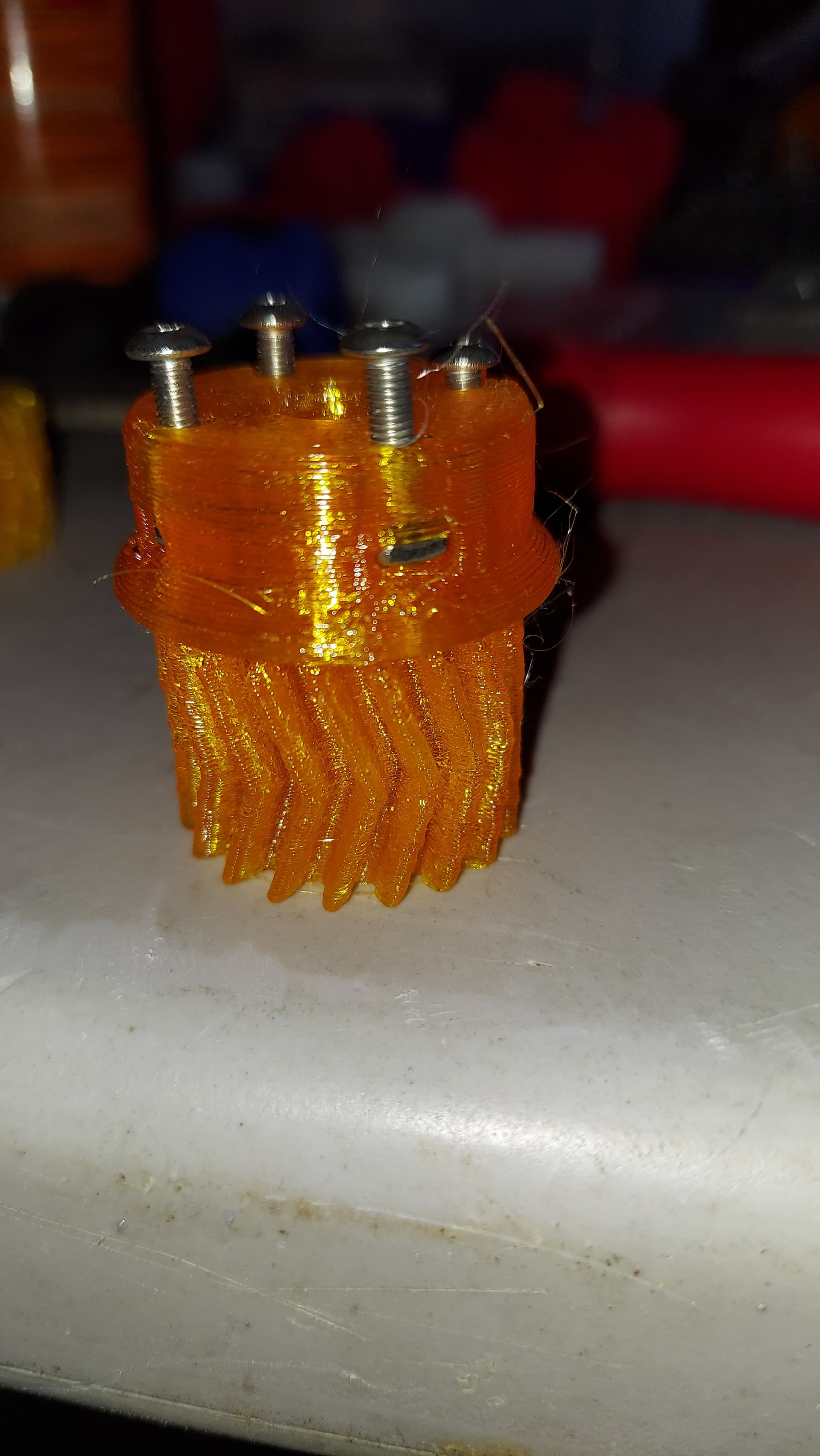

Gluing/bolting the balls together - 3 balls almost done

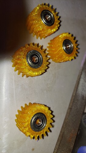

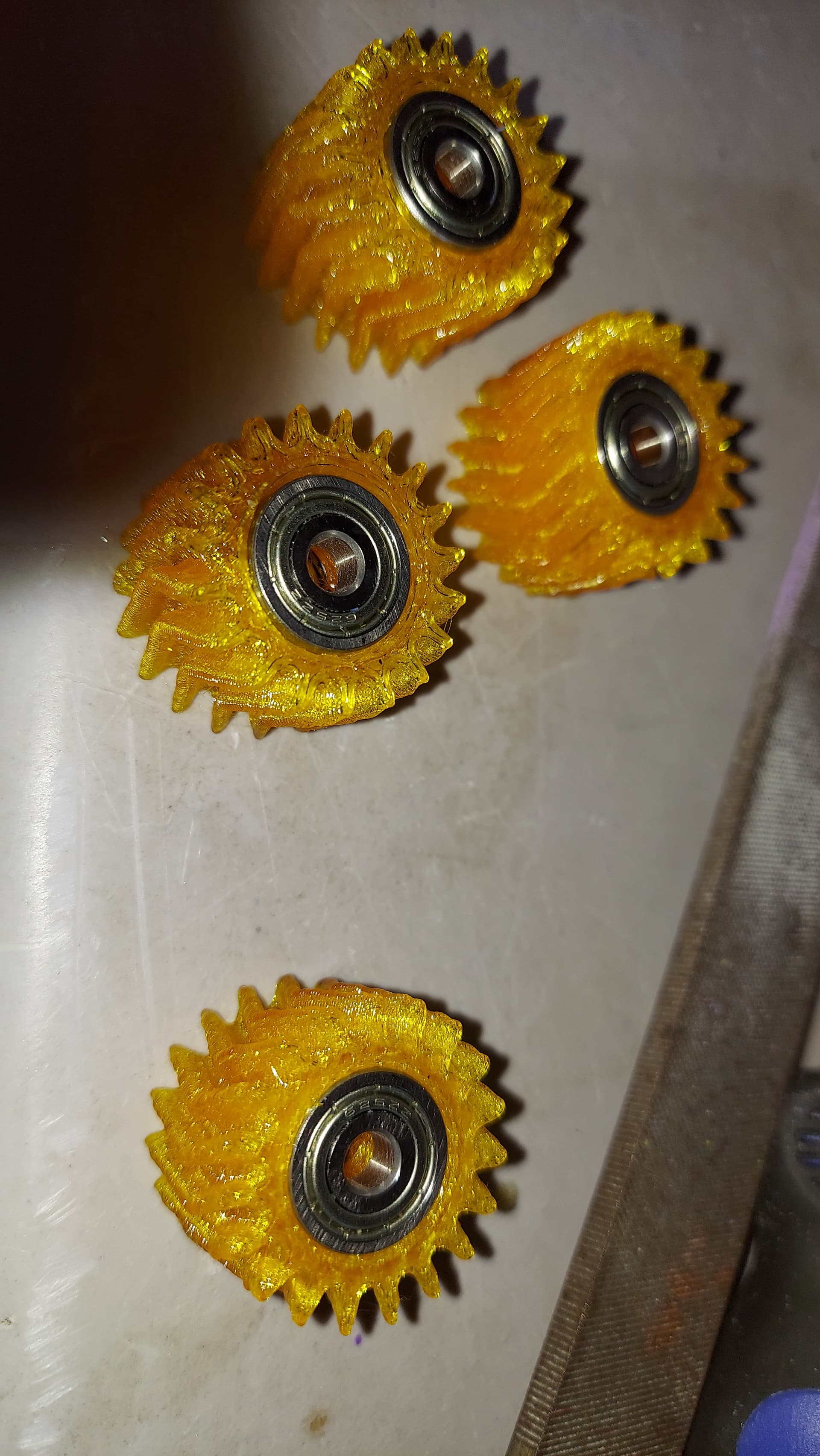

Planets with 625 bearings inserted
sun with square nuts inserted and some tem bolts to show how that will work

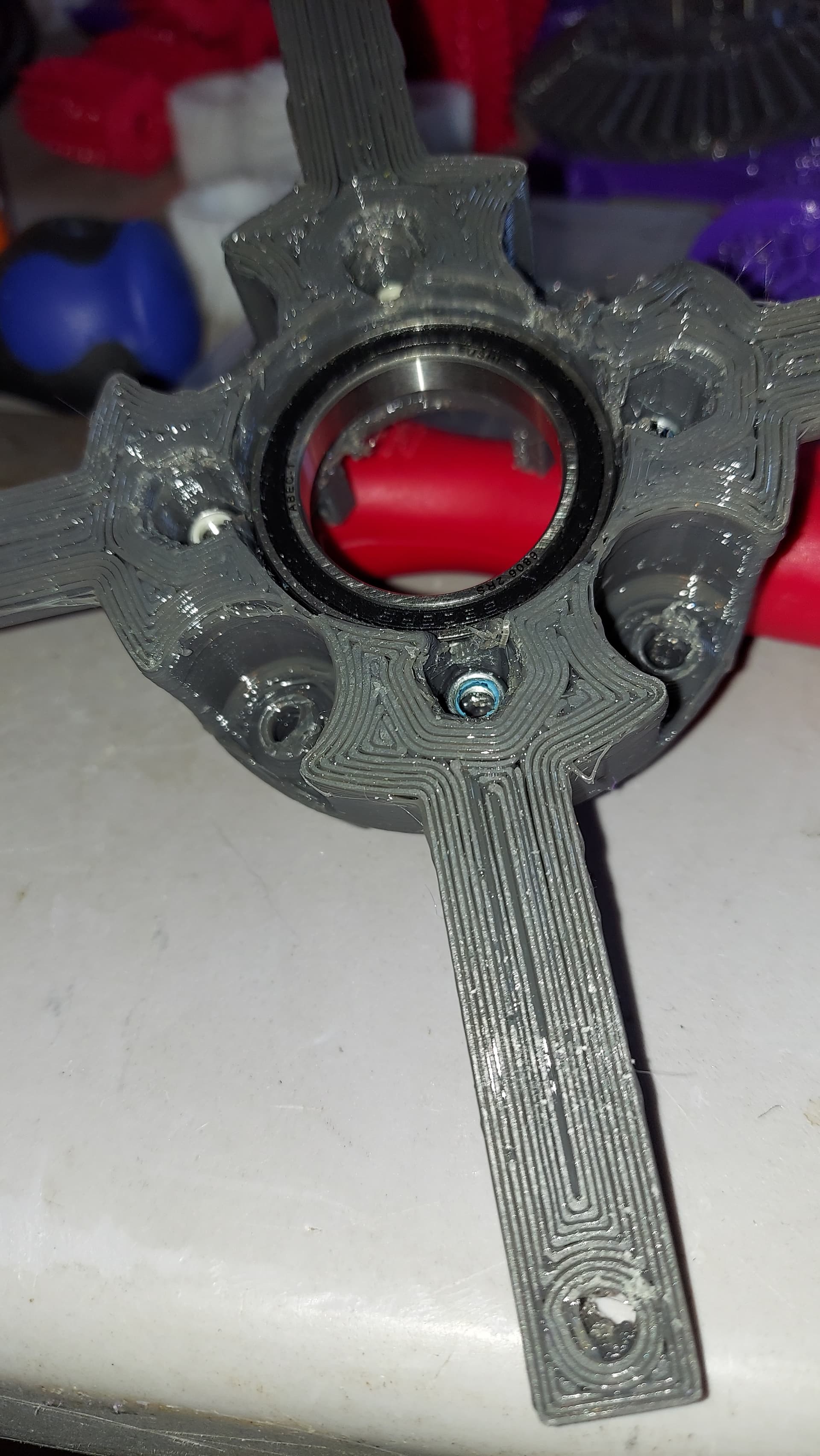

Motor side planet/partial wheel mount with nylock hex nut (m5) press fit
the hex recepticels for the M5 nuts have a 2.5 deg taper. So its possible to insert them quite easily and then jam them down
The other side. During assy a temp M5 bolt screwed into the nut makes sure you jam it down straight
Also note 2mm spacers printed for the planets and a 1.5 mm clearance to the planets of the body to help keep the lube close and also doubles as an alignment helper during assy.

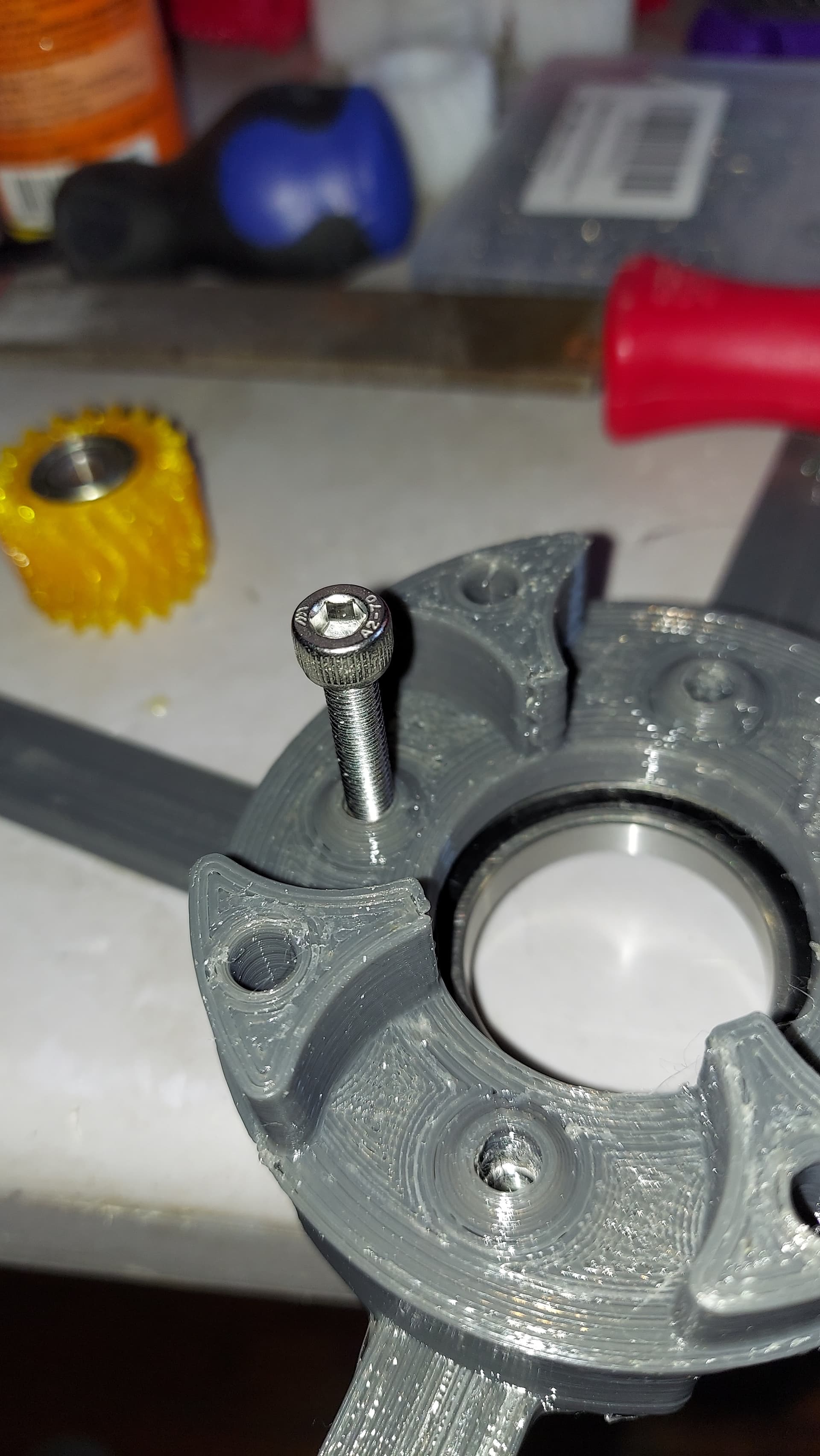

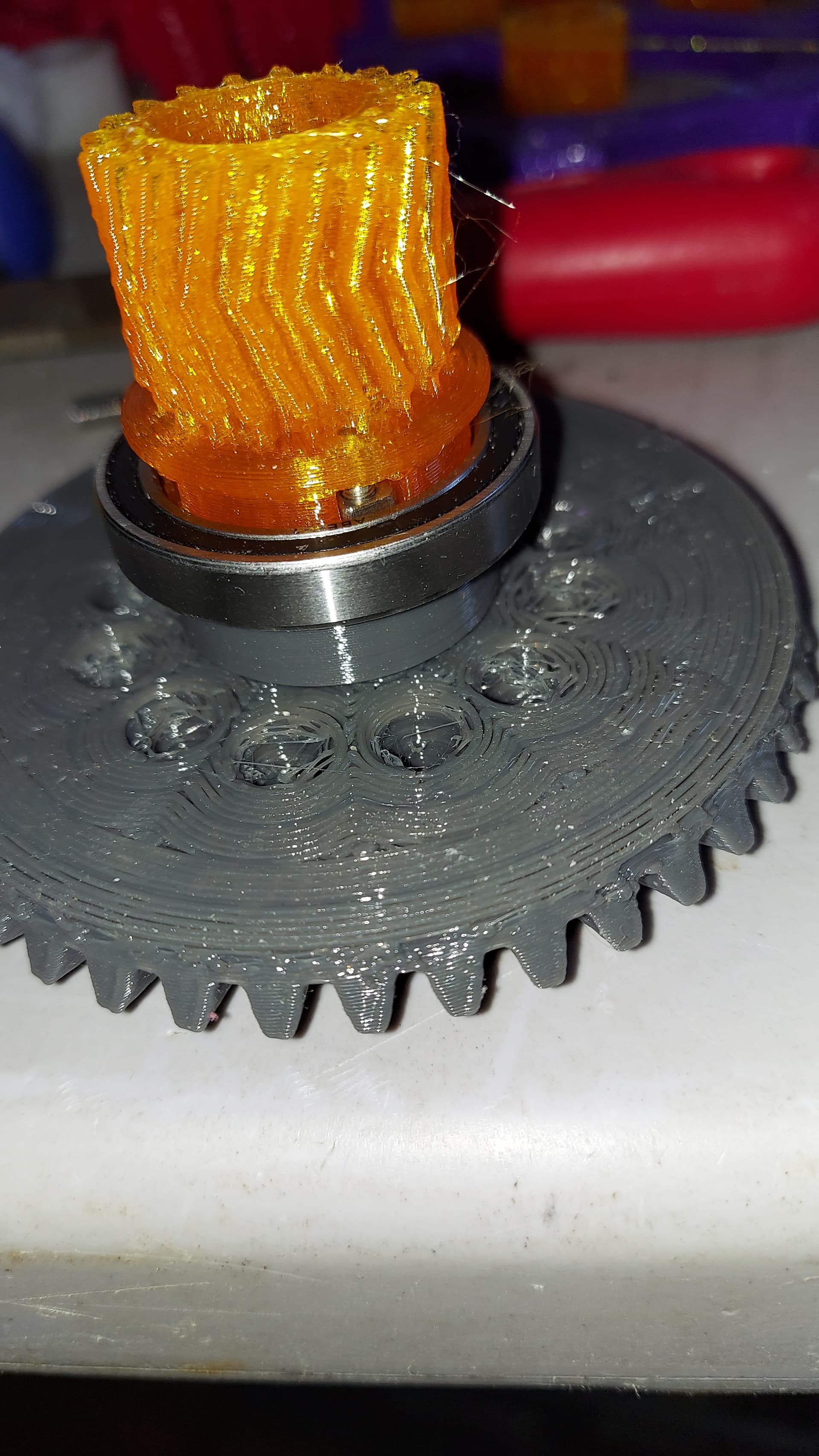

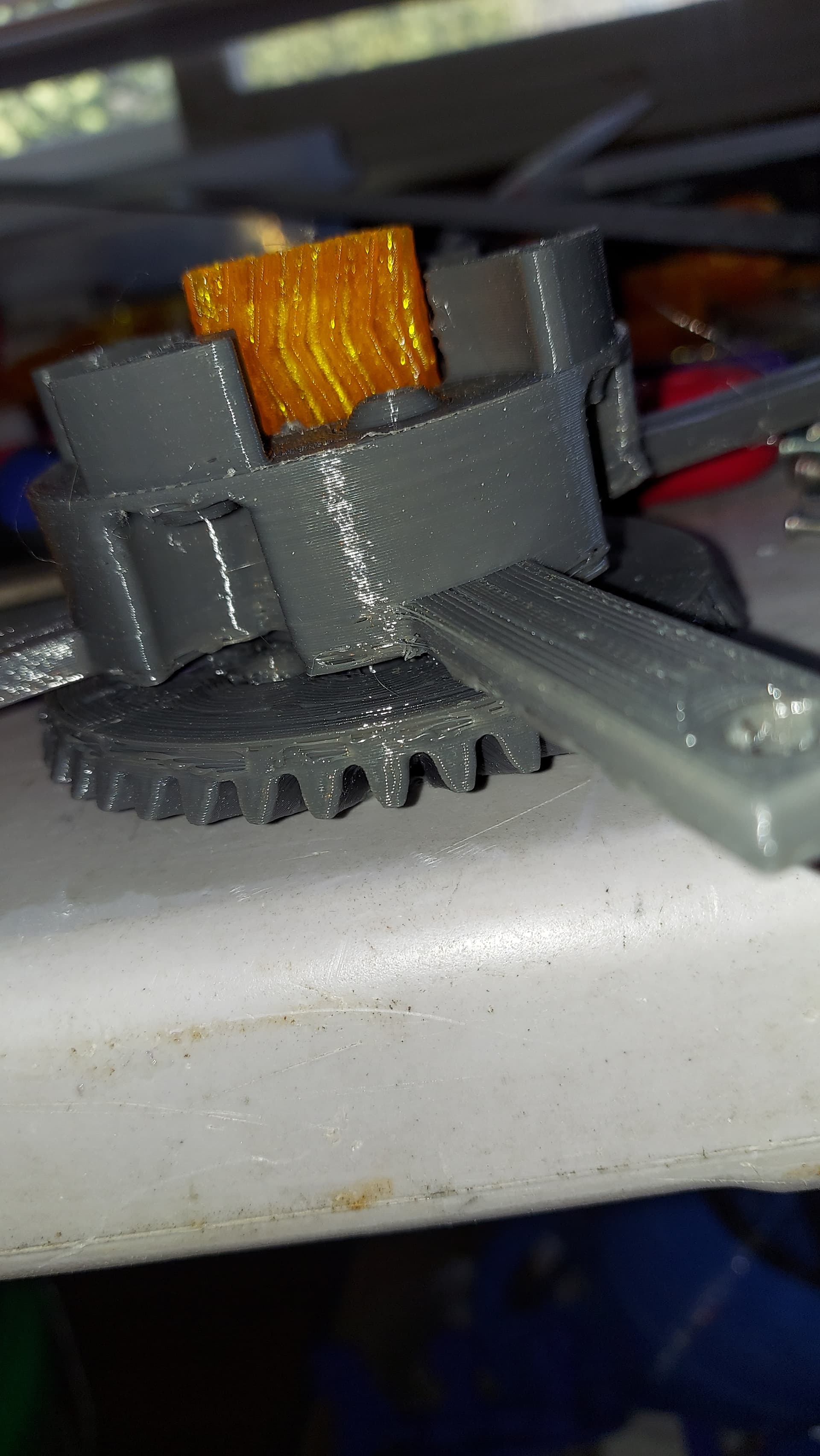

On the bevel input gear the m3-30mm machine screws are recessed below the 688 bearing that will align everything on the 8mm or 5/16 center shaft the tolerance for the M3 bolts is on the tight side both here and on the sun
Assy with the spacer and the sun gear and the 6806 bearing
Bad news - the sun sits a little to low - so that will require a redesign/adjustment and reprint. I show that to demonstrate - not everything always fits the first time out

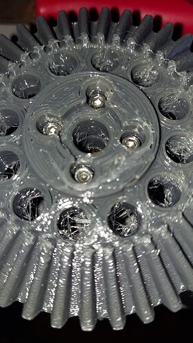

first I tried regular playground balls - that failed as they were pneumatic and the inflation changed their size. Also if they were hard which they needed to drive then Andymark 6 and 4 in omni had insuficient grab and so did gobilda 5 in.
So next some tpu. and again the above omnis had insufficient grip on the tpu even though their rollers are TPU too I tried 3 different TPU. The rollers on those omni seem to be 95 + hardness TPU. So I have 90 TPU which I printed a roller in and that slipped too (figuring that a sim can put out about 6 in/lb max at 40 amps (without blowing the circuit breaker at a reduction of about 10 to 1 thats 60 in lb so that on a test skid pad on a 6 in wheel is 20 lb pull force simulated with a scale with a partial circle sledge loaded with 60 lb ( a little less than 1/2 robot you probably will have less than 40lb average per wheel (125 lb max plus batt and bumpers is about 150lb /4)
So not having the carpet the drive transfer from the omni to the ball would slip assuming that traction to the carpet is 100%.
So I put holes in the balls and teeth in the rollers and that does not slip
BUT

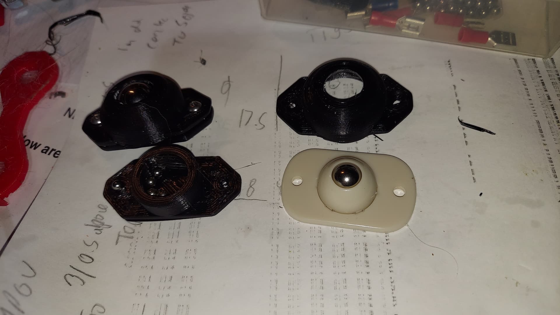

The furniture mover balls I used made for an awful ride on all those hores as they are about 9mm and the holes need to be 3.5 mm. So…
I got some 15 in balls laying around and lots of 4mm balls and some 3d printers - so
I printed some holders on the bottom right is the bouht one with the “too small ball” top left is a 15mm ball assembled and you can see the top piece and the bottom piece with the 8 4mm balls inside - the 15 mm ball will push them against the walls and keep them in place
Now the 15mm ball gives a much smoother ride. I also ordered some 20mm balls but they wont be here until first week in may. So I am starting on a prototype with the existing balls and rollers and the 15mm bearing balls to contain the 6 in ball.

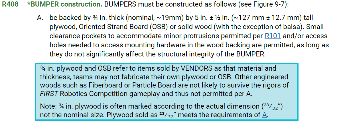

As mentioned in that thread, I think the legal way to get truly round bumpers, (as opposed to a many-sided polygonal approximation), would be to steam bend solid 3/4" wood (oak and hackberry are said to bend best).
Only the way I read it you have to start off with a sheet of plywood and I was told (I am not a woodworker) you cant bend - even steam bend 3/4 in plywood that much. Maybe someone with the proper equipment could try it somewhen
R408. You can use plywood, OSB, OR solid wood. The oak or hackberry above are not balsa and therefore would be legal.
