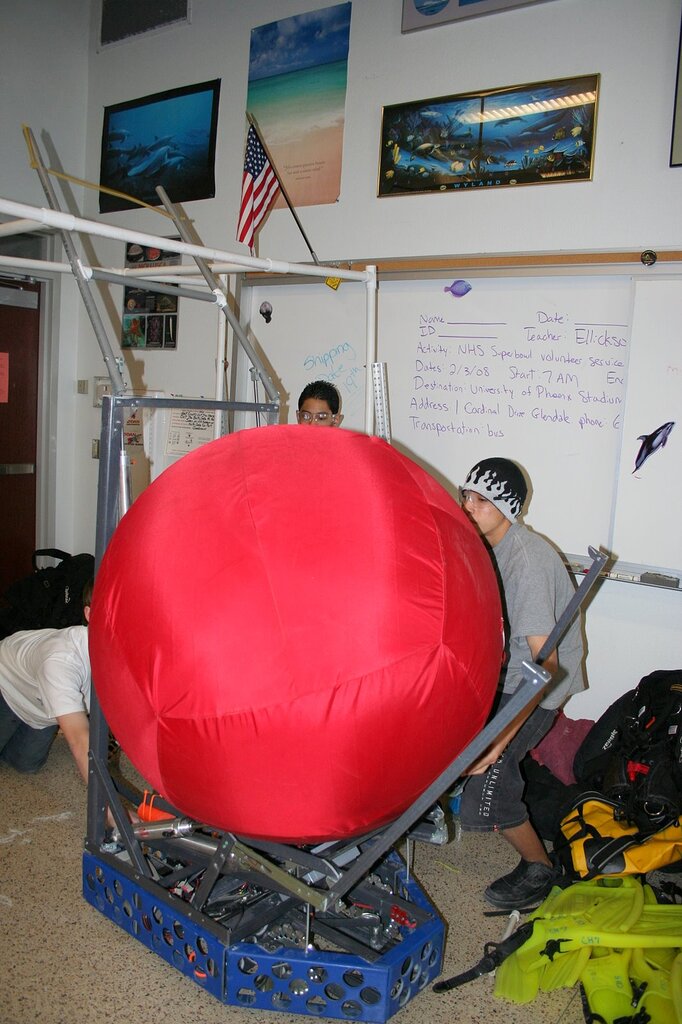

here’s an example of knocking the ball off and catching it…
and I think there is video of it somewhere also, but I can’t find that just now.
(they’ve reinforced the “twisty” parts since this picture was taken!)
