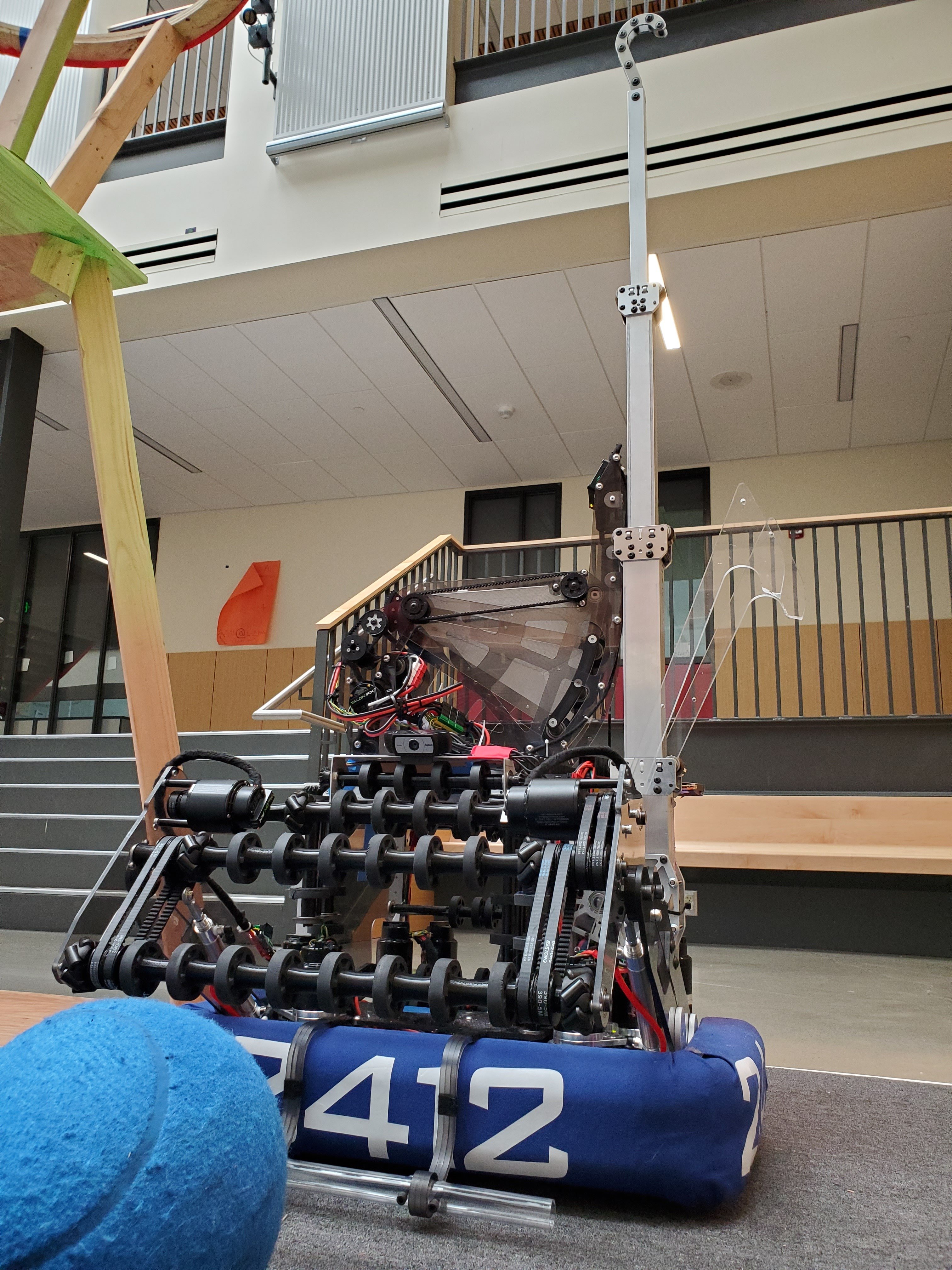

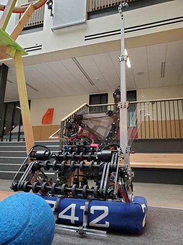

Has anyone else had a problem where during intaking, cargo will become stuck spinning against the floor and bumpers of the robot? How did you overcome this?
Part of the problem we had at Ventura regional were field balls and carpet were different than even the practice carpet with beat-up balls (which I presume were due to extremely heavy wear on the carpet and balls), which made testing and diagnosing the issue extremely difficult.
We have a bumper bar that passively falls out of the robot at the beginning of the match. When we run into a ball the bar prevents it from spinning on the bumper
