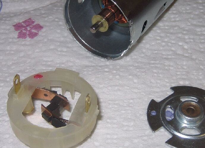

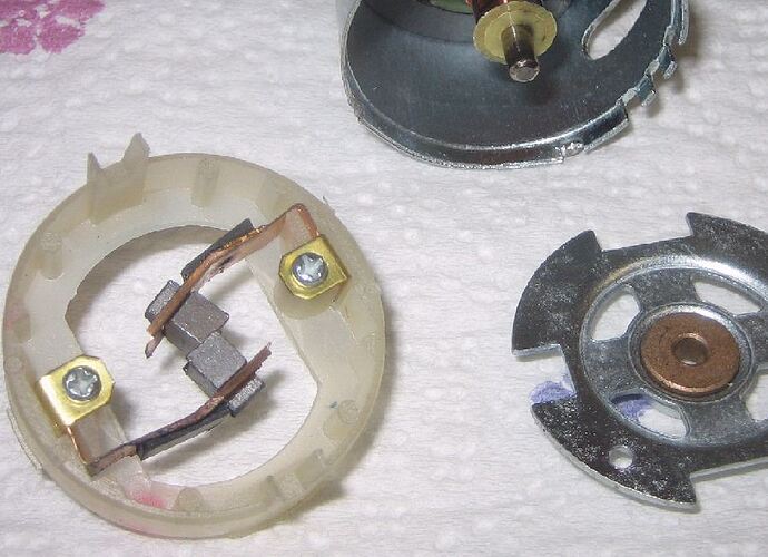

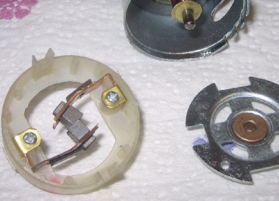

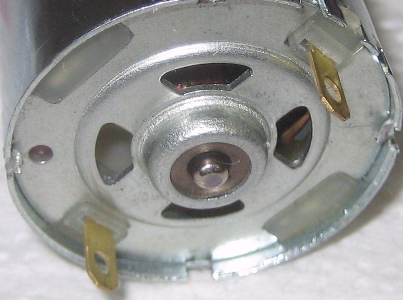

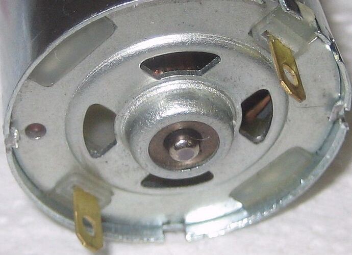

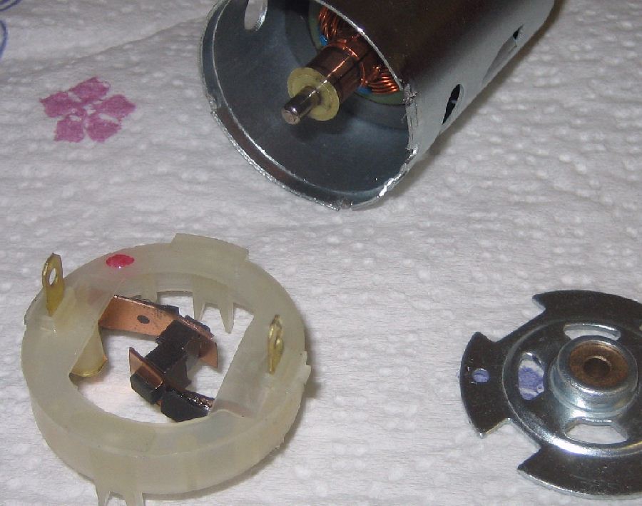

I just ordered a few more of the RS540 motors, at $3.55 each it’s worth it to be able to take one apart and learn more about them. We do have both FP motors unused, might be a good idea to see about installing a BB pinion on one…and also to make sure the RS540 motor wires are well supported, right now they’re just hanging.
here are some pics of the brush holder and such of a Banebots RS540 motor.
(edit: added “before” picture)
FALSE ALARM
It must be getting late in the build season! The aluminum racks on our double rack and pinion gets shaved of by our titanium pinions. These shavings fell into awkward areas on our banebot system. Needless to say the electrical short that was happening was not the fault of the motor or bane bot, it was my own fault.
