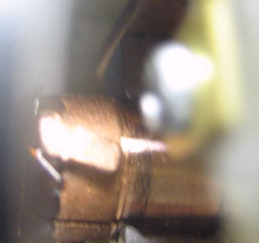

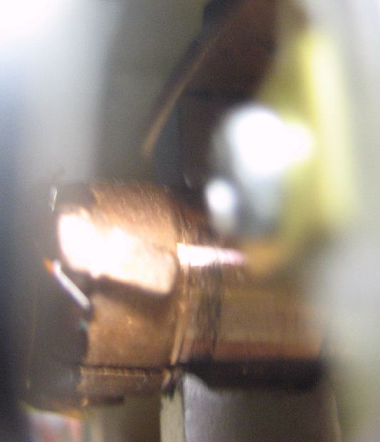

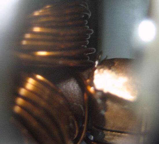

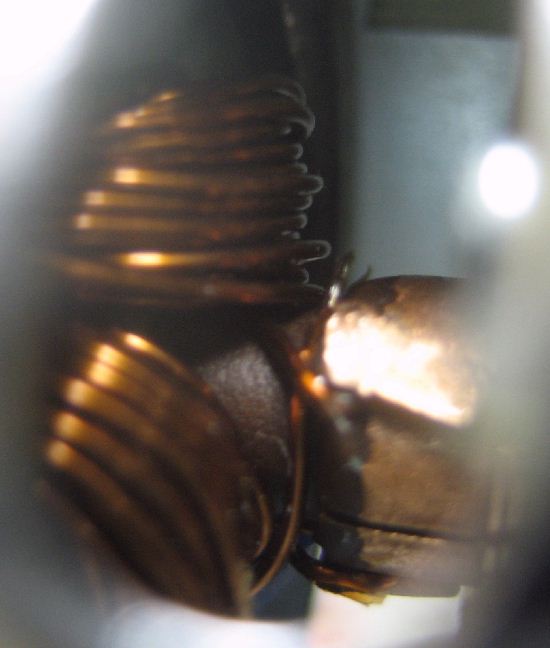

Now I’m really curious…where is this “fan” you speak of?
(yes, I have a 36mm BB gearmotor right here and I’ve been looking at it)
If you look at the slots in the side of the motor, you will see a white fan. The blades are on edge. When the motor runs the fan “throws” the air out through the slots and draws air in through the other holes in the motor.
When I look in the motor of my new Craftsman cordless drill, I see a white plastic fan, as you describe. But when I look at a BB RS540 motor, I see no fan at all. Here are some pics taken thru the slot in the motor.

There is no fan in the banebots motor. If the holes in the front
of the motor where the output shaft are open the spinning
armature does cause some air flow through the motor. Nothing like you
get from the little white fan from the FP motor, however.
