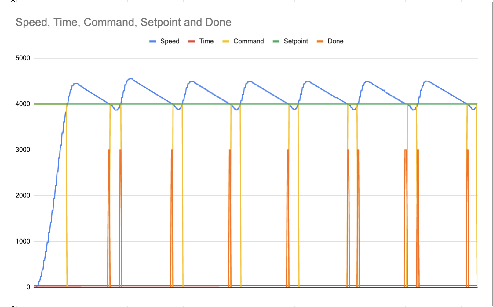

We’re running a bang-bang control system at 100Hz for our flywheel using the integrated Talon FX encoder and are seeing some odd behavior.
In this graph you can see the issue. The blue line is the measured RPM, the green line is the desired RPM, and the yellow line shows when the motor was on.
You can see that the speed continues to decrease even after the motor turns on, and also continues to increase after the motor turns off. The graph only makes sense to me if I shift that blue RPM line over to the left.
We believe that the measured RPM is averaging over a past period of time (documentation suggests 100ms), and so the controls are not responsive. By the time the integrated encoder measures that the flywheel is at the correct RPM it is in reality at a much higher RPM.
We’ve added an external encoder and have our bang-bang control working well now. Is there any advice on how to get the integrated Talon FX encoder to give us a more up-to-date RPM measurement? We’re aware that we can run a PID on the Talon FX itself - but we’re curious about why this happened and how we can fix it!

It looks like there’s two issues going on. The first is the averaging that happens as part of the Velocity Measurement and Averaging Window configs, and the second is the rate at which you can get the sensor values from the API.
To solve the first, you can configure the TalonFX to use smaller averaging windows and sampling periods. The relevant documentation about where to start and how to determine what is “good” is here: Bring Up: Talon FX/SRX Sensors — Phoenix documentation
To solve the second, there is normally two ways, the first being to set the status frame period of the relevant frame, however…
I’ve added a tracker to include Status_21, so that should get picked up in the next release.
The other way to solve the update rate issue, and the way we recommend for most sensors, is to set the integrated sensor as your “selected sensor” and use the selectedSensor API, which default updates at 20ms and is available in the setStatusFramePeriod API under Status_2.
Documentation is available here: Bring Up: Talon FX/SRX Sensors — Phoenix documentation
Note: TalonFX by default selects the integrated sensor as its selected sensor
