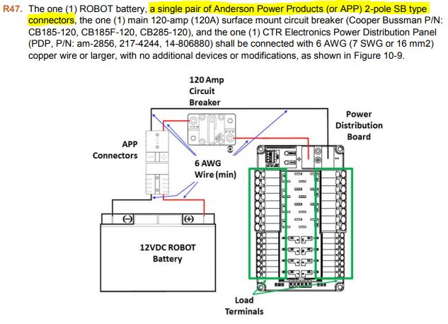

I need to know if I can use more than one batterie cable (like an extension) to connect the baterie to the power supply and turn the robot on

If your question is whether or not you can have multiple SB50 connectors between the Battery and PDP, the answer is no. See rule R47.
No. According to R47, you can only have one SB connector between the battery and PDP.
R47
Having an “extension” would mean there would be one SB connector on each side of the extending cable, which would be illegal.
No extensions using connectors.
You can make the cable from the PDP to the switch any length you need by using the appropriate cable and connector.
If you make your cable at the battery end longer than 12" you will need to accommodate the extra weight into the robot’s weight for passing inspection.
Keep in mind extending those cables can affect power performance.

You are only allowed 12" of wire between the battery and its Anderson connector. There is no specific limit of wire between the robot side of the connector and the disconnect switch and or PD board. So make the robot side as long as you need.
