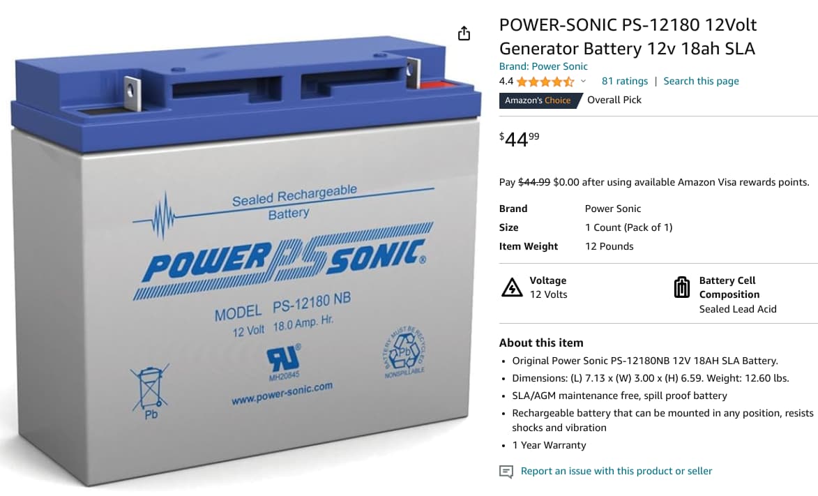

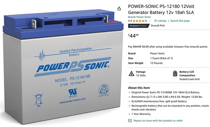

If I absolutely had to buy an FRC battery from Amazon, it would be this one:
It’s already on the approved list and in my informal testing it’s every bit equivalent to the MK.
We use these batteries that we bought from amazon. https://www.amazon.com/Power-Sonic-Genuine-PS-12180NB-Rechargeable-Battery/dp/B00BMUEN9Q
Through our pretty informal testing they do not have any significant performance difference compared to our MK batteries but this would need to be validated through a CBA.
There’s some positive reviews for Powersonic from you and another commenter in this thread: Battery Brands. I think we might try that next year.
Out of curiosity, was the battery you mentioned purchasing and testing the discharge of purchased from Amazon or somewhere else.
It was from Amazon and at the time the price seemed too good to be true (something like $36 shipped). That battery is going into our competition rotation since one of our MK batteries puked out its guts last weekend.
Out of curiosity, does the battery have any sort of date/SN stamped on it (I know our MK batteries do). With Amazon, I’m always worried about them mixing stock between different distributors, but the distributor for some of the listings I’m seeing (“AAA Security Depot”) is an official Powersonic distributor so it should theoretically be fine.
The practical concern would be getting an old battery that’s sat on the shelf for a long time.
The Powersonic I tested did come from AAA Security Depot, from Miami IIRC. It currently has our usual competition battery number label stuck squarely over the lot number.
FWIW - We (the OP’s team) did end up buying 6 PowerSonic from Amazon after seeing them recommended as a good budget option by a few different people in this and other threads. They all work great! We will be taking them to our week 4 Iowa Regional.
