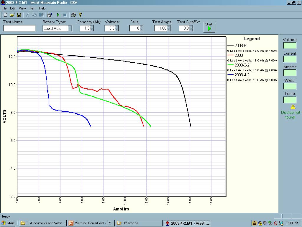

The 7.2 amps is sufficient. set your cutoff voltage to 7-8 volts, which is the cutoff for most of the battery spec sheets. It will take more than a hour to run the test. After a few minutes the battery voltage should fall a slight amount. This is due to any remaining surface charge and the all of the components reaching a set temperature. After that the voltage should remain relatively constant until the end of the test when the curves start to drop off to the 8 volt limit. The program runs constant amp hour calculations and should match the battery curve very nicely on a good battery. What you are looking for is a drop of 2 volts during any part of the test. This is one of the cells giving up. I have a had a few batteries where one gives up and then a second gives up a little later. The cell loses capacity if the electrolyte is not full in that cell or if one or more plates have broken within the cell. On a rare occasion a battery will start off at 10 volts indicating a cell is shorted. Once the test is complete, save it with a unique ID that you also mark on the battery. That way you can track the same battery from year to year and watch for end of life when the battery no longer can ~18 amp hours. The program also allows you to overlay several curves so you can look at the same battery annual curves or you can compare batteries you want to use for competition. The 7 amp discharge is nowhere near what the robots will pull during a match but remember you are testing to manufacturer spec in this test and that is really the only valid test to determine if the battery meets spec. I also recommend that if you are testing a suspect battery, try moving the cables around and tap on the battery to see if you turn up any intermittent voltage dips. We added an Anderson connector to our CBA II to make it easy and all of our chargers are also so equipped with the APP connectors. We do not use alligator clips and neither should you.
If you search, I put up some curves a long time ago to demonstrate all the possibilities.
Is this the one?
Here’s one from Hugh Meyer:
http://www.chiefdelphi.com/forums/showpost.php?p=916447
Yep, but I didn’t want to make it that easy.
I am also a proponent of the West Mountain Radio CBA III. I agree at first, you will not know how to interpret the results, especially since the graphs auto-scale to fill the screen.
The real value of the results shows up when you overlay the test results. Then you see the differences between tests. I test each battery at the beginning of the season and do an overlay of all the batteries. It becomes easy to see which batteries are the strongest and which are getting weak.
The other use is when a battery is suspected of getting weak. Test it again and overlay the results with the test you did at the beginning of the season.
Bad cells and broken internal connections are quickly spotted with the CBA III.
