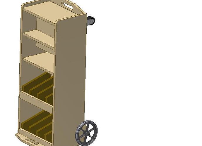

Paragon, Team 571 has a paper posted in the white papers section for building one. We’re building one based on it.
I won’t be at the site until Monday, but I will get a picture of the 571 one and post it here if another member doesn’t already

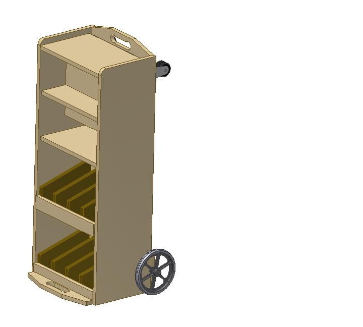

We have used the one pictured below for 5 years, and a number of other teams have built duplicates from the plans.
Key features: Easy to build, Easy to move, Minimal Footprint when upright, holds 8 batteries and 4 chargers, one person loadable into a truck/van.
PM me and I can send the Inventor model and build drawings if you are interested.

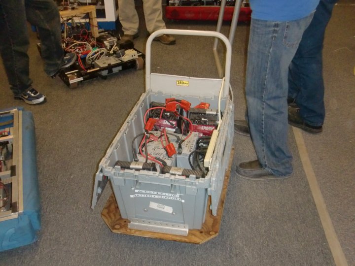

This is our battery cart. It uses a KOP tote, with 4 chargers, and can hold 8 batteries. The cart itself has 4 casters and a fold-down handle for easy transport. C-Channel is used to make a lip around the tote so that it cannot slide off the cart. The wood seen is 5-ply, because the original steel cart buckled under the weight of the batteries. As such, we stole the handle and casters off of it, and built the new one out of plywood. Also, there is a plug strip on one wall of the tote, to connect the chargers, and also programming laptops in the pits.

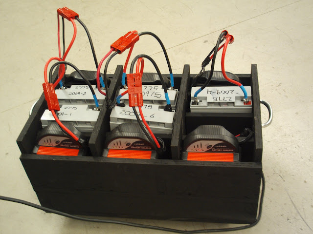

639 made 2 battery “arks”. It’s basically a long toolkit with a handle on each end. Roof is made of thin cardboard (waterproofed with duct tape!). 4 people can cary them into competition, set them down in our pits, then we get out a power strip and plug in the chargers. All of our good batteries and chargers can fit in them with room to spare. It also can make it very easy to pick out a battery. Highest charged ones are kept on the side closest to the robot, just slide them all forward when you swap a battery out.

Our team has something very similar only it holds three batteries and three chargers allowing it to be small enough to fit on our shelves in the pits and light enough for one person to carry.
My advice, smaller is better in the pits, but make it usable for other purposes such as storage when in the pits.
