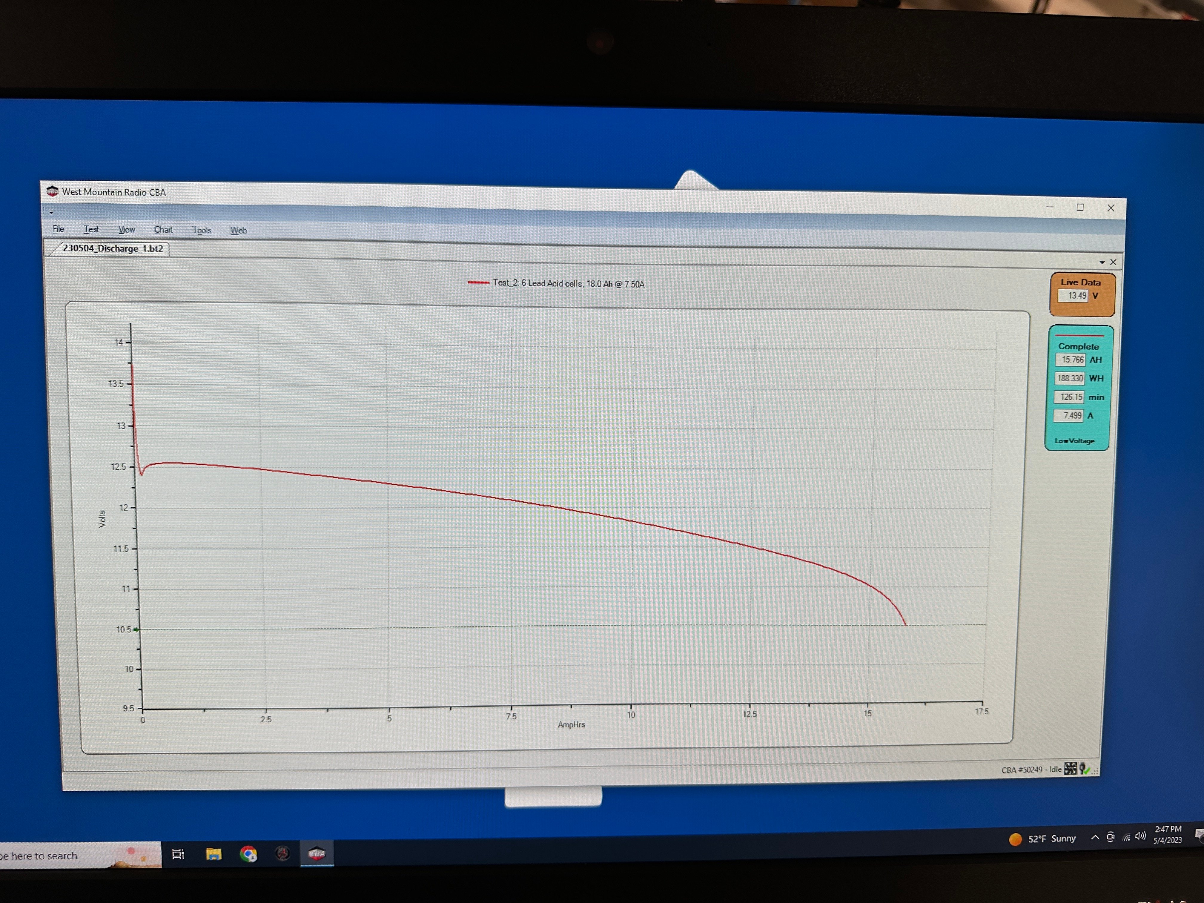

So, when using the CBA, should we let the surface charge dissipate or can we run it once we pull it off the battery?
Surface charge will dissipate extremely quickly (<1min), it shouldn’t affect your overall ah results if you just start the test instead of worrying about it.
Here’s the chart of a CBA test on a battery that was at 130%
