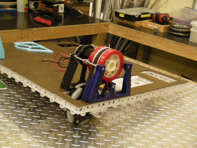

We 3d Printed one
SANY0013
SANY0015
Its the white rectangle next to the 3d printed Planetary gearbox

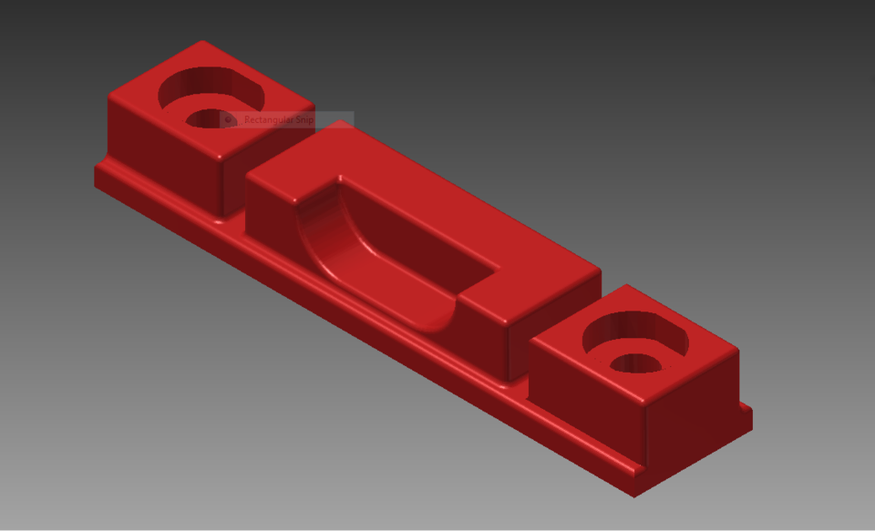

we 3D print hooks that fit into the slots underneath the terminals and then just velcro across the top. that constrains it from top to bottom, and side to side.

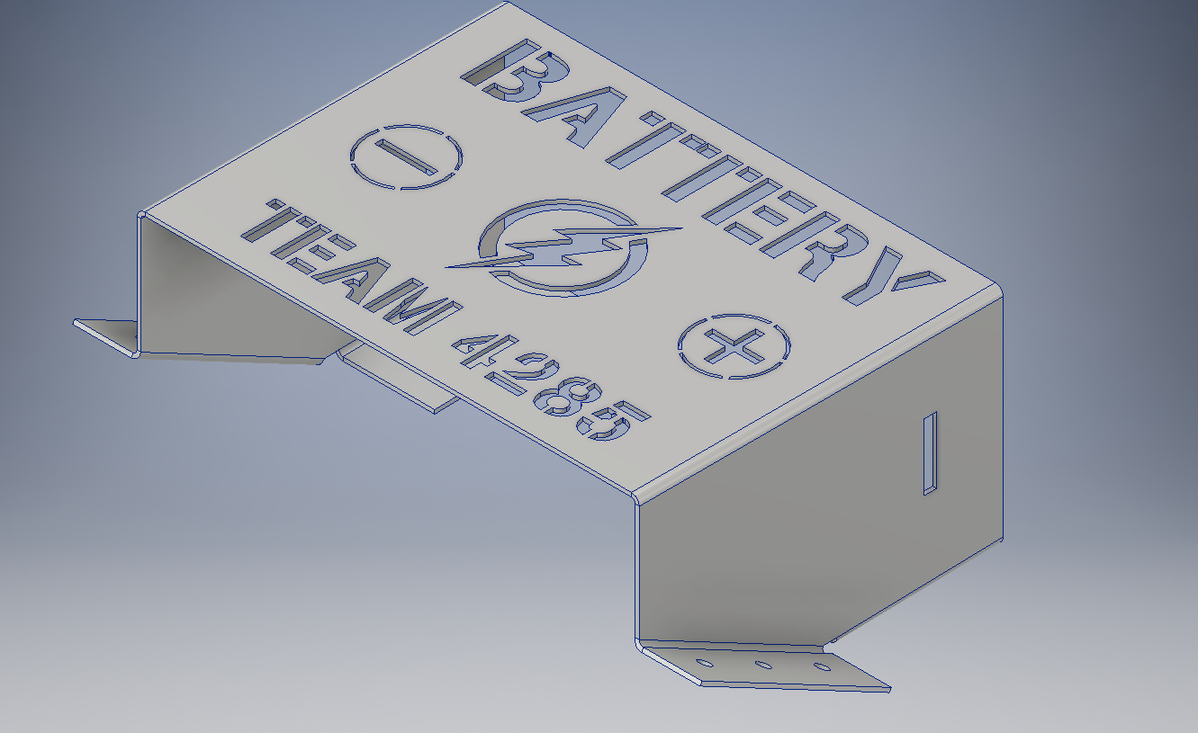

We made our own out of sheet metal however something similar is probably buildable by bending lexan or something of the sort.
