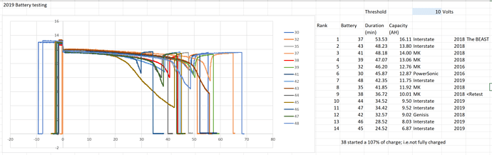

Gonna chime in here. Our kop battery (SPS brand) performed the worst on our battery tests out of 14 batteries from 2016, 2017, 2018, and 2019. An interesting side note: The mean weight of 12 of the 13 batteries that aren’t from the 2019 kop (the 13th battery was not available for weighing) is 13 lbs with a standard deviation of 0.37 lbs. Our kop battery weighs 11.4 lbs. Not sure if this is significant, but I found it interesting.

Following up on Firecrafty, Here is a screenshot of our battery testing results:
(Vertical axis is Volts, Horizontal axis is Minutes)
2019 Interstate batteries don’t show well. Did something change in their manufacturing?
Interesting that 2018s show very well.
Test is approximately a 1C discharge test.
This confirms our anecdotal observations from Week 1.

Are the batteries AM sells ok?
AM sells the aforementioned poorly-performing Interstate batteries. Our experience was not great.
