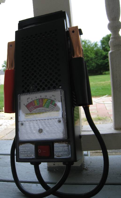

You can’t with a battery beak you need a load tester.
A load tester is the best item to see how a battery can respond to the load that it will see in a match.

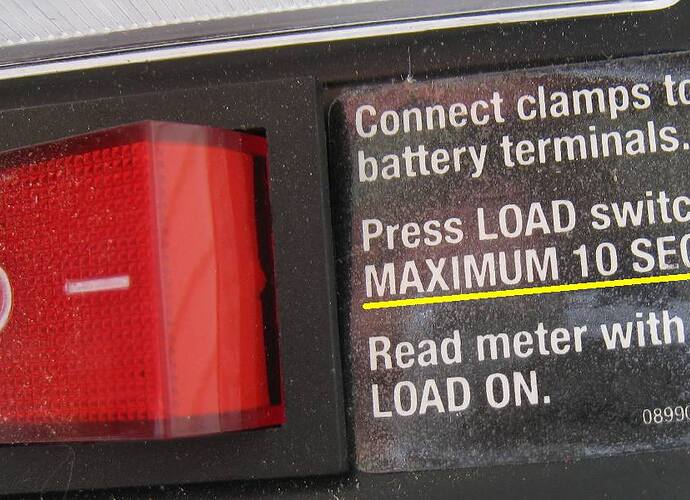

The typical automotive load tester will put a 100 or 125 amp load on the battery for as long as you hold the “test” button.
Or for 15 seconds, whichever comes first1 :slight_smile: They get very hot after that.
1most of the inexpensive ones I have seen warn you not to hold the button more than 10 or 15 seconds

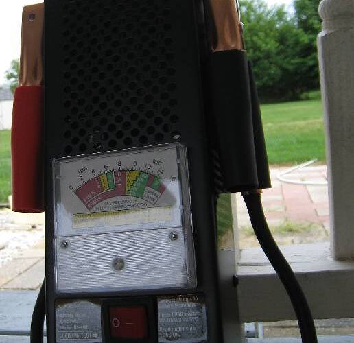

Battery Testers of this type http://www.mcmaster.com/#battery-testers/=o19fra use high current loads, 60 and 125 amps or simply 125 amps and produces a meter deflection to show good or bad. A car battery (.003 ohm) has an internal resistance typically 1/4 of our battery (.011 ohm) so this tester will not give you a good idea of the state of the smaller battery. I cringe at teams that use this battery tester as it will continue to load the battery as long as the switch is held “on” which under certain conditions can damage the battery.

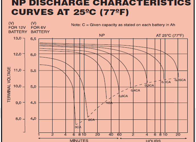

*Attached is a graph of the discharge curves at 77F for the Yuasa NP18-12B battery, taken from the Yuasa datasheet for the battery.
That battery is rated at 17.2 AH. So the 0.2 CA discharge curve would correspond to roughly 3.4 amps discharge rate. According to that curve, the battery voltage should remain above 11.5 volts at that discharge rate for 2 hours. That corresponds to roughly 6.8 AH discharged.

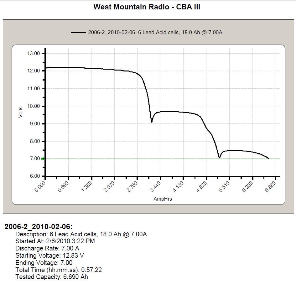

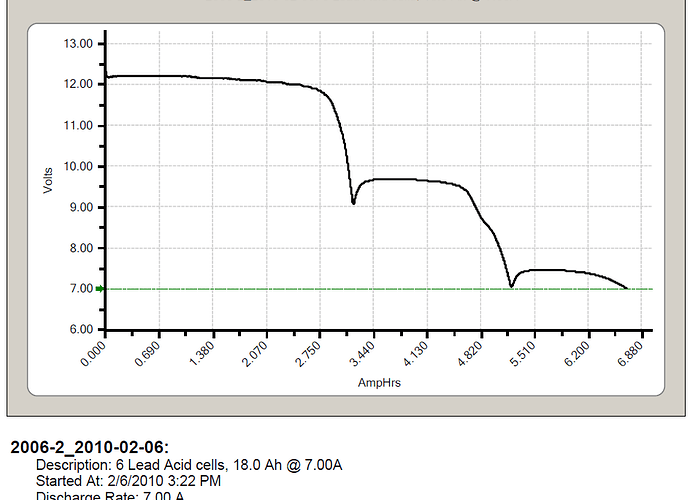

Now take a look at this CBAIII curve for a battery with a weak cell1. Note the sudden drop-off in voltage at about 3.2 AH into the test, caused by a weak cell.
125 amps for 15 seconds is only 0.5 AH, so it’s not obvious that such a test would identify the bad cell. In fact, I have a lawn tractor battery with a bad cell that passes the 125A test when freshly charged.

BTW, the lawn tractor battery mentioned above (which passes the 125A test) fails the 2 hour test.
