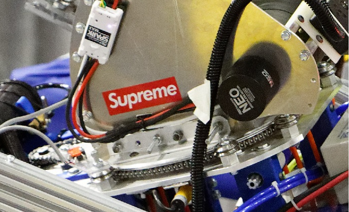

This was our first year to utilize a turret, but we went in a different direction. Rather than use a “bearing stack”, we opted for V-groove bearings (REV has them, as does amazon) and a bevelled carrier plate (to match the groove in the bearings). The fixed (base) plate was then drilled with 8 equi-distant mounting holes and we used a combination of concentric and eccentric bearing spacers (also at REV) to mount the bearings. The carrier plate - with sprocket - then slips inside the grooves of the bearings. The eccentric spacers allow us to fine-tune the plate for minimal “slop”, and side loading isn’t a concern. The sprocket is offset on the underside of the carrier plate, driven with #25 chain. Powered by an old andymark 9015 (550 equivalent, IIRC) mated to a versaplanetary with internal encoder, we control it with a talon srx (using limits, it’s quick) and it runs as smooth as glass. All plates are 1/8" aluminum, sprocket and carrier plate were the only machined parts, everything else was COTS. Part of our reasoning here is to keep the pass-thru hole “clean”, so nothing interferes with the ball as it’s passed to our shooter. Wish I had some good pics for illustrative purposes :frowning:
Edit: Base plate is 1/4" - we made one out of 1/8" but made weight so we didn’t use it. Also, the black plastic conduit in the pic is part of our lift system and is only beside the turret when we’re climbing.

Thats a cool approach for supporting the carrier plate. How did you bevel that carrier plate to fit exactly in the V-groove of the bearings?
We did this in 2019 as well. All we did was use our router with a chamfer bit to create plates with half the V and bolted 2 of those plates together.
You can find a few pics of the setup here.

I can’t honestly answer that, I’ll have to ask our machinist mentor. He did the sprocket and carrier plate at the same time, borrowed the use of a CNC from a friend of his, and spent several hours there one saturday. Turned out great tho!
Agreed. 3476 did an awesome job, I really like the way it’s driven, that’s pretty cool. We toyed with stacked bearings in the shop, but because we’ve got experience with the REV lift kit, we decided to try the v-groove/chamfered plate route, and it came out better than anticipated. Not only do we have a simple way to fine-tune the turret, it’s also super smooth. Programmed to center the forward mounted Limelight on the target, the turret performed flawlessly in the 17 matches we were lucky enough to have played. ~sigh~ I’m gonna miss those competitions this year :frowning_face:
