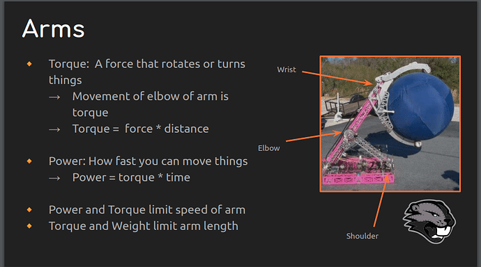

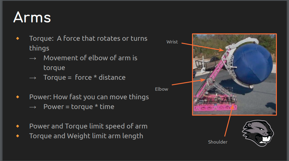

These all look super useful! I found a minor issue with one of the slides for mechanisms –
Mechanical power is defined by the torque * the angular velocity, not torque * time
Thanks! Didn’t catch that detail. We’ll make sure to fix it to avoid confusion!
