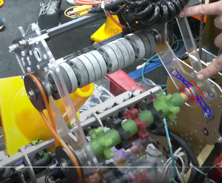

From the FUN video can you give some pictures of the back to back bearings on your intake? I am always looking for different bearing options for intakes.
I didn’t find any good pictures on my phone, but i’ll try to explain the best i can from the video itself.
Basically we have 2 external bearings going through the plates with the shoulder facing outwards, like most teams do. The other bearings are mounted inside the intake with the shoulder facing the plate itself like in this image:
The plate is blue, and bearings are red. the plate is 5mm thick and the bearing OD is 1/4" long, so the plate can move about 1.35mm between the bearings shoulders.
The internal ring of the bearing is of course free to spin, and only the shoulder/bearing OD is touching the plate at any time.
This results in a very robust spinning axle, while not affecting the flexibility of the polycarb and not requiring any holes to clamp the bearing to the plate (only the shaft is tapped, and closed at the ends with end screws).
Hope this was clear, if not we’ll try again after we get our robot in ~2 months :wink:
