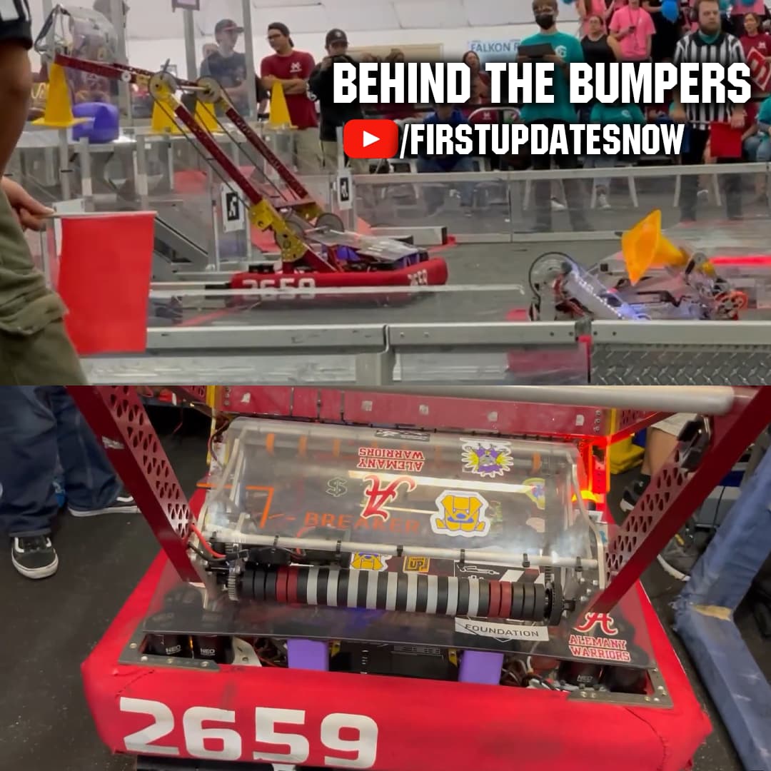

https://youtu.be/7zbPI8nFeFc 2659 RoboWarriors had an impressive season with a Regional Win and being alliance captains on the Daly Division at champs. 12 motor swerve along with a great arm and delivery system and details of their controls make this robot a complete package.
