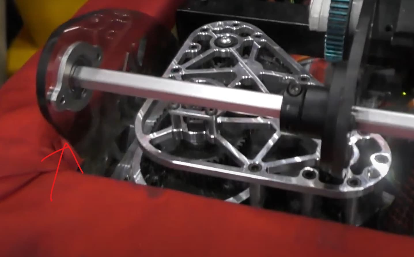

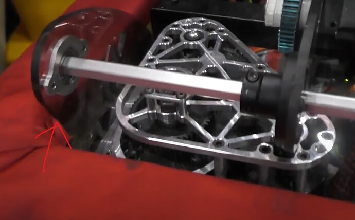

I am a little confused with how this polycarb is mounted, and also the legality of it. I thought that only static things could be on the frame perimiter (the bearing and shaft I mean), are “spectrum corners” used here?

From the little research I just did on spectrum corners yes it is in an essence the same thing but its not for all four sides of the robot just the two long sides. Technically that piece of 1/4" polycarb is our “frame” which allowed us to mount our cube pickup in the same fashion.
