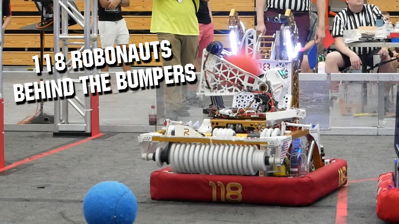

Thanks Tyler for coming by and interviewing us! Sumi, Jackie, Jack, and Jonathan did a great job going over the most important bits in (what feels like) such a short interview.
I thought I’d add in a couple of the most common questions we came across at tournaments this season:
Why is the intake so big and bulky?
Big: that’s how the packaging worked out once we found the benefits of a large wheel diameter. There simply wasn’t space to stow the intake in front of the shooter, so we had to stow it above and one-way deploy it over the shooter. This pushed the pivot point backward, and necessitated the long box tube arms. They are 1x1.5x0.125 aluminum box tubes. Bulky: we expected to be running quick cycles under defense and wanted to be able to survive hits from other robots and collisions with field elements without worrying about breaking or over-flexing a floppy intake. Having seen how our robot architecture turned out and how G204 was enforced, we may reconsider this philosophy in the future. We like rigid intakes from a reliability perspective, but the excessive length of these arms led to some bending after long practices and especially hard hits with the lower exits and hangar trusses. Shorter arms would have held up better, had we found a nice way to package them in the length of the robot. We often brought an entire spare intake to replace at competition.
Why SDS mk4 instead of mk4i?
We had both on hand and went for the lighter ones that were easier to swap, since it would be our first competition swerve drive to share the field with other robots in 13 years. We used mk3s successfully for the 2021 at-home challenges so we were familiar with the assembly and maintenance required. We brought 4 complete assembled modules to competitions, with CAN IDs already assigned and connectors set up for quick replacement of entire modules at the first sign of any trouble. After the only problems we saw were the main plates bending upward over time, and that not being an issue with the mk4is, we will likely move to those style of modules in the future.
Why 3 Falcon 500s for the climb?
We counted up the motors on the rest of the mechanisms, maybe around build week 3, and found there were 4 remaining once other subsystems were accounted for. Climb took 3 and left one to solve problems. We ended up using that last PDH slot for a Neo 550 to replace the lackluster pneumatic climb deploy we started out with. You don’t need 3 falcons to climb quickly. We geared rather aggressively, intending to briefly max-out current draw through the main breaker as well as individual breakers in the PDH, but ended up mostly running at lower speeds to keep the routine smooth and controllable. The climb worked nominally with 1/3 motors disconnected, which was our backup plan as went though a weigh-loss program leading up to nearly every tournament of the season.
Triple traversal? (Okay, maybe I just want to talk about this one as the lead mentor for our climber)
We built the upper structure and shooter head narrow such that Horizon takes up less than 14" of the traversal rung. We were stoked to finally get the opportunity to show this off at IRI thanks to 4499, 624, and 1987. End game points are essentially independent of your opponents, so we strived to maximize them. We can’t honestly say we expected every 3rd robot candidate at champs to be able to climb to the traversal (maybe a whoopsie for Everybot, but c’mon man…), but we’re glad we put some resources into being narrow. The Einstein round robin tie-breaker being hangar points made it almost silly not to plan for the possibility of getting a 3rd partner that could climb to the traversal.
