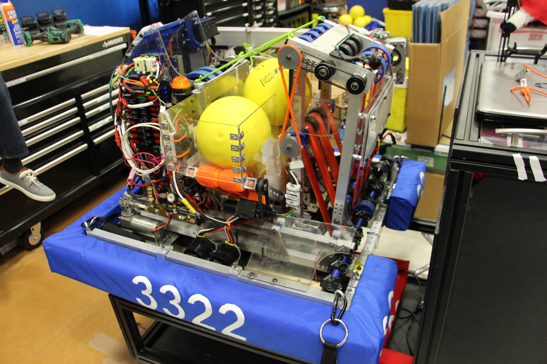

If teams aren’t placing their spark maxes on the belly pan, where do they put them? It just seems strange to me that I rarely see motor controllers on mechanisms of other robots when ours are always littered with electronics. Should I put the spark maxes near the motors or is it okay to wire them off to the belly pan?
I see spark maxes sprinkled all around robots often, it’s definetly preferred to not use any extensions. An important consideration is to protect the can bus.
Our 2020 robot doesn’t have a belly pan but it is a fun game of spot the motor controller.
My rule of thumb is generally if a motor requires an extra sensor, is far from the drive base, and is protected enough, keep that motor controller near the motor. Here are a few examples I quickly found of motor controllers not on the belly pan of robots
Thanks! I realize now that I just haven’t been looking hard enough. Those teams hide their motor drivers way better than mine.
Spreading the motor controllers around the robot can improve the serviceability of the control system if done in the right way. Imagine trying to work on or trying to troubleshoot a control system mounted on a bellypan with large mechanisms installed above it.
Sometimes the right answer is to mount the control system on vertical panels above the top of the bumpers. Of course, protective panels would be installed if required. My memory is not the best but I don’t recall seeing many robots with bellypans in 2015 due to the physical configurations that many teams chose.
