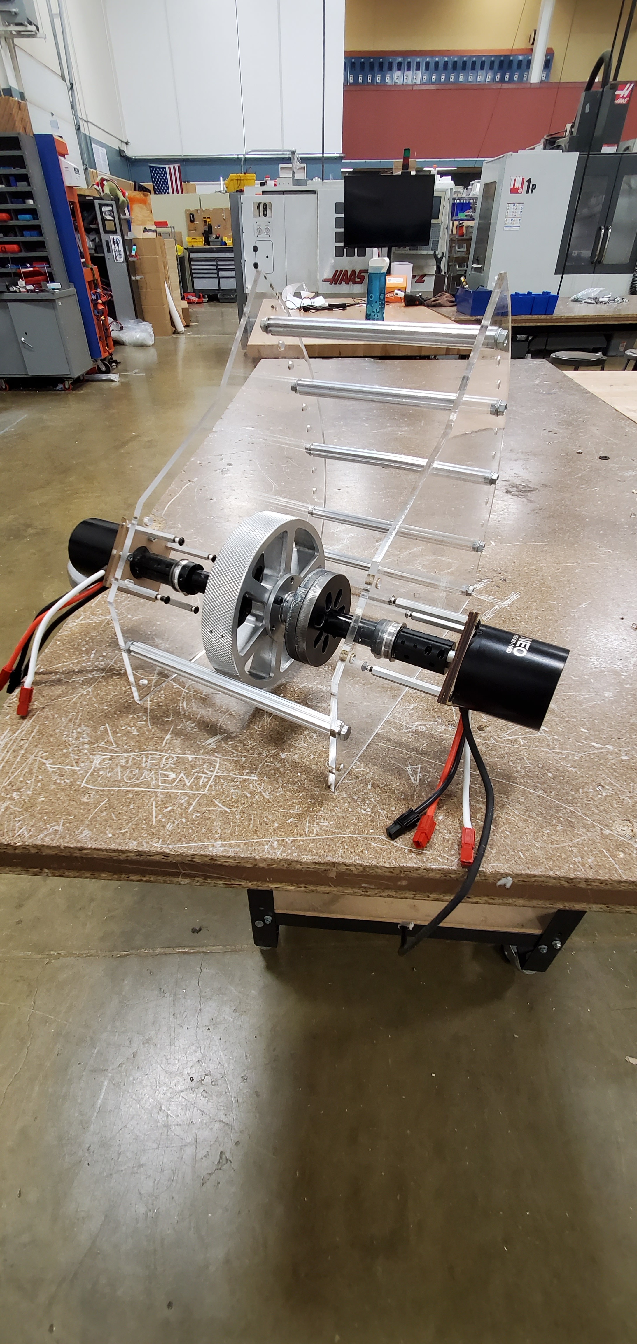

Hi, our team is working on a hooded shooter design and are currently using the 6" white plaction wheels but they are horribly unbalanced and we do not believe they are meant for high-speed operations like this. Are there any wheels or rollers that teams have found to work well at this size for shooting? Thank you!
We had good luck with dual colsons in testing and likely production
My team is using 4 inch stealth wheels, I believe that the 6 inch variety (assuming there is one, idk) should work the same.
Alas, Stealth wheels are only in 2” and 4” variety
Our 6 in white high grip AM wheels work well. We are using 2.
We’re going with 4” wheels but if we were going with 6” I’d consider getting Fairlane wheels with a 1 1/8” opening and glue it/press fit hubs in them.
We are using three 6" colsons wheels
Our team is using 2 of these performance wheels (https://www.andymark.com/products/6-in-performance-wheel-xl-0-50-in-hex-bore) because they were able to achieve a inertia that we were looking for. We are slipping on a timing belt over them as the friction material, which is not common, but is a cheap and equal replacement for the tread.
We used an old performance wheel as a prototype and it’s working pretty well.
