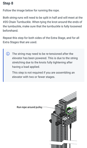

Do you know what type of knot you were trying? While we didn’t use the greyt elevator for 2023, we copied many of it’s design elements including the same tensioning system (same rope pulleys and ratcheting hex shaft with hole drilled into it).
Browsing through the documentation I see that it just says “tie a knot” without any indication of what kind of knot should work in this application, which is pretty important:
The FRC rule of thumb and what we’ve used on all of our elevators is a bowline knot. I spend a good 30mins to an hour every build season when it’s a lifting game walking a few students through tying bowline knots correctly precisely to avoid the issues you’ve described.
I wonder if it would be a good idea to update the documentation @R.C to be a bit more specific/link a guide/video on knot tying. Just an idea.

Good suggestion,
We’ll do that and all elevators are moving to the ratchet plate tensioners. This will help teams that struggle with tying knots to the right length.

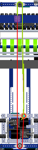

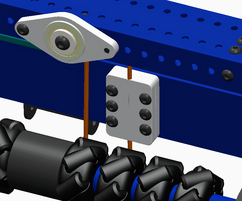

This is a rope installation guide I wrote for 3512 for getting our 2023 elevator tensioned:
  1. Starting at carriage, tie a bowline knot in the dyneema (red) and hook that around the hex shaft (blue). Loop dyneema around bottom 1st stage pulley and up to clamping blocks (purple) on 0 Stage.
  2. Run dyneema (green) from clamping blocks up to top 1st stage pulley and down to carriage. Thread dyneema through hole in hex shaft. Tie a knot in the end so it can’t back through the hex shaft hole.
    • We found the best way to thread the dyneema into the hole was to cut it at a very shallow angle and then melt with a flame and then finally pull through with some needle nose pliers. A thin scribe or Allen key can also help stuff into the hole initially.
  3. Ratchet (orange) the hex shaft to tension the dyneema.
  4. Clamp Dyneema with clamping block (purple).
  5. Ratchet hex shaft as needed whenever Dyneema loosens up.

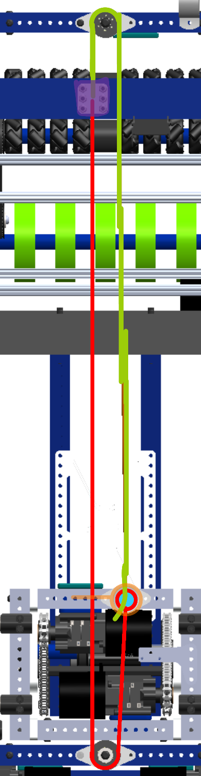

Here’s a colored diagram and some close up pics of the clamping blocks and carriage hex shaft w/ hole:

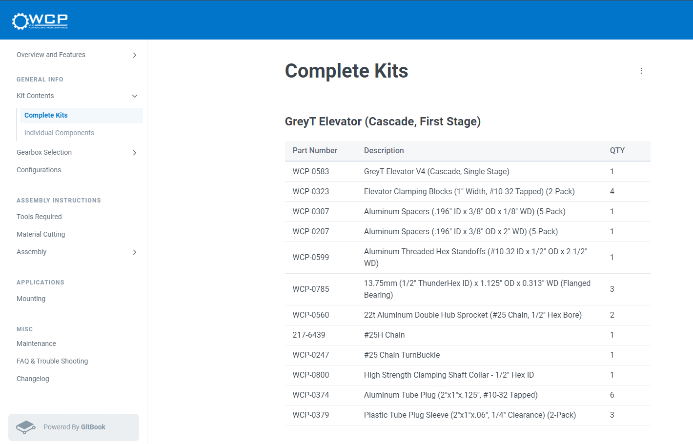

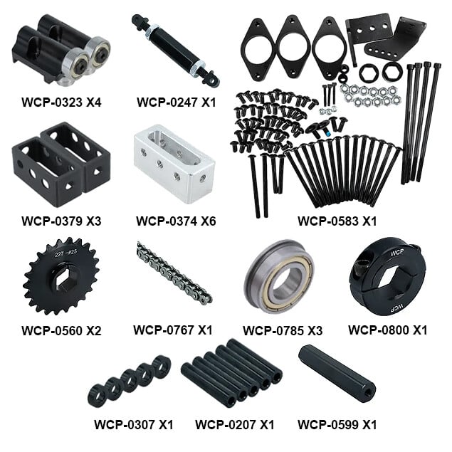

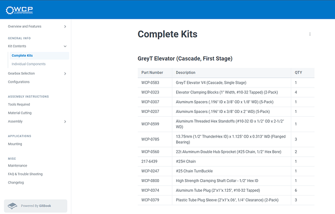

One thing to keep in mind with WCP kits, is to ensure you’ve ordered EVERYTHING that you need for it.
WCP lists a majority of their kits by individual parts, and leaves it to the customer to ensure they’ve added everything they need to their cart. I’m told it’s to allow teams with a large inventory of existing parts to be able to order only what they need, but I find it generally rather confusing/frustrating.
We’ve ordered multiple kits from them over the years, and each time we’ve ended up missing critical parts from the kit (that had to be ordered separately); Something that can be a rather big problem in the middle of a chaotic build season. Often times I’ve found mention of what’s needed to be ordered, but buried in a 50+ page manual (and not listed on the product page).
Because of these ordering issues, we’ve actually *sworn off buying kits from WCP. Things may have improved over the last couple years, but this has been our experience, your mileage may vary :woman_shrugging:.
*We still happily place orders for some of the amazing individual components offered by WCP, just had too many issues with the kits to rely on them in season anymore.
Brian,
Thanks for your honest feedback. We’ve gotten similar feedback over the years and have attempted to fix it/make it better. Fast forward to now… This is we are doing:
  1. Each page assembly will have an option of complete kit or individual parts. Previously we had broken down each item and left it to the user to select qty’s etc… This led to poor results.
  1. Each Kit will have pictures of what comes with it
  1. User guides are now web based and kit contents are on the forefront
  1. We also include a kit contents layout BOM now as well:
  1. We spent most of the summer making sure each individual part had a unique picture. This includes gears, sprockets and other parts that look the same. This was quite a bit of work, but now that we are done with that we are moving onto other improvements which consists of:
  • All assembly web pages getting the same information and easier ordering
  • Preselected assemblies/bundles for 1 click ordering. These will be created as “Bundles”
  • All manuals and information moving to gitbooks. This is ongoing and we hope to finish before the end of the season. We are adding more and more information weekly.
  • Gutting and improving all assemblies. Making sure we include all necessary items to build something functional.
