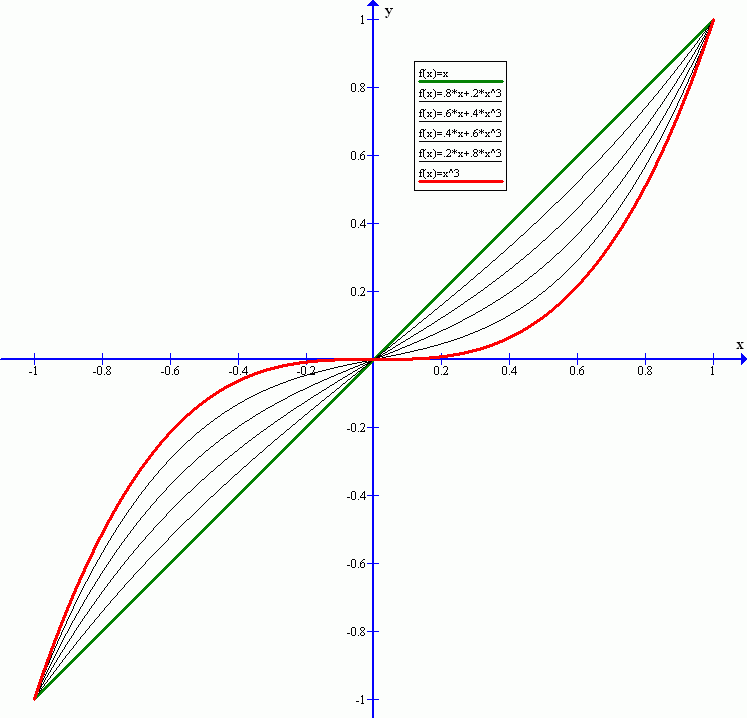

While drive inputs may or may not be the solution to your problem here (I’m guessing that they’re not), drive inputs being adjusted by a function other than y=x is still something that can help immensely, if tuned to your driver’s preferences. I’ll try and help to explain as best as I can with only an Algebra background.
Below is a graph I whipped up in Desmos, showing 5 example functions that you can multiply your input (x), by to get your output (y). This can quickly and easily change the characteristics of how your mechanism responds to inputs, especially when paired with a clamp() or “deadband.”
The important things to note on the graph are how the y changes in regards to x (output in regards to input, slope). For my go-to drive function, y=x^2, the output at 0.5 (50%) input ends up being 0.25 (25%). This is my happy medium for less sensitive control, but YMMV. The only use in my experience for an exponent <1 is to make a prototype shooter wheel spin up faster, but I’m sure there are others.

Another good one is (1-a)x³ + ax. It lets you select your slope at zero (a), but gets you to full throttle at full joystick. See @Ether’s classic white paper for more details.
