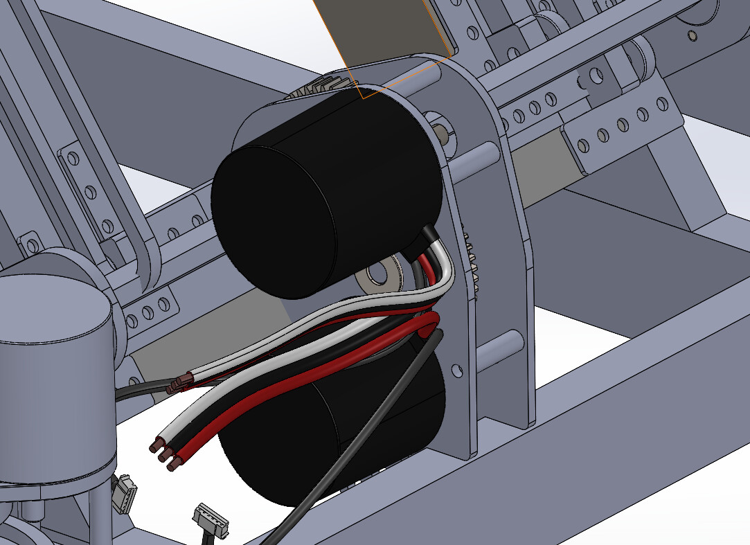

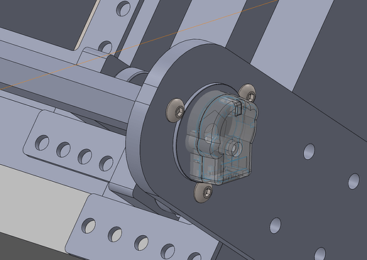

We are planing to use cancoder for our elevator in offseason but we dont have any encoder to use. We also buy some off these encoder but which encoder is best for Elevator. We might to buy REV Bore Encoder or another magnetic encoder.

Firstly our whole budget is $100 not the sensor budget. We are using two Neos with 9.1 ratio with 2 stage.

The mag encoder you show in your model won’t work as shown because you can’t mount it to a bearing. It doesn’t mean that you can’t devise a mount that straddles the bearing. There might even be a mount you can buy. You would also need to bore an axial hole in your hex shaft to mount the magnet. Easy if you have a lathe. Not so easy if you don’t.
The Rev Through-bore encoder was designed for an application just like this. it’s available, at least in the USA.

The mag encder is just a example in photo.

You really should just use the built in encoder on the neo. it’s far easier and has less failure points and assembles faster. it also allows you to use the onboard pid control of the spark max.

The encoders in your NEOs are going to be very reliable. Brushless motors rely on the electronic shaft position data to operate. If the encoder is not working, the motor is not running.
The gearbox behind the motor is not a problem as long as you aren’t breaking and skipping teeth in the gearbox. There is a direct relationship between the motor shaft and the gearbox output shaft. You’d be relying on the same kind of direct relationship between the hex shaft rotations and the elevator height. There is a much greater chance of skipping teeth on the chain or belt drive of your elevator than there is of skipping gear teeth in the gearbox.
