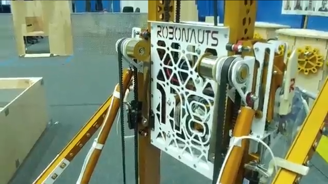

I’ve seen teams put a solid bar though the center of the number/letter to prevent cutouts. Like the O’s in Robonauts -

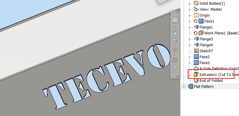

Look for a stencil font. Or you can manually draw in webbing in almost any font. A stencil just has it done for you.

I would recommend finding a font you like that has a decently large stroke size. Then fixing it manually by adding supports for floating pieces and filleting sharp corners. You will get a much better selection of good font options.
edit: the parts in question
