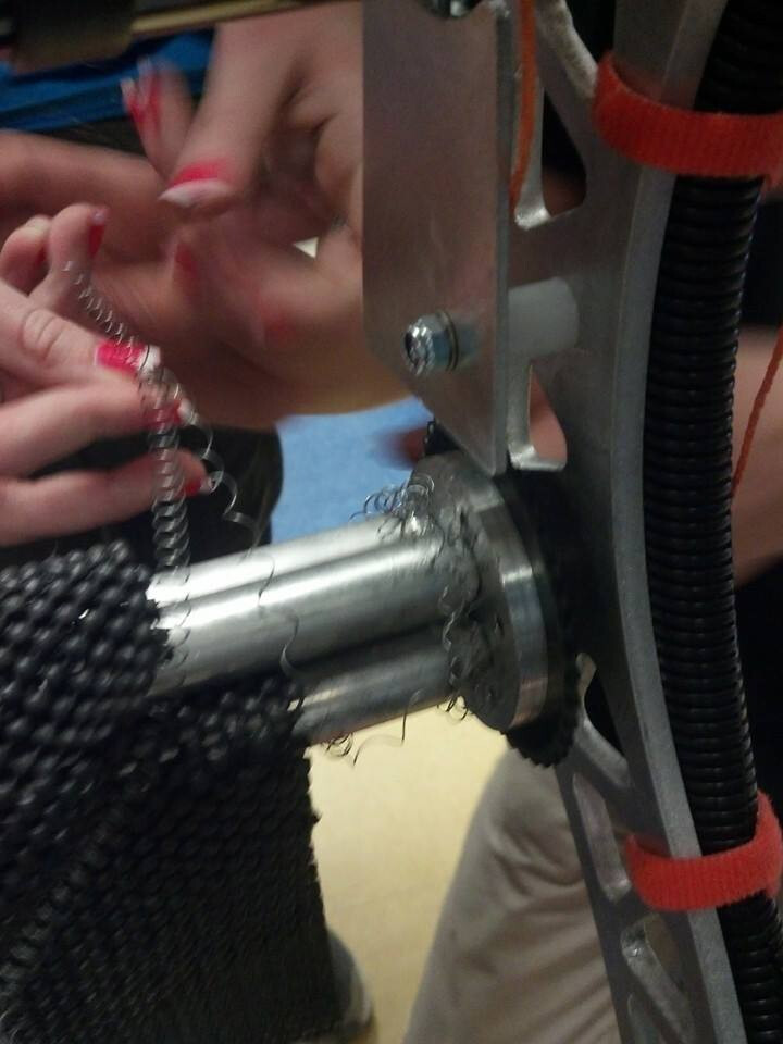

  • Even this wild contraption, in two different years (it worked after finding and eating a spring on the field)
