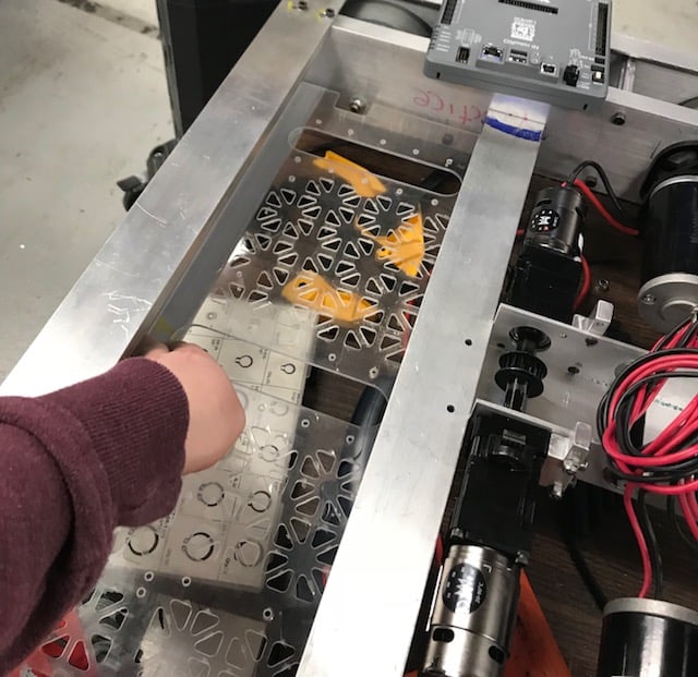

This is the first example I found, from back when we were alpha testing the new RoboRio control system on our 2013 robot (They didn’t even have a case for the RoboRio or PDP, just the bare board with connectors!). The older cRio control system we competed with that year was set up the same way. You’ll notice the service loop in this picture - everything goes from the electrical board to the rest of the robot through a path that runs it near the hinge - no stress on the wires when the board is lowered.

For the past two years we’ve mounted most* of our electronics upside down underneath the robot. This way we can tip our robot on it’s side and get access to everything.
*We ran out of room this year for everything under the robot so we ended up mounting to the top of the bottom panel as well.
We like this approach, though it’s been flat fields the past two years. Terrain games will likely have us mounting upside up in the belly pan.
