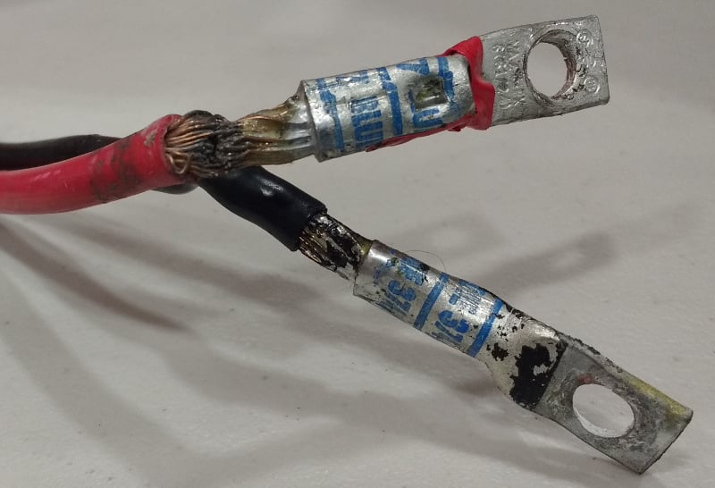

In being a robot inspector this year, I would also note that I saw quite a few batteries with loose connectors or bad crimps on the SB-50 Power Pole connectors on the battery side. The lugs are not easily crimped because of the AWG 6 wire and the size of the connector. Yesterday I went to Harbor Freight and purchased a new hydraulic wire crimper (Model 66150) that I plan to try with our team later this week. Once crimped, I plan on soldering them as well to provide an optimal connection. Though it may be overkill, I think that it may be worth the extra few minutes of time.
I had also noticed that we had issues with some of the terminals corroding on last years batteries. With the battery terminals taped, it’s hard to see the health of these connections. Most of the corrosion was found using the hardware that we received when we bought the batteries. We now use 10-32 hex head screws on all of these connections and it allows for better tightening. We also use star washers to provide a better connection.

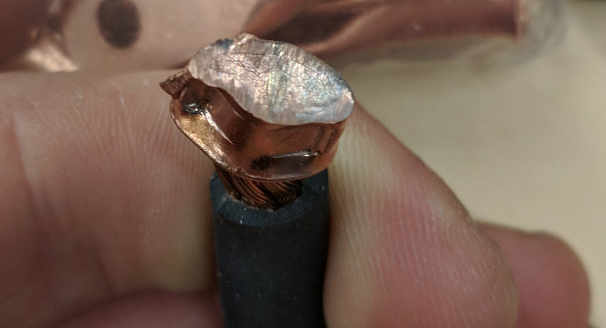

Forgive me if I’m wrong, but doesn’t soldering crimped connections stiffen them to the point where they are more likely to break after repeated bending and fatigue? I think it is mentioned it in this thread:
We bought one this season, it’s excellent.
Do make sure the release valve is fully seated, to get full compression on the crimp.
Don’t be afraid to file off the flashing (flanges) to help it fit into the SB50 connectors better.
Do section the first contact you crimp on a bandsaw. It should look like a solid block of copper. If it’s not, your release valve isn’t fully closed, you don’t have the right jaw, or you need to exchange the tool (happens sometimes at harbor freight).
Don’t worry about soldering afterwards, with a hydraulic tool there are no voids left for solder to fill:
The issue is that the solder wicks up into the wire causing that section of the wire to be very stiff. When the wire is flexed, the strands are bent sharply where the solder ends causing them to fatigue and break. Sometimes, this leads to an intermitent connection that will drive you crazy because the break is not right at the crimp lug but up to an inch away. With smaller wire sizes, I have been able to pull on the wire and cause the two sections of wire to totally separate.
The 6AWG wire will conduct heat away from the lug if you try to solder it. It will be very difficult to get a good solder joint with most irons.
I agree with philso that any time you have braided wire, wicking action takes place. As you solder, it will follow the wire up past the connector and into the pigtail and that’s where problems with bending and breaking occur. There are 2 things that I like to insure when putting the connectors on.
  1. When stripping the insulation back from the wire, measure accurately. Make sure that the insulation hits the top of the connector and also make sure that there isn’t a bunch of wire that protrudes from the bottom or connection side which can interfere with the lug being tightly attached to the battery.
  2. If you do solder the connection, don’t over solder.
I try to solder the very tip of the connector near the ring so that it just attaches the wire to the connector. This assures a good connection and also seals the end of copper wire. I’ve found that there is a lesser chance that the connector will corrode. Too much solder at this connection again will wick up into the wire and give a greater chance of becoming brittle or break as indicated in Al’s annual inspection thread.
As philso indicates, it is very difficult to get this heated because of the shear mass of the connector with the wire attached. I have a larger soldering gun, and as an alternative, have also attached a soldering tip attached to a propane torch which I find works the best. Again, less solder is better than more. We also try to use heat shrink to strengthen the connector and then always insulate the connection of the battery with either heat shrink or tape after connecting it to the battery. (R45)
