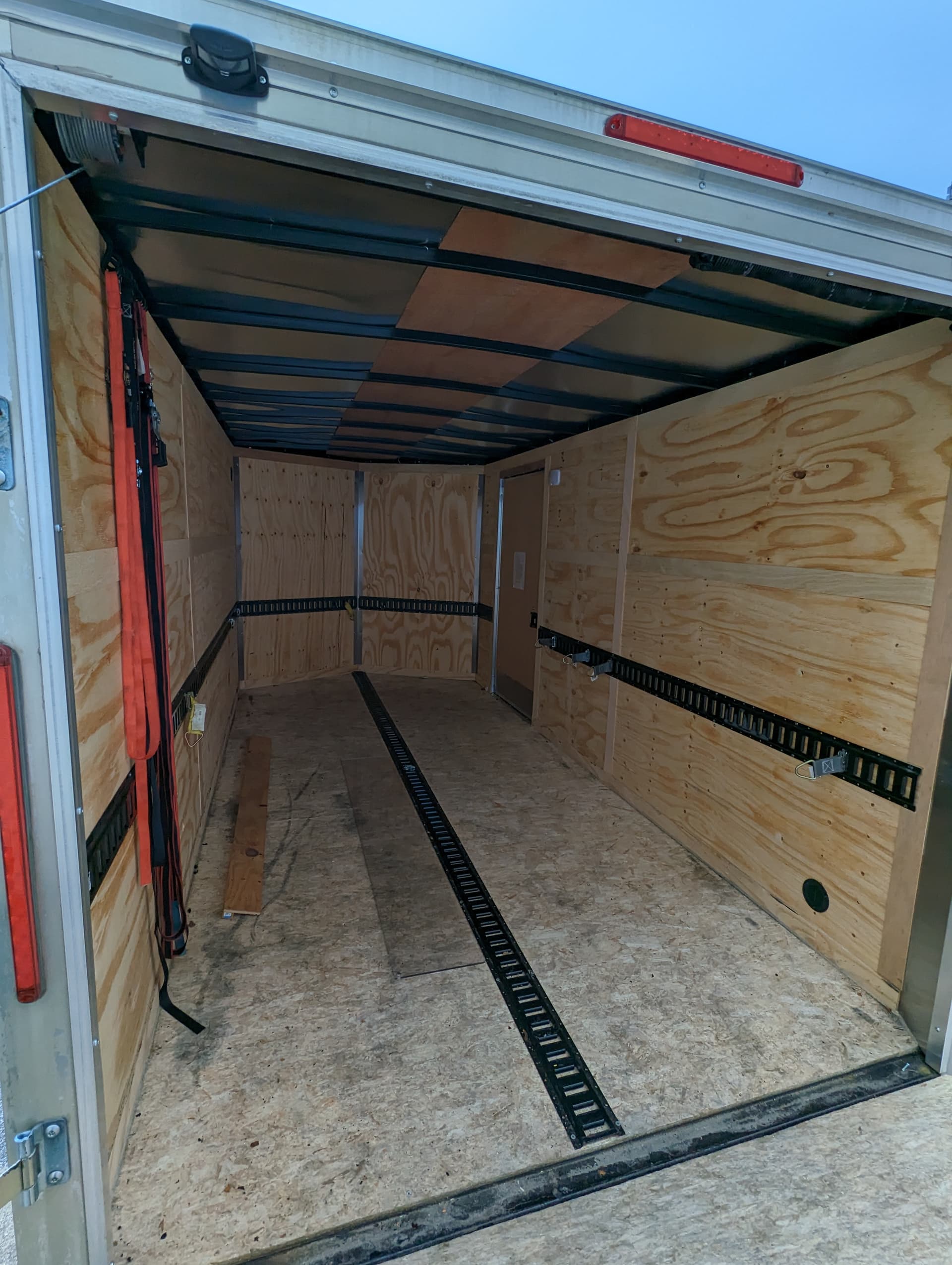

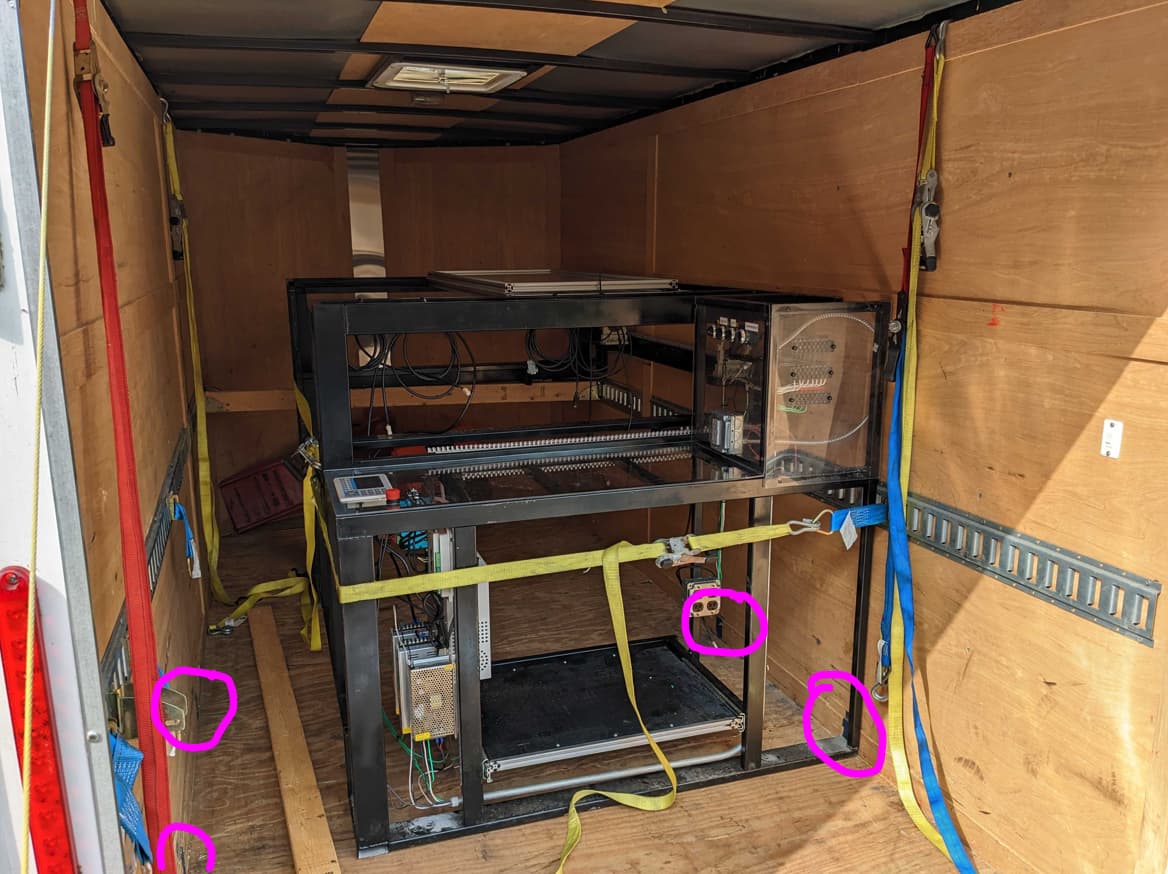

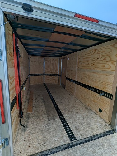

I’d suggest running E-track rails at both the bottom and halfway up the trailer walls for its entire length. That gives you tons of flexibility for tie-down locations, since the E-track rings can be placed wherever the load is. You can also get E-track hangers for 2x4s that allow them to act as load bars - this is helpful for a bit of extra security to prevent heavy items from moving around (especially if they are on wheels). Other accessories are also available that can interface with them.
4039 has been running with this configuration in our trailer since 2014 and it has served us well.

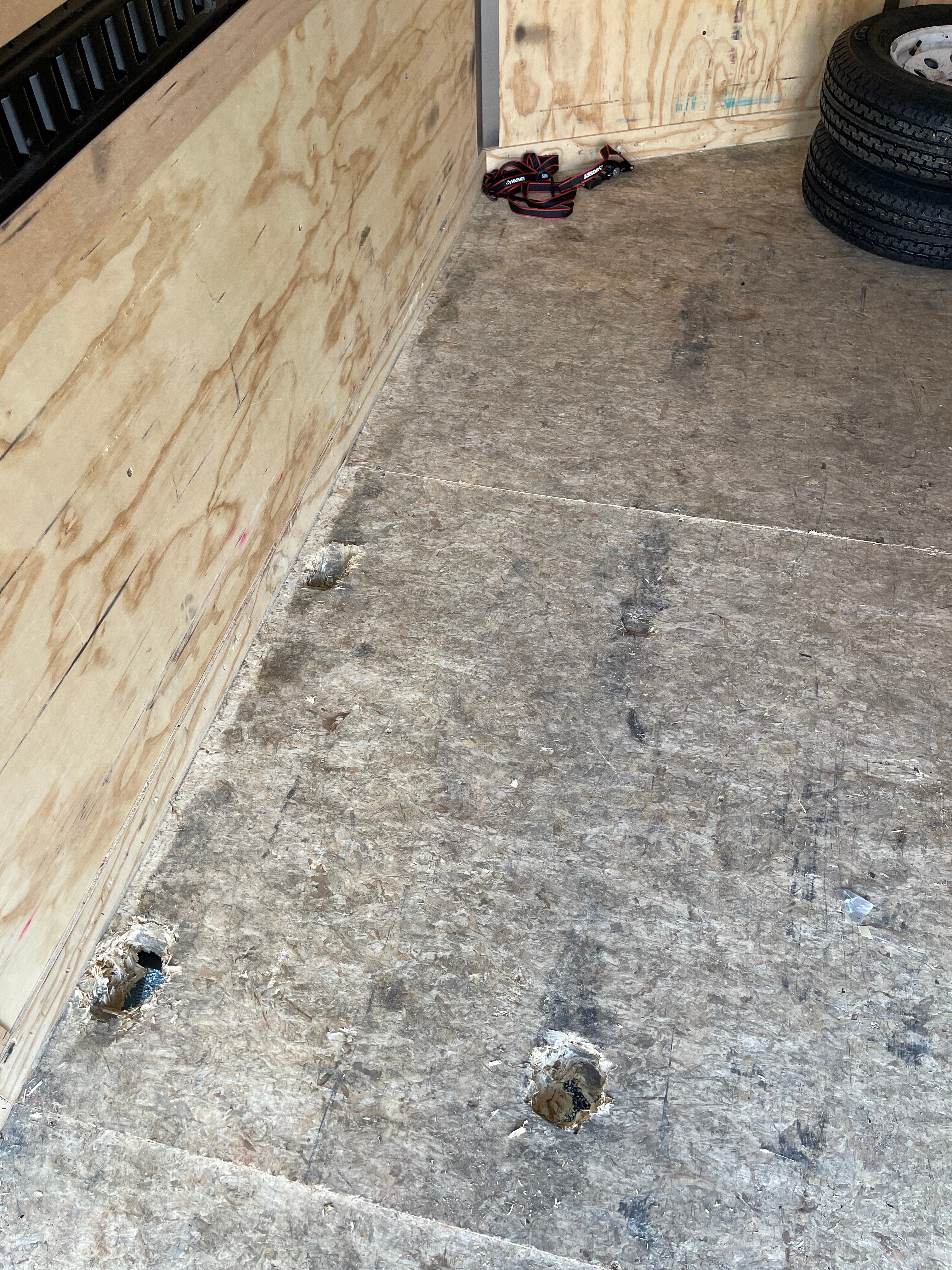

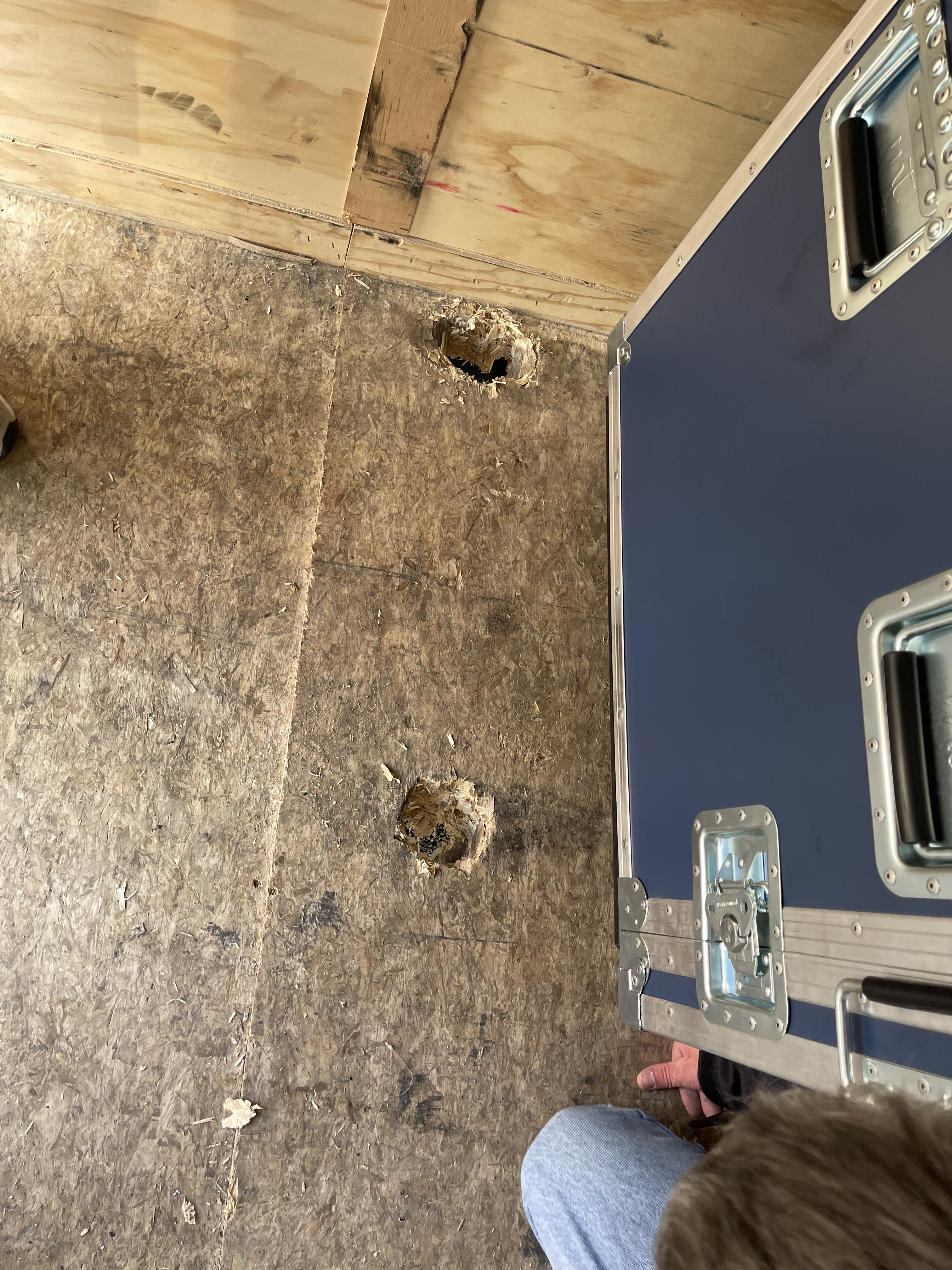

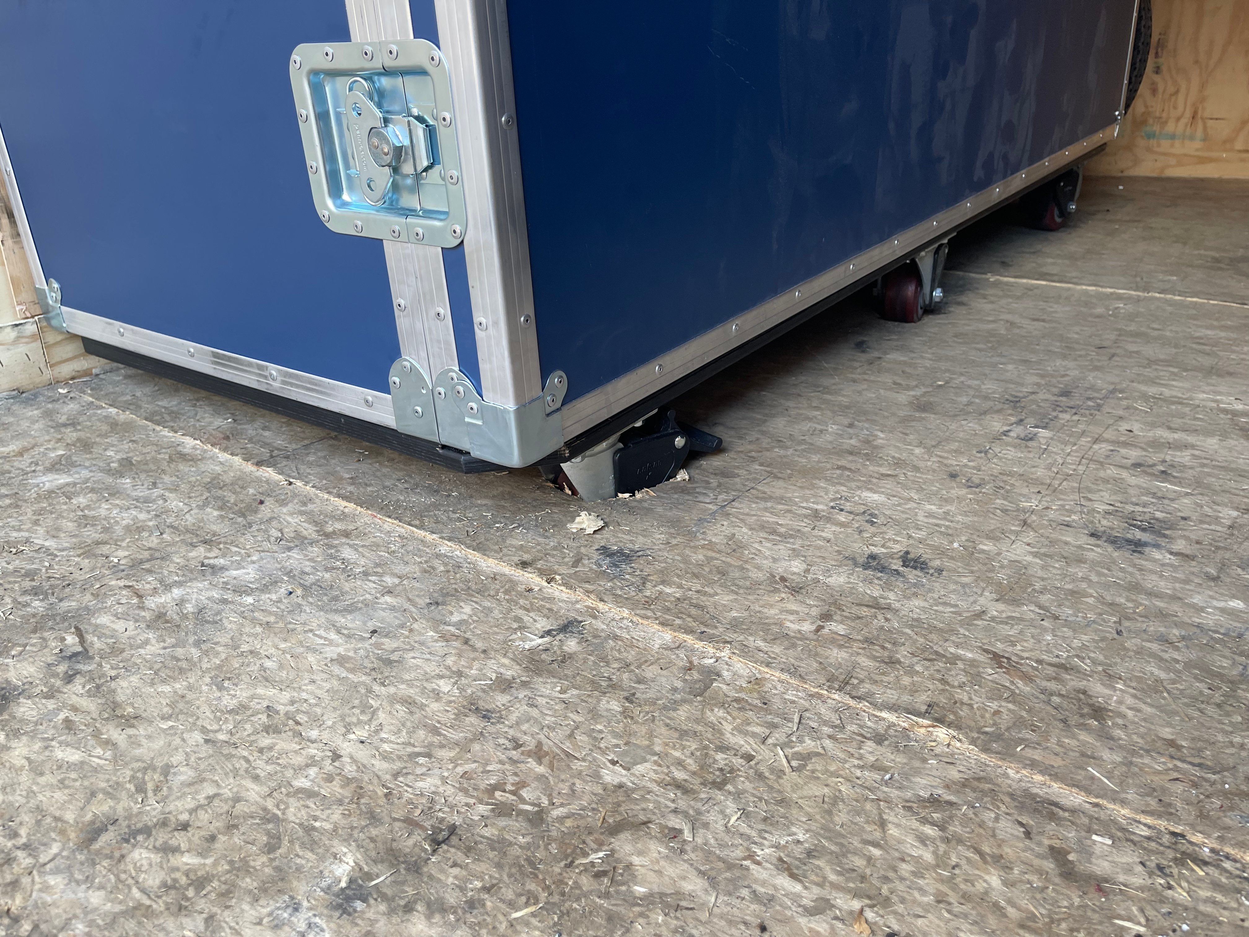

Consider thin steel on top of the plywood on the floor to keep a super pit from going through the floor. that said, ours hasn’t.
Arkansas roads are terrible.
Friends don’t let friends make things out of OSB
Brushless swerve is a real menace! Just look at the damage! Clean through the hardboard.
This is now 3/4" birch with diamond plate at the caster locations.

We also mark the exact layout of where each pit box should be, and where each strap should go to the e-track to secure said boxes, so loading the trailer up with four heavy road cases is consistent across various generations of students. Loading the cases up properly is important, especially to ensure nothing moves in-transit and the load distribution is acceptable.

E track on the floor is a wonderful addition. Two runs might be even better.

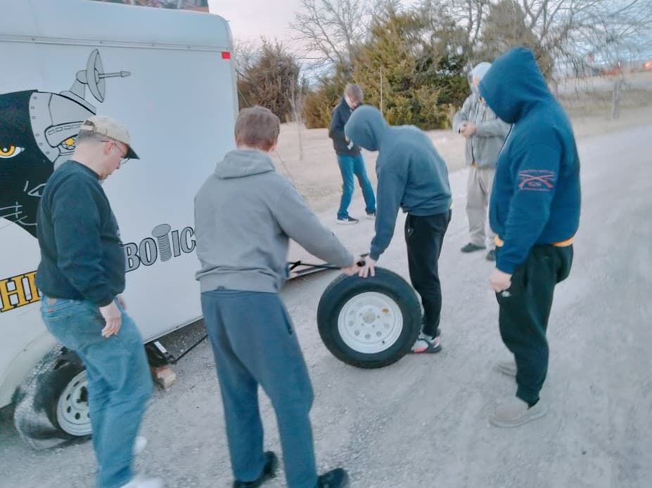

You don’t say.
We upgraded tires after this.
Also, make sure the fender light tapping screws don’t go in to deep. Think it was a bump and a screw that shredded this on the way to Oklahoma (last 15 minutes of 5+ hr drive). This side has the toolbox so it is the heavier side, so it probably sagged down a bit more.
And we’ve prior to that replaced leaf springs to heavier ones.
Altogether it was good team bonding as our students showed that they could successfully change a tire while the mentors stood back and watched, which was a proud moment last year.
