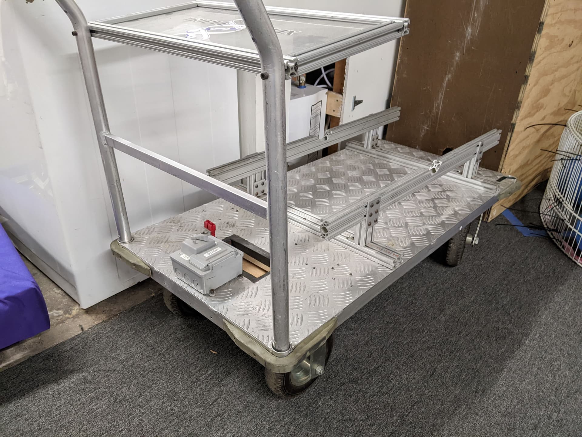

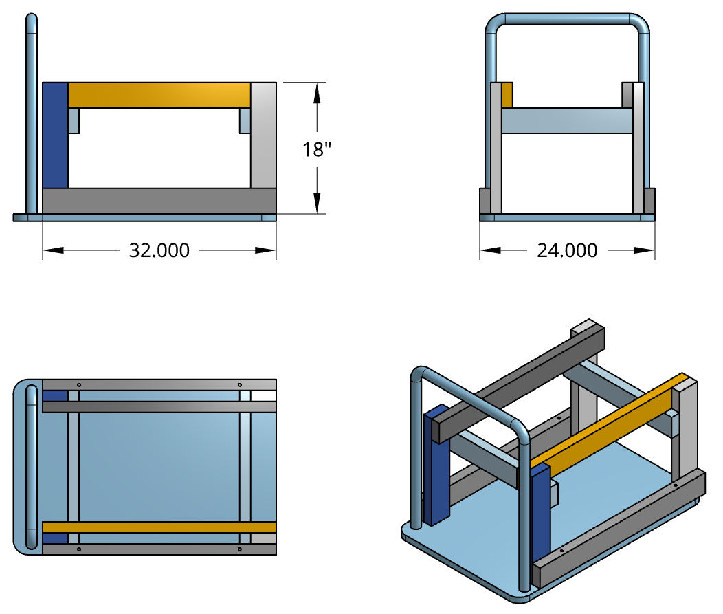

We don’t have CAD to share sorry - it was kind of just built to sketch. The base is a 2’ x 4’ rectangle made of 2x1 aluminum tubing, joined with riveted gussets. The top of the tubing has a plywood deck. Additional plates are used to hold the casters and the handle (which is bent muffler tube). There’s an 80-20 extrusion “pedestal” on top of the plywood, which is there to elevate the robot a bit and give a place to store the bumpers, but we often tweak the pedestal to suit the robot.
Here’s a recent photo. Sorry it’s not a close-up.

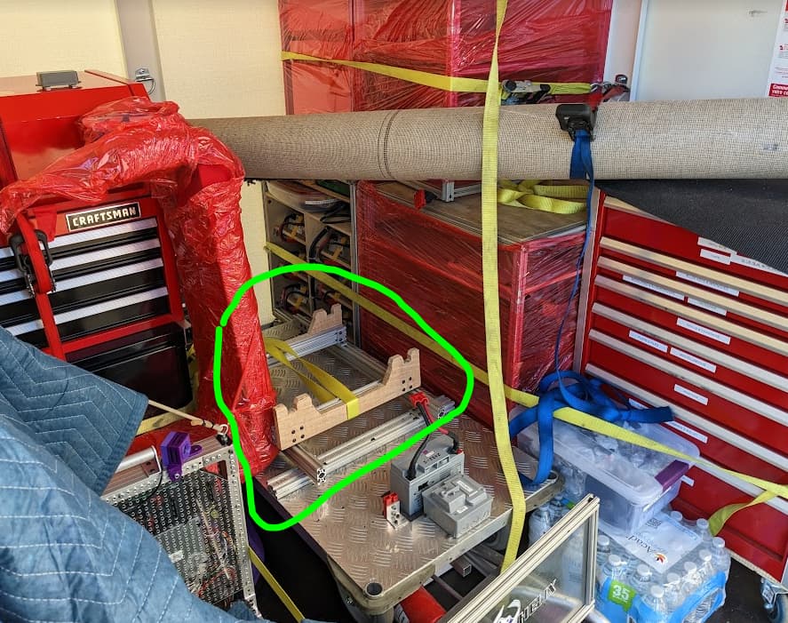

FRC 836 has neat wooden blocks that stick up from the top surface of their cart. The blocks are reconfigurable to fully constrain their chassis.
Inspired by 836, this season I took on the side-task of rethinking the robot-cart interface to fully constrain our 2023 robot.
I came up with these plywood forks:
These are very cheap (in terms of time and money) to iterate on. They ride on t-slot rails, which can be repositioned in future seasons to support different robot geometry.

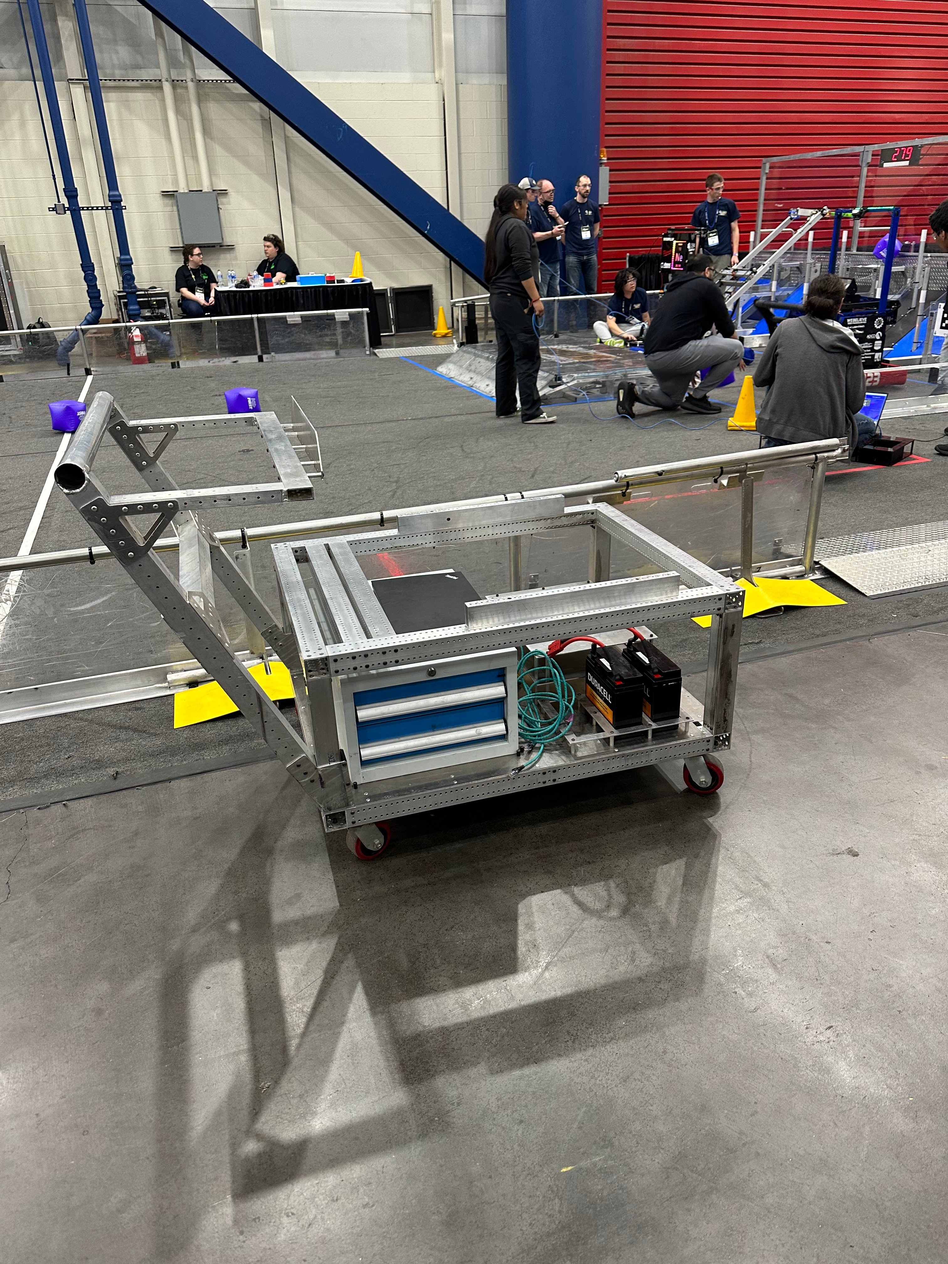

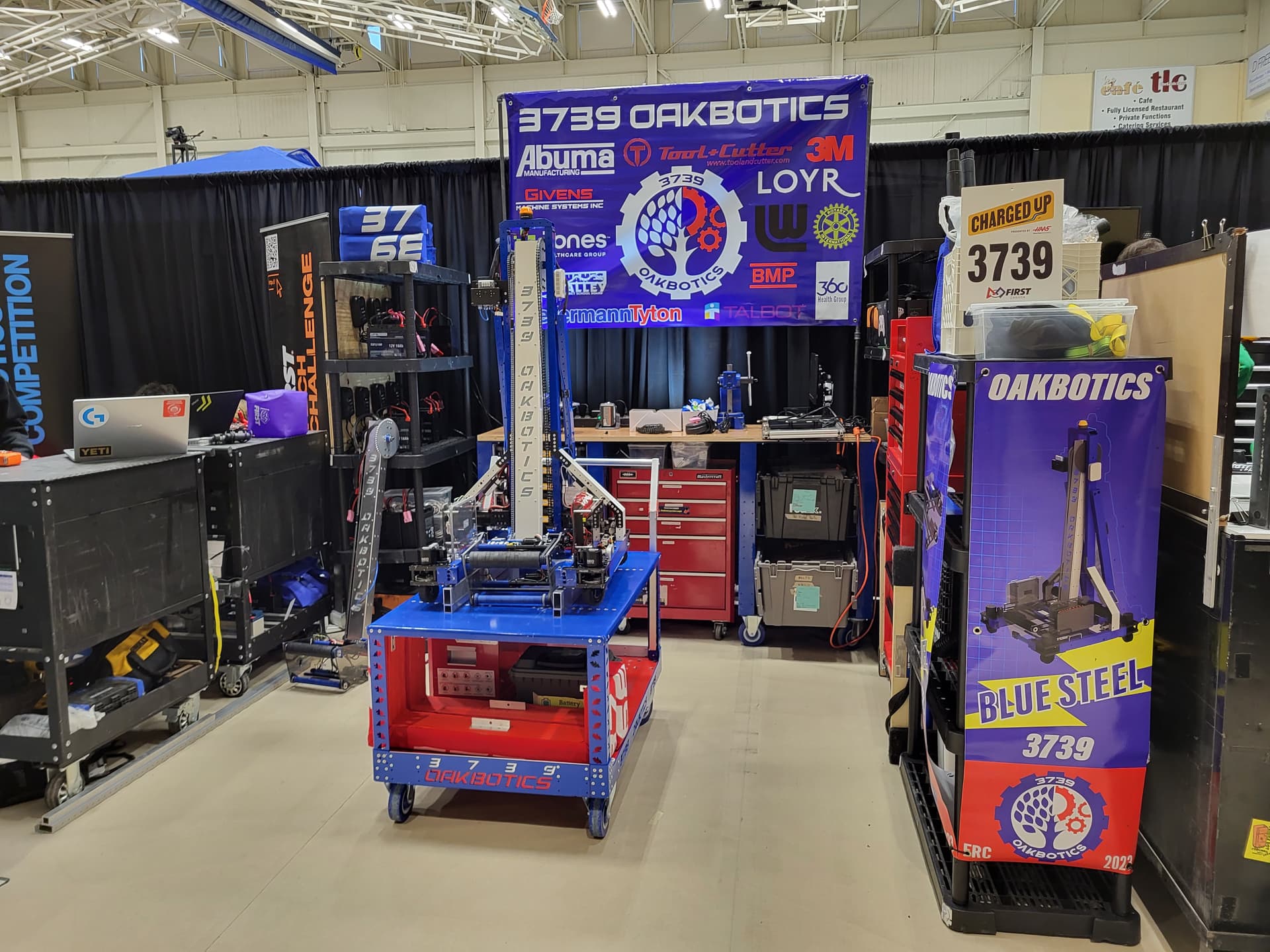

Suprisingly enough, I don’t have any overly good shots of our robot cart on it’s own, but here’s a CAD screenshot and a half decent photo from our first event this past season.
This cart was designed and built during the 2022 pre-season. The design took inspiration from this spectrum robot cart.
Main features of this cart (in my eyes):
  • Adjustable supports to keep robot wheels raised off cart (see aluminum tubing and the array of holes for adjusting from season-season)
  • Light weight/easy to maneuver
  • Robust 5" casters for navigating cable protectors and parking lots
  • Small too chest/drawers for essential tools needed field side
  • Large open space for versatile storage options
  • Removable handle (helps when transporting the cart, ie shorter overall height)
  • Looks good, encompasses team image and is robust enough to be used for years to come
Initially the top of the cart was about 32" off the ground for the 2022 season. For the 2023 season, we shortened the 4 legs of the cart by about 6" for a table height of about 26". In 2022 our students (and shorter mentors such as myself :sweat_smile:) struggled to safely lift the robot on and off of the cart. The lower height is much more ergonomic, and was still easy to work on the robot (a concern when talking about lowering the cart).
The only thing that I would add/change to this cart would be a dedicated place to store a driver station. I like the looks of the collapsible shelf brackets posted by others above, that may be a retrofit we look into for 2024…

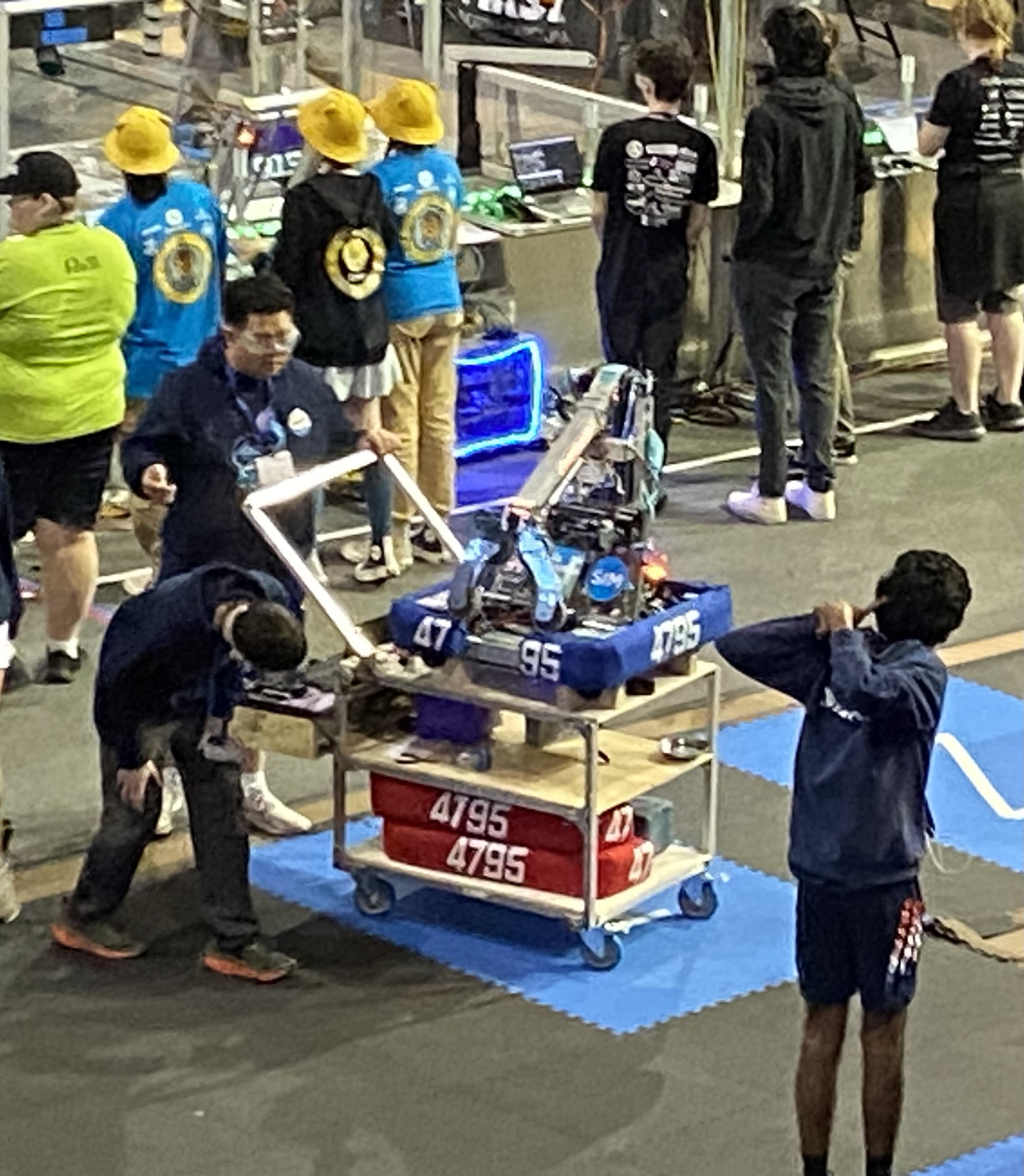

4795’s robot cart from this season folded
The whole thing was built on a 1x1 frame and held in the cart position by pins, which could be pulled out to let it 4 bar down into a much slimmer shape.
It worked pretty well, but the whole thing was kinda wobbly and creaky.

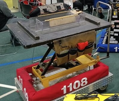

I agree. we use our hydraulic scissor lift on our cart a lot
Haven’t really felt need to change much over the years for the main cart. Having the lift has been useful for working at different heights. Originally only had the wood platform, but a student added this polycarb & tread central feature which has been okay for robots so far.
I like having the space under the cart for split bumpers. And usually easy to find a battery spot. We do have some pouches for storage and it would be nice sometimes to be more organized.

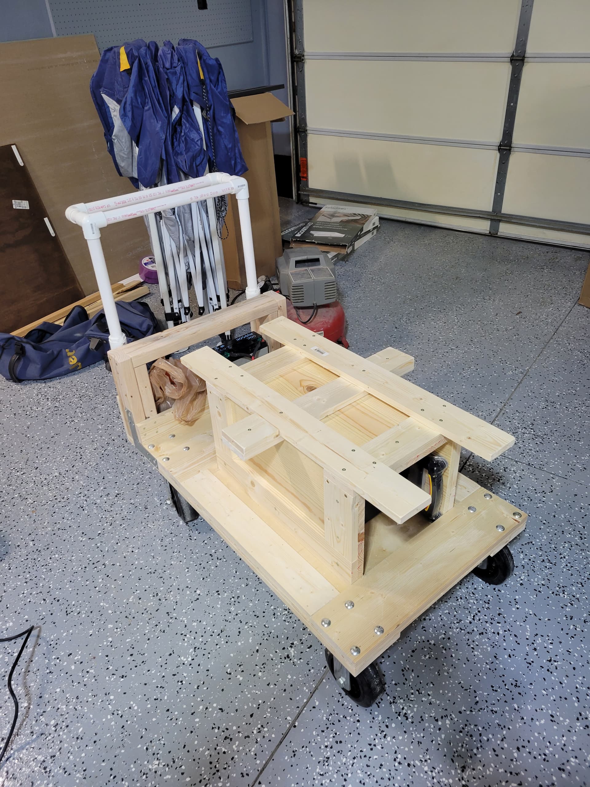

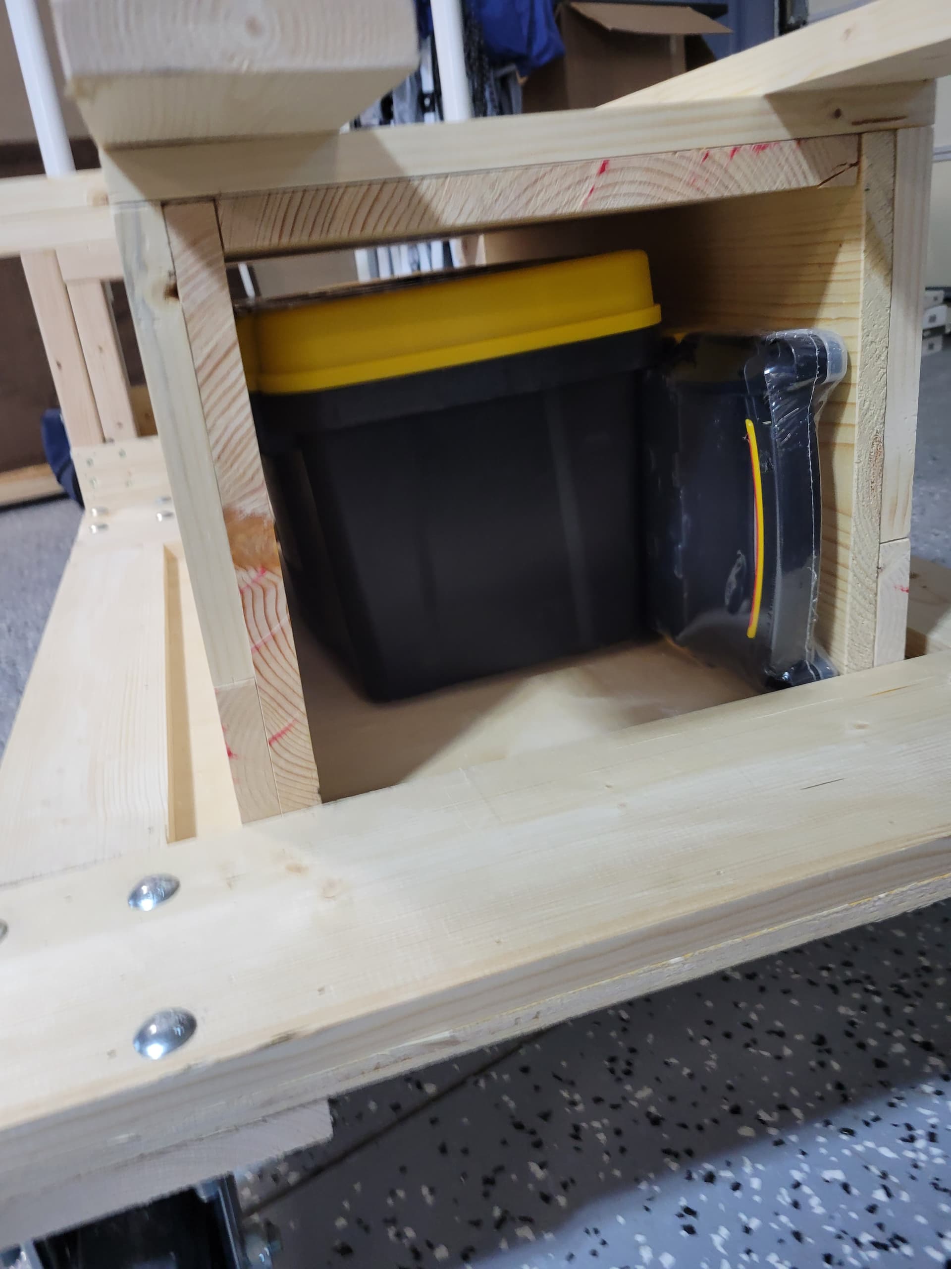

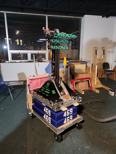

So, the team took the old cart apart and forgot to build a new one. Through this together over the weekend before competition.
Hold 2 batteries, spare bumpers, mix of fixed and caster (no air tires), rasy height. Removable handle for improved access, and “tunnel” for tools/quick fix stuffs.
Footprint was intentionally kept as small as we thought would be reasonable.
Upper robot support boards are easily removeable/modified for other robot footprints/needs.
We later added tiedowns for the robot for transit, and of course, a pink accessory bag for the coach. Later, we added on the handle side some water bottle holders for the comp team.
It may look like Wile E Coyote ordered it from Acme, but it was actually a pretty nice cart for the season. Nothing crazy fancy, but lots of lessons learned applied in its architecture and formation.
Start to finish was just myself with a handful of handtools and about 6 hours of labor.

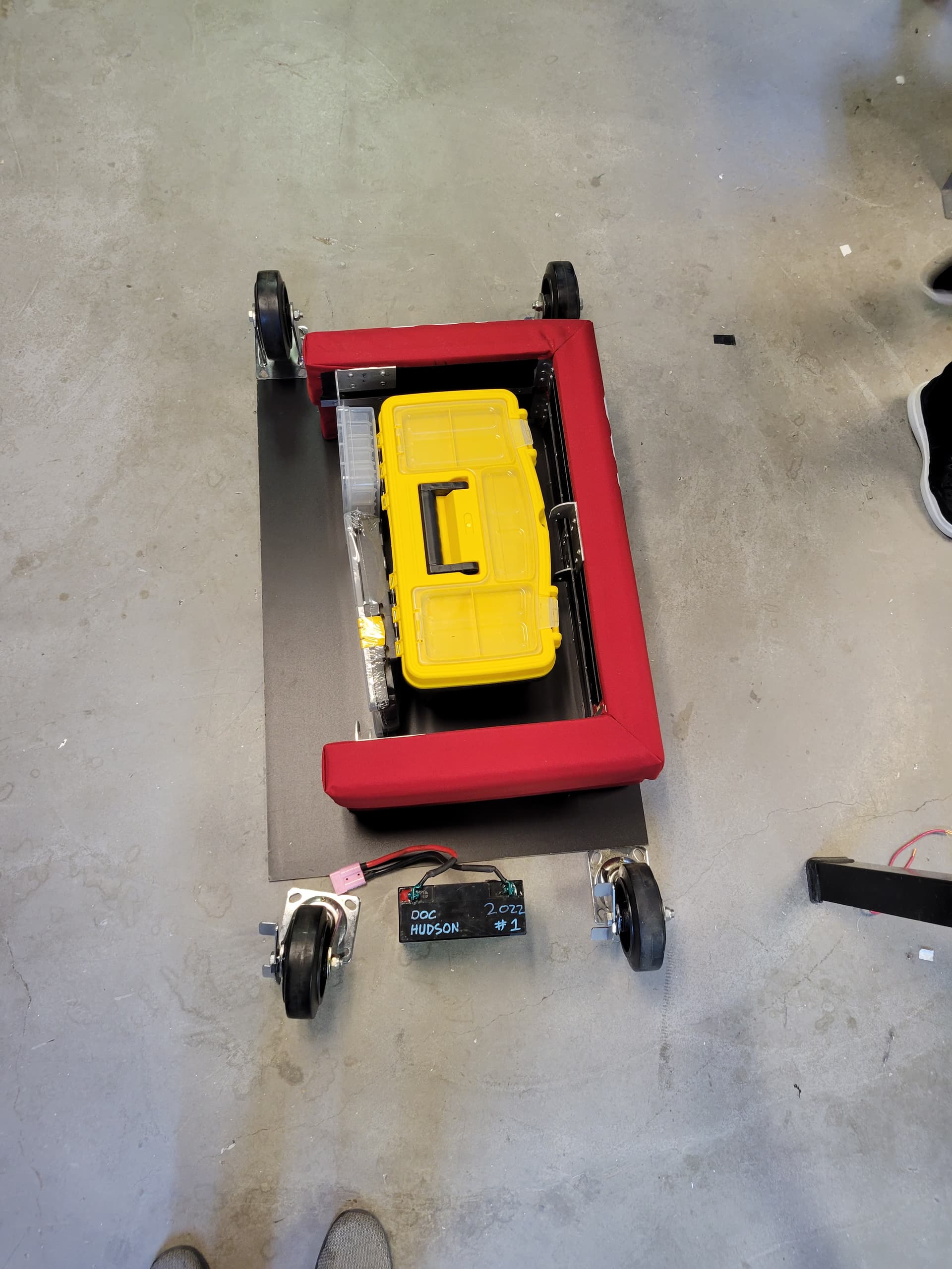

+1 on making a narrow pedestal for your robot so you can fit bumpers around it. Bumpers are big and awkward, and it’s nice not to have to store them somewhere in the pit. I’ve even seen teams use an upturned KOP tote for the purpose.

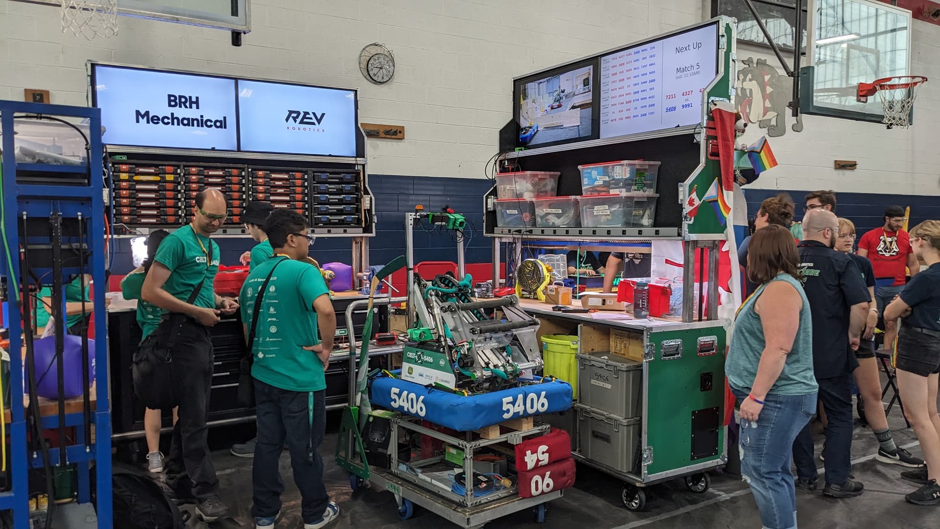

1323 has the cleanest cart setup I’ve seen in recent memory.
This is so clean

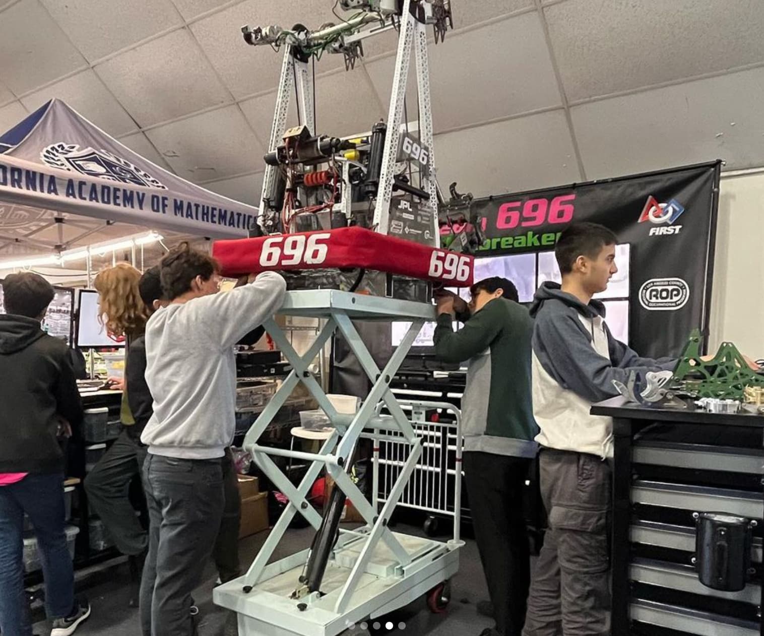

Team 696 (and one other team I saw at Champs 2022) has a Moto Cart Jr. ELT and it’s pretty great. We just VHB’d two 2x4 aluminum box tubes across the table to support a robot by the frame rails and keep the wheels off the table.
Pros
  • Hydraulic table that lifts about 6 feet high. I’m 6’2" and I’ve changed swerve treads at eye level. It’s pretty good for working on any part of your robot comfortably.
  • With the lifting table, it also works as a makeshift driver station on practice fields at comps. Drivers can stand with the driver station on it just like at the field.
  • Motorized wheels so it can just pull itself along, such as for the mile (ish) walk across the venue at Champs. Also great for venues like at Chezy Champs, where there’s a ramp up a small flight of stairs. I’ve seen teams need running starts with 3 people to make it up the ramp, and some occasional crashes. A small person can handle the bot by itself with this.
  • Reverse beeper can be handy for getting people out of the way in the pits (re Stop Yelling Robot)
  • 1000 pound capacity makes it pretty useful around the shop. We’ve used it for moving big air compressors around campus, dragging carpet rolls around, and as a makeshift scissor lift (don’t tell OSHA)
Cons
  • It’s a bit of a beast. Weighing in at over 500 lbs, it takes a bit of practice to get a hang of how it drives and how to maneuver it well.
  • You have to charge it. The battery lasts quite a while though, so I can probably count on one hand the number of times its needed to be charged in the last 4 years. When we’ve forgotten to bring the charger on trips, it’s always lasted just fine and the battery indicator (which may have questionable accuracy) never budges.
  • It can act up sometimes and seem to stop working. At Champs this year it did stop driving the wheels, and the manual override switch leaves you pushing a 650-pound (with robot) cart back and forth, which seriously sucks.
Conclusion
It’s got some nice features, but can also be seen as more trouble than it’s worth. We used one of these from Harbor Freight for many years and it was great too. Light, decent lifting height, not bulky at all. The Moto Cart Jr. ELT is not for the faint of heart.
