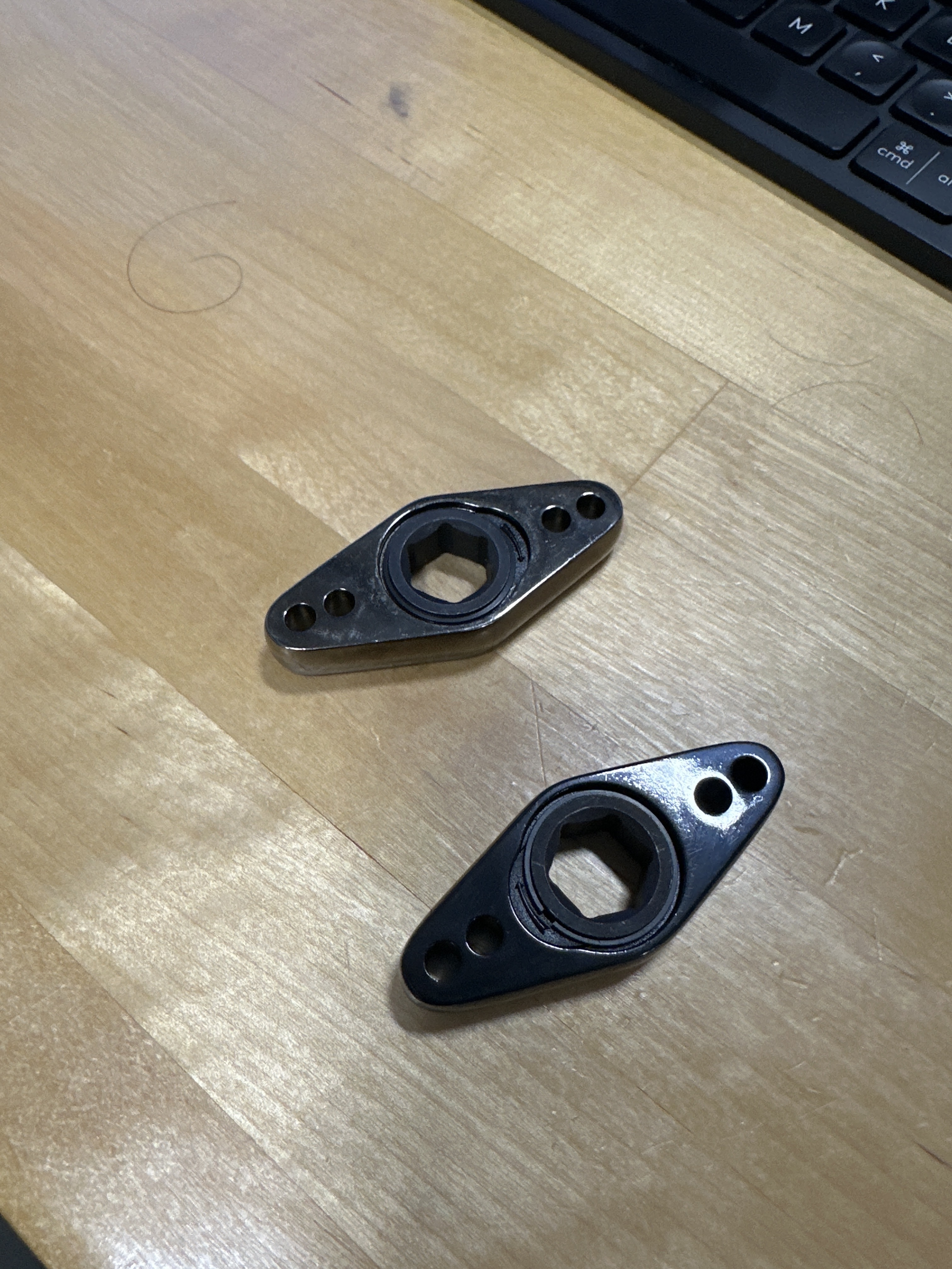

We copied the rachet this season and it worked amazing. 10/10 would recommend:
@R.C showed some samples of an FRC designed rachet that fits the standard hole pattern, both online and while at champs. I’m sure he can provide more details, let’s just hope we caught him in his sweater today.
I know I’ve been hyping these up but they came in a few weeks ago. They’ll be up on the site starting next month as we start rolling out new products and cleaning up the site

Me waiting for the rachet plates this season:
Happy to hear you got the issues sorted, they will be a such a cool product.
Cast housing? Steel?

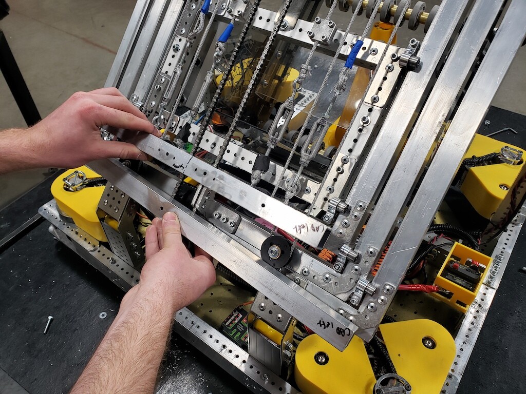

While not pretty, off-the-shelf turnbuckles work for the job of tensioning. Jam nuts prevent the turnbuckles from coming loose.

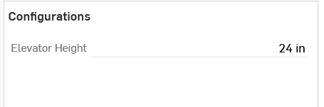

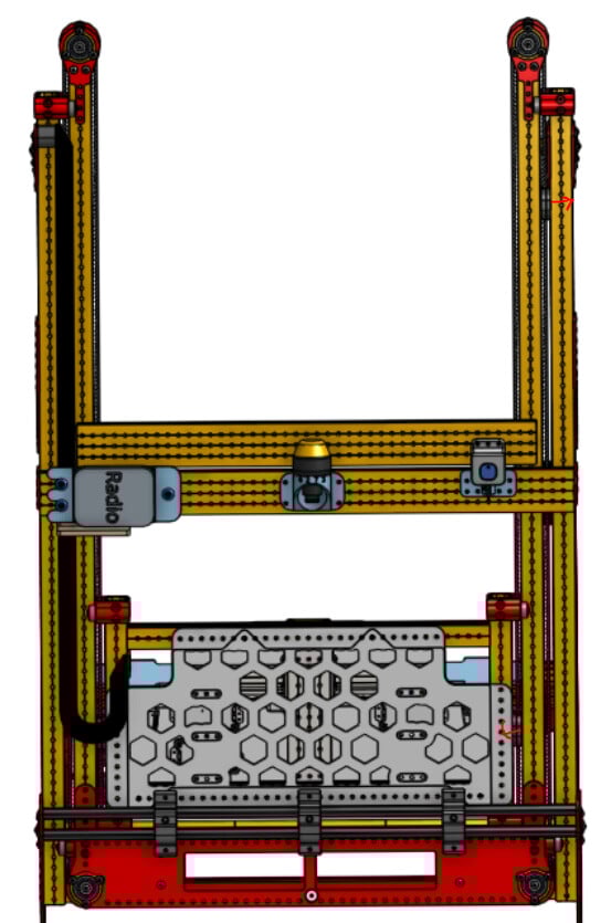

Wow, what a cool elevator. Do you think you could send more images or the CAD file? Thanks.
Sure, No problem. This was a really cool feature on our robot. This season we worked to implement configurations in our parts and assembles. You can adjust the height of the elevator here, to get a feel on how it works:
The nifty thing was getting the wire chain to follow the elevator height. :grinning:
Here is the Elevator for the 2023 robot
Here is our preseason cascade elevator design
Awesome. Thanks a ton.
