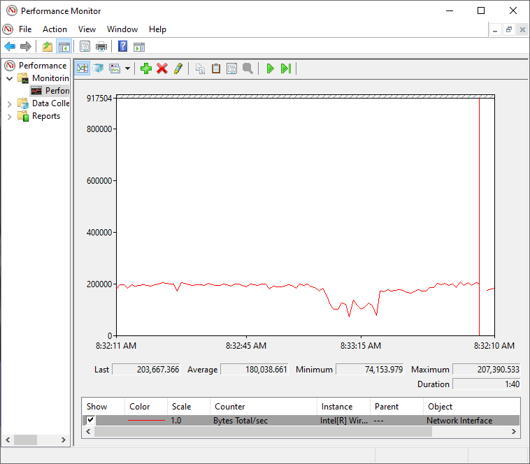

Did you measure the bandwidth your robot was using? Measuring Bandwidth Usage — FIRST Robotics Competition documentation
We have not. But now that you have pointed this out it is the first thing I am doing in the morning.

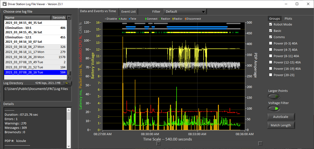

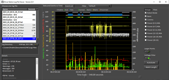

At the shop this morning I set up the bandwidth monitor and checked the ds log.
Here are screen shots of just basic driving.

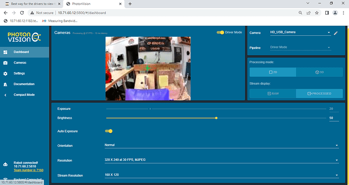

This is with photonvision running. I’ve included a screen shot of PV camera settings.
It seems to display the camera just fine here at the shop.
