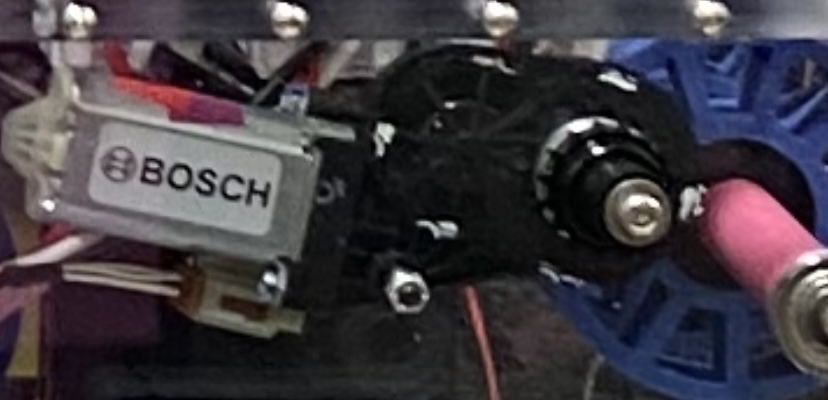

We’ve used the Bosch Seat Motor to actuate our intake for a few years. This year, we added a home-made friction clutch to it (sprocket with a 13.75mm bore squeezed between two shaft collars, using an acetal spacer as a “spring” with a bolt in the end that could be tightened or loosened). The clutch does a couple things:
  1. It makes the PID loop easier (using a REV Through-bore encoder on the intake shaft, not the built in encoder on the motor), as we can manage the friction so the intake would droop down if it was raised too far.
  2. It allows for some flexibility in the intake, so the ball can push the intake up a bit as it comes in over the frame
  3. It lets the intake push in without damage when we run into a wall, and “spring” right back out thanks to the PID loop.
  4. With a speed of ~24RPM, and a necessary rotation of less than 30 degrees to get to our setpoint, it means we can get there in half a second or less.

Unfortunately, we never got it into CAD - we sort of made it up as we went along. Picture below probably doesn’t help much, but it’s the only one I have showing it (and I won’t be back in the shop until Monday - spring break).
The stack-up looks like this:
  • Bosch seat motor on the inside of our 1/2" polycarb side
  • AndyMark hex shaft adapter , with the retaining screw in the back
    – Added groove for an e-clip, located just on the inside of the polycarb (so the retaining screw/washer isn’t taking the force of the friction)
    – turned down to 13.75 mm (aka thunderhex) outside diameter
  • two bearings, one pressed in from each side of the polycarb (we may have an appropriately sized spacer in here for added structure, I can’t remember)
  • thin spacer to ensure we’re rubbing on the inner race only
  • metal shaft collar (not tightened)
  • sprocket, with the inside bored out to 13.75-ish mm (aiming for a slip fit without slop… more of a feel thing with the shaft than an actual measurement)
  • another metal shaft collar (not tightened)
  • Acetal spacer to get us a little past the end of the shaft
  • Bolt and washer, with loctite
Typically this sort of thing would have a spring in it, but we didn’t have any on hand and found that by adjusting the tightness of the bolt we could make an adjustment to how strong the clutch was. We tightened it up to the point where it would slip down to where we wanted it and called it good. So the spacer provides the “spring”, and the two metal shaft collars provide the friction (aluminum on aluminum). The force of everything is going against the two bearings, so we don’t worry about stripping out or damaging the motor.

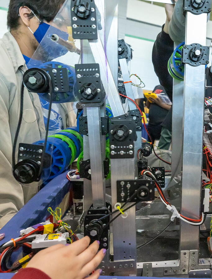

Here’s a a snip of a picture (taken by the wonderful Dan Ernst) of our robot as it stood at the Detroit District.
The belt being squeezed together by the yellow zip tie and spacers is mirrored on the opposite side of the robot, and are what is driving the lower links of our four-bar.
Since Detroit, we ditched the zip ties for larger pulleys which seems to have solved our belt slipping issue that the zip tie tensioner was there to mitigate. We also increased to a ~60:1 reduction in the ultraplanetary stack, with an additional 1.25:1 reduction using larger pulleys after the gearbox.
As pictured, I believe our reduction was ~30:1 in the UP stack and 1:1 pulley to pulley. It worked to get the intake in and out, but definitely had some hesitation while retracting. I can snag a better picture of the updated mechanism at our meeting tomorrow if wanted.
