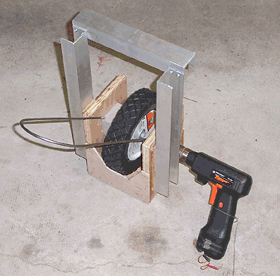

I disagree, and I see no need for a ‘barrel’. In a protoype I built today (see photo), the balls went very very repeatably to the same spot. The biggest variable will be the supply voltage (= motor speed), but the astute student will figure out how to compensate for that :wink:

In the photo, that is an 8" wheel. At about 1300 RPM it launches a 7" soccer ball about 10 feet (from a table 40" from the floor), and in ten tries they all landed within an inch of each other.
The biggest issues are balance of the wheel - it wobbles a lot at 1300 RPM, it’s not made for that - and the huge black marks the rubber leaves on the ball.
