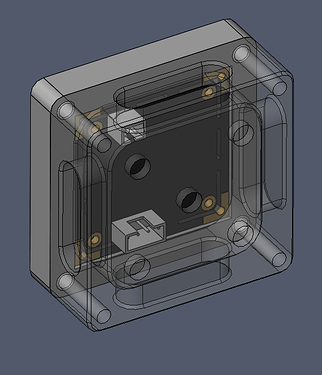

Bought these as well. Easy to print a housing on a 3D printer.
We went with this Sony camera from Amazon. Also like what Nick.kremer recommended, but higher resolution. It is already cased, but very small and with a solid 180* field of view. It also has a nice long USB cable, so no need to put on an extension cable even if your doing something like mast mounting the camera. I mentioned this camera in another thread because we will be using more of them in the future due to the vastly better view they give our drivers.
Any chance you’d be willing to share your housing CAD?
Yes… once I find it. I realized after posting that I didn’t know where it was!
And… I’m not finding it anywhere. 15 CAD files with camera in the name, none for this one. If I stumble upon it in the next day or two I’ll post it. Otherwise, I’m sure you can manage one!
Here’s the STEP file for the case I designed back in 2019 for use with these cameras, there’s a 0.5" pitch hole pattern for 10 bolt on the back for mounting. I believe it uses 8-32 bolts to hold the case closed.
