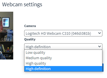

I’ve been using Zoom today, and will for the rest of this week. We have Canvas, which has Big Blue Button as its video conference integration. When I use Canvas it gives me the option of setting my video quality.
Not sure how great it looks to the students… but the option is there.
