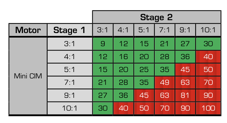

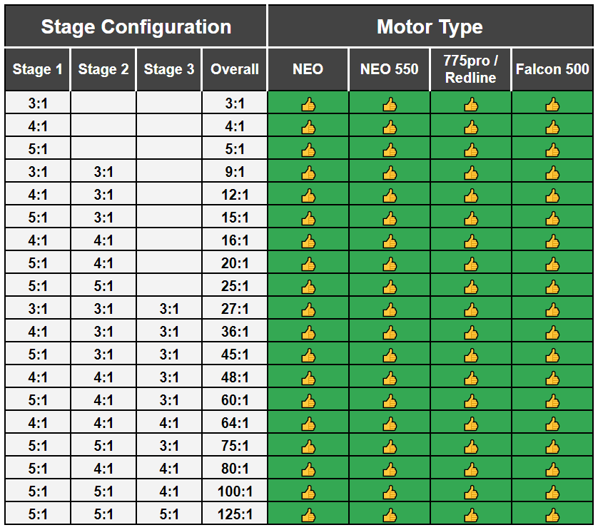

We were discussing load ratings with our students last night. An easy way to avoid this scenario is to reference the load ratings that the manufacturer publishes.
This is saying that if you adhere to these ratios, it should be impossible to break the gearbox because the motor will be incapable of applying enough torque to cause that to happen. If more torque than that is applied on the arm, the motor will just back-drive.

Good idea! This is why I love the MaxPlanetary because the load rating is just: yes

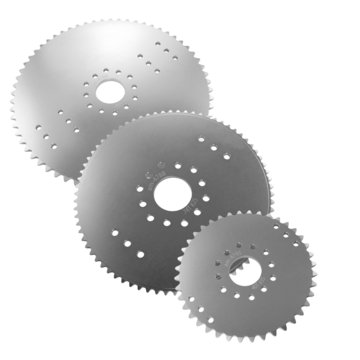

It looks like AndyMark is now selling #35 and #25 Plate Sprockets with much wider bolt patterns (looks like 1" pitch?), which is neat.
