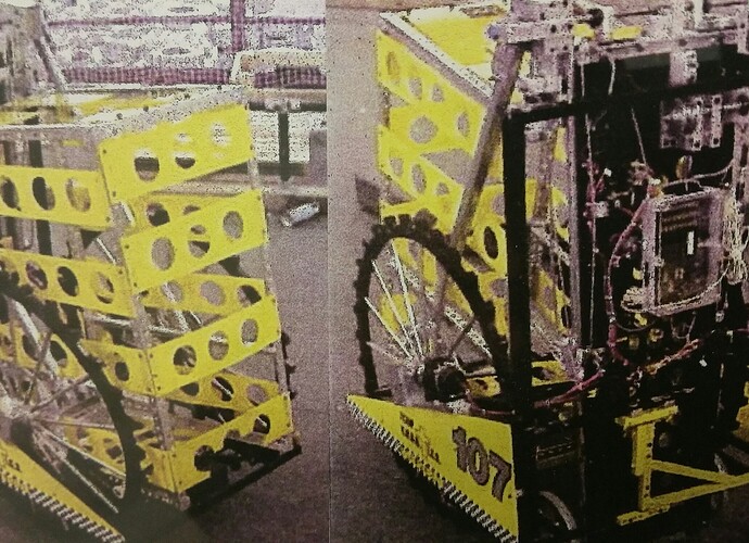

Looking though old pictures and I think these are the largest wheel in first history.
Jim,
Those are in fact very large wheels for a FIRST robot but you know this isn’t going to end well for you…
I know 107 is indeed a low numbered team but with tens of thousands of robots in FIRST over the quarter century, you KNOW that someone is going to say, “no so fast there, Mr. S. There was one regional back when dirt was new that had wheels the size of …”

Just to Clarify, I strongly wound not suggest wheels like this for Stronghold. But on another note, This is my 20th year do this and it nice to still see some “old” faces like yours around. You and Your Chief Delphi team was a major inspiration for me in the early days of FIRST.
jim
