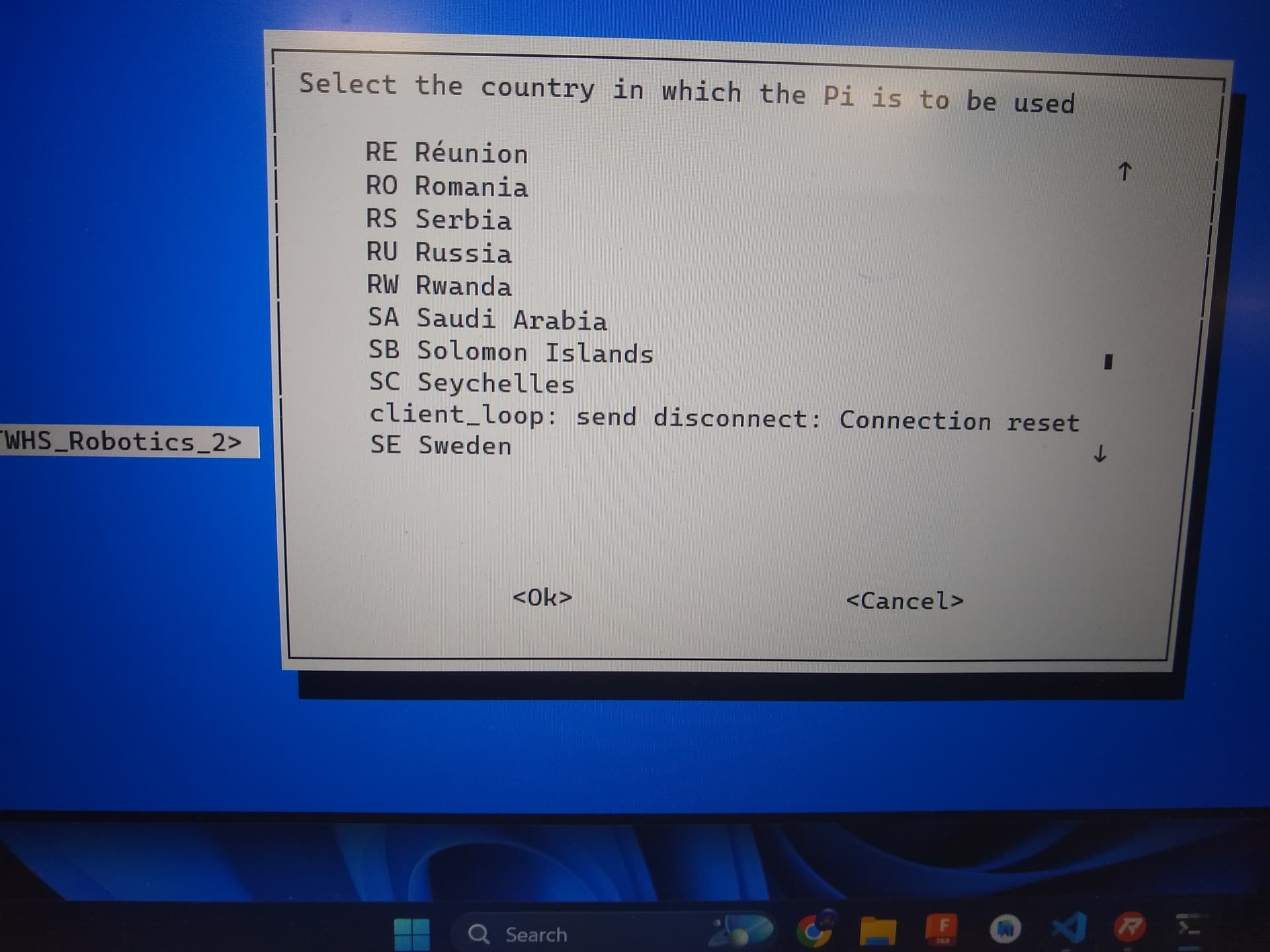

I am from team 9418 and this is my team’s first year in FRC. I am currently working on transferring my team’s raspberry pi 4B from the wpilib image to raspberry pi OS and have been encountering serious issues when trying to SSH into the pi. Whenever I try to SSH into the pi, it will 95% of the time throw one of many different error messages. When I do manage to connect to the pi successfully, it will work for enough time to run a few commands, and then it will freeze and sends this message: client_loop: send disconnect: connection reset

I managed to get a hold of a micro HDMI cable today and set up a monitor and keyboard to set up some libraries on the pi. I am still worried about how the pi will integrate with the robot later those. One thing I did notice is that it gave me a low voltage warning. Do you know if low voltage could have any impact on my issues?
Low voltage was the first thing that came to my mind when you described the issues. Yes, I think a better power supply and perhaps a different USB cable for power would be a good test.
Yeah, I’ll probably do some testing with a different USB cable. I used the ones that came with some REV electronics, so I’ll try some new ones.
Check the specs for your power supply – the Pi 4 requires 2.5 amps even with no USB peripherals plugged into it. Otherwise, 3 amps.
Thanks! I’ll let you know how it goes once I do some testing.
Yeah, I plugged the pi into a proper power supply and it looks like it works now. Got vision on raspberry pi os running now.
