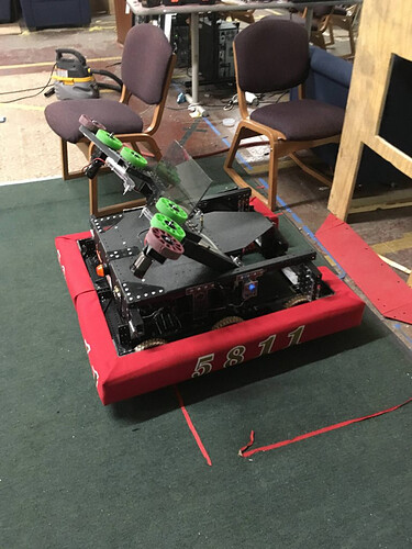

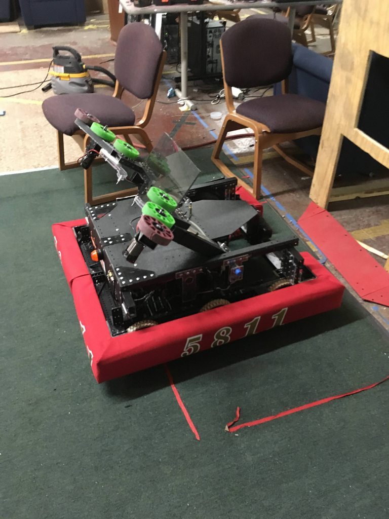

We used black numbers outline in white last year and didn’t have any issues.
Any chance you could PM me a picture? We were interested in seeing what it would look like.
BONDS has done white outlines with gold infill the last three years with no issues. Not a great picture but here is our 2018 robot with bumpers :

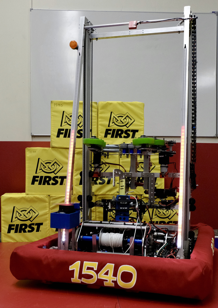

Within the district, a good example is 1540.
Any color numbers, even tie-dye, are legal, so long as they are outlined in white.

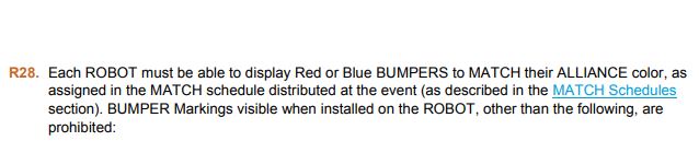

You’ll likely run into problems with R28 if you try to do that.
R28
it explicitly states the outer part needs to be white in R29. Invert it and youre good.
