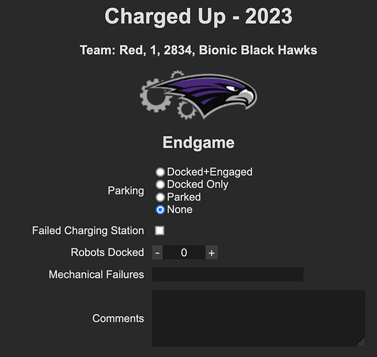

Is there a way to make the selected team number appear in the header so that scouts can refer to the number while scouting?
Also, is there a way to increase the size of the navigation options at the bottom of the scouting forms? With the tablets we use some people are having issues selecting the correct page.
Having the team number appear on every page was something that we had also considered for ease of scouting. The latest update of the app now has team information as a header:
