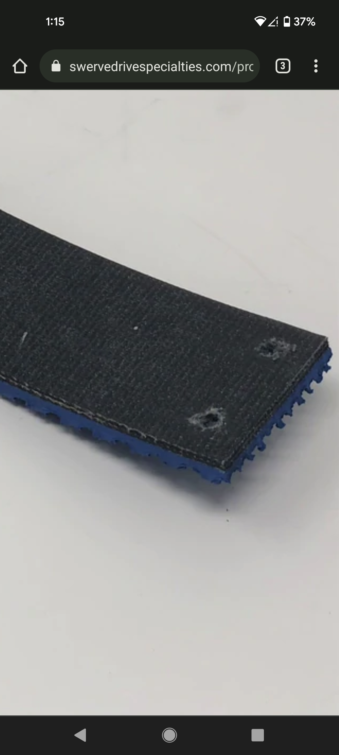

We had the same issue on our modules. The tread that initially came with them was great, we then ordered spares and they have been terrible. We have tried black and blue. The blue tread with the black backing we ordered through Andymark has been awesome. We change at the beginning of the competition and the tread has been phenomenal. We go through maybe a set per competition. The stuff we ordered through Swerve Drive Specialties with the brown backing has been really bad and doesn’t really even last through practice sessions. I highly recommend trying Andymark tread Blue Nitrile Roughtop Tread 1.5 in. Wide 10 ft. Long - AndyMark, Inc as all others have failed us.

Thanks Patrick. Could you give some background about the blue nitrile material with the black fiber backing? Did it become unobtainable? It is still pictured on the product page BTW.

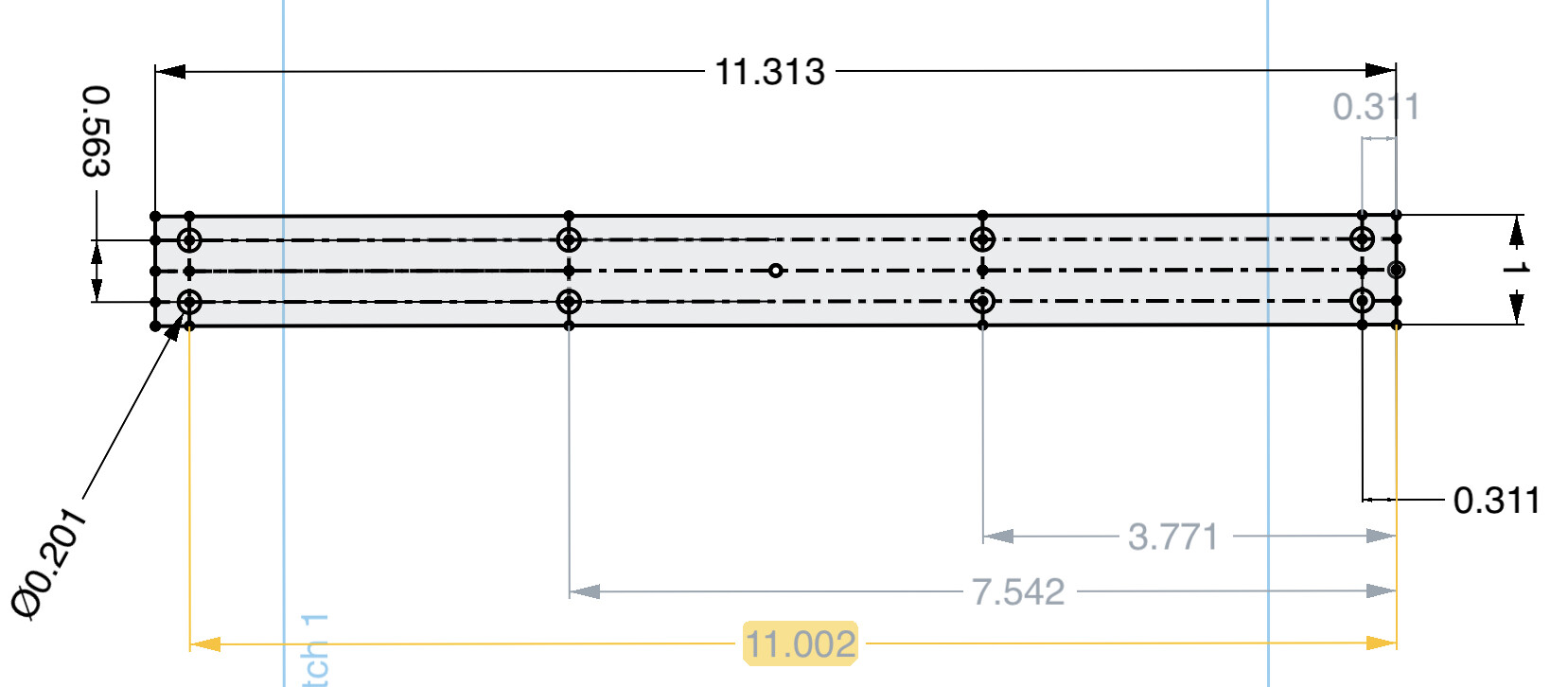

Will the same drill jig work for the blue vs black material
We bought some of the black tread and tried the same drill pattern as the blue tread. It was close but did not fit. Has anyone found the drill whole pattern for the black tread.
I spent several hours working out a new drill pattern for the black nitrile, it wasn’t much fun. I’ll see about putting it to paper and posting it during our Saturday build day.
That would be great. Thanks a lot. How did you go about finding the right hole distance.
Here is our drill fixture & pattern for black neoprene on the SDS 4” x 1” wheels. 4” x 1.5” uses this same spacing, just an extra 1/2” between the holes.
https://cad.onshape.com/documents/8d43ce66399a0ddbc0d7b36a/w/68e66d4f22880ffc565df79c/e/474e389ce54af7445e8d9648
Thanks a lot for posting this. How did you figure these out?
Empirical testing. Made a couple tread by hand and reverse engineered them.
SDS wheels have the bolts at 120deg spacing, with 5/16” offsets for the 4 near the joint. So figure out how long the tread should be, divide that by 3 for the inner 4, then put the 4 near the joint inboard from the edge 5/16” to account for the offset.
