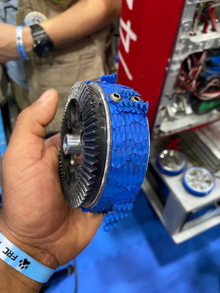

One reason there’s been much discussion on this topic is that some batches of the blue nitrile had serious issues with delamination. This is the worst we saw – one or two matches on new treads:

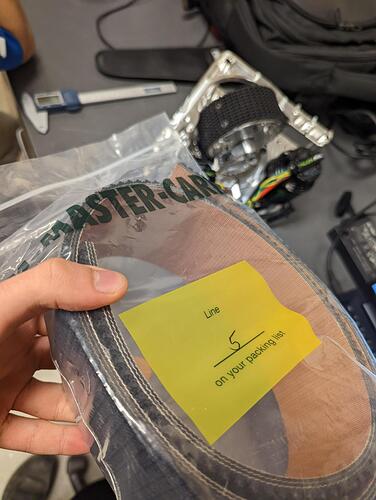

Hi Patrick. Sorry to post on such an old thread, but I just wanted to ask, the McMaster link you shared has a black backer, but everywhere else I look it has a brown backer. Did you change suppliers or something?
In my experience 5994K1 has a brownish orangish backer. We are getting the black neoprene tread from the same manufacturer as McMaster.

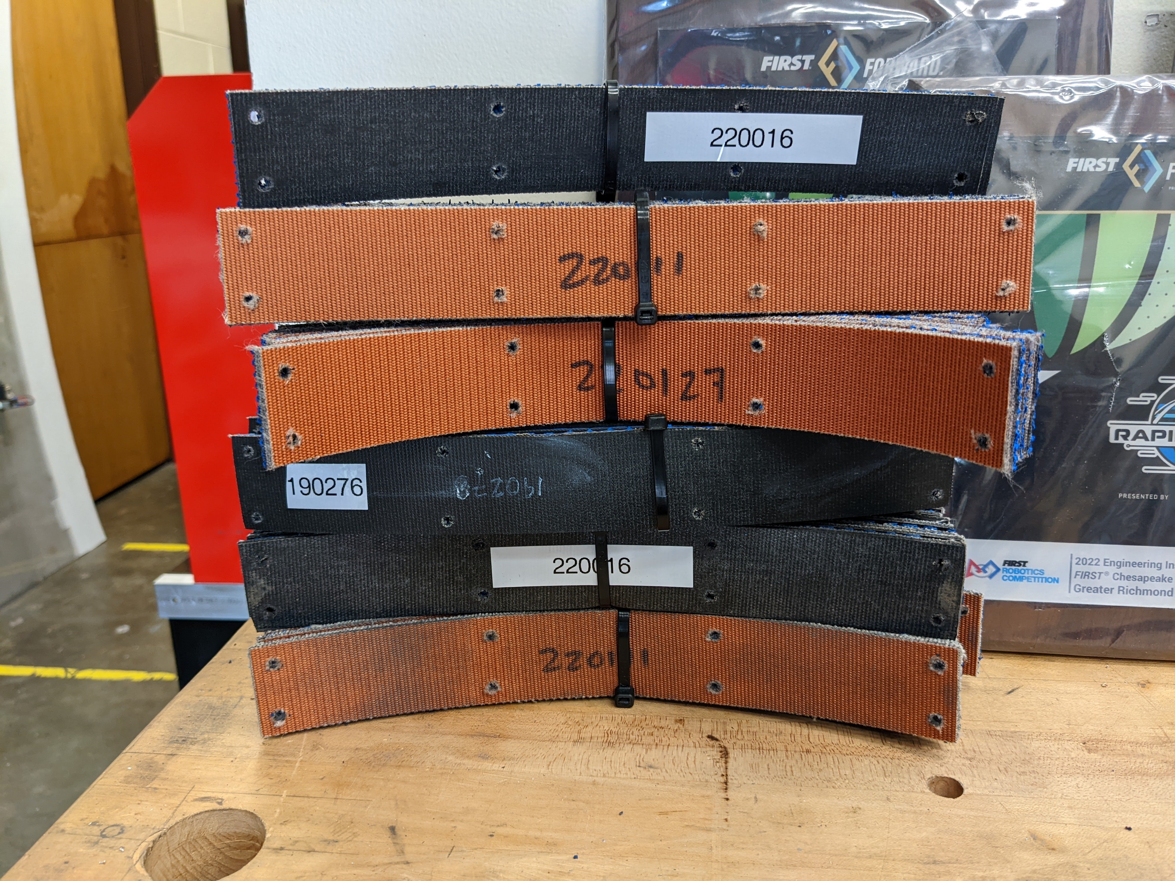

We also experienced this change in the blue nitrile material we got from SDS.
  • 220016 - SDS (came preinstalled onto spare wheels), August 2021. This stuff was awesome. We wish we could get more.
  • 220111 - SDS (precut and drilled spare treads), March 2022. This stuff crumbled at a mid-layer within the rubber, NOT at the interface between the rubber and the fiber backing.
  • 220127 - SDS (came preinstalled onto spare wheels), April 2022. This stuff appeared to be the same as 220111.
  • 190276 - McMaster 5994K9, May 2019. This stuff appeared to be the same as 220016.
Any idea if 5994K9 purchased today is the same stuff? Might be worth the investment to cut our own tread if it’s the same as the old black-backed SDS tread (totally not just to go with our color scheme…)
In our experience the black Neoprene tread we currently sell (which is 5994K1) is better than any of the blue nitrile / blue Buna-N materials.
5994K9 is blue with black backing and it is better than the orange backed blue nitrile that we sell. The orange backed blue nitrile material we sell is from a different supplier. Once stock is depleted it will be discontinued and we will only sell the best stuff 5994K1 Black Neoprene.

I can confirm that the mcmaster link has the wrong picture, it is the right material
This link you posted shows 3" as the minimum width. I’ve never ordered it before so is that the narrowest you can order it from McMaster
Yes, if you order from mcmaster you will need to develop a method for slicing the tread into narrower strips.
We have clamp jigs we’ve rigged up to rip the tread on our bandsaw at a consist width. We first free-hand bandsaw to length (maybe a bit oversize), then rip it in half to get two 1.5" strips. Having a bandsaw makes the job a lot easier and safer than using box cutters on this tread.

yeah, i am incredibly tired of finding blue chunks of tread everywhere, the black tread has worked better so far.
