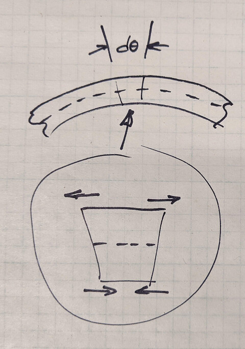

Yep-- there’s a neutral axis somewhere within the curved strip of material that experiences no stretch. Since this neutral axis lies somewhere inside the strip, its circumference must be larger than the wheel circumference.
Following Nate: the neutral axis is going to be in the middle of the fiber group… The treads don’t carry any tension in bending due to their teeth.

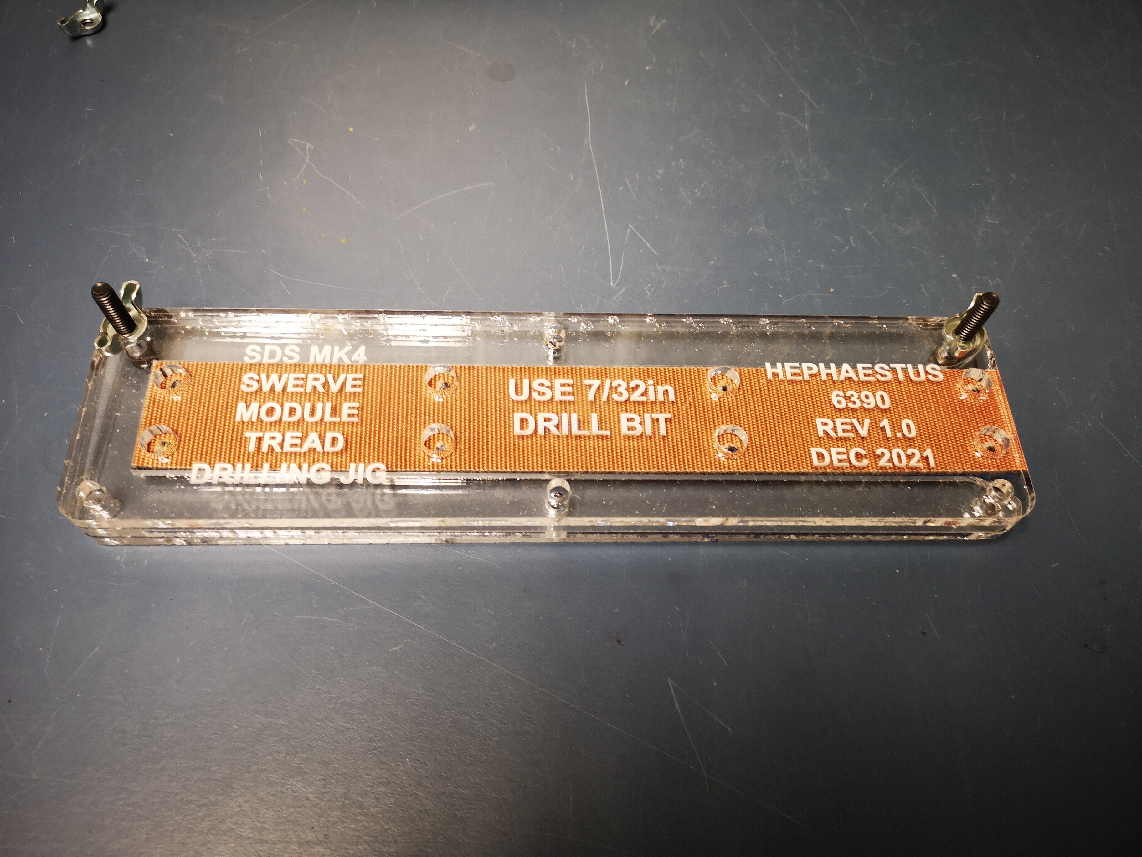

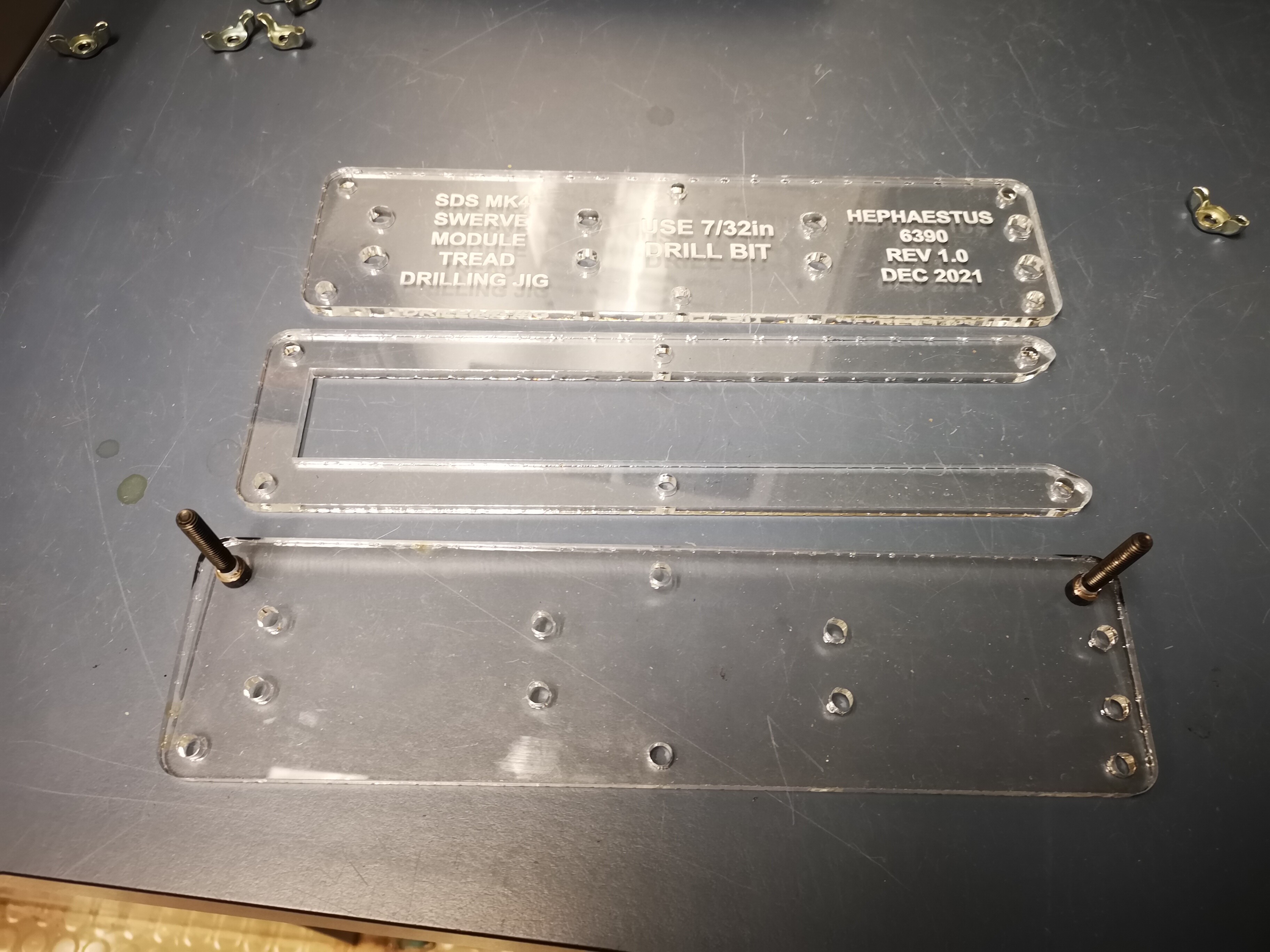

We made a tread drilling jig for the SDS MK4 wheels based off the measurements posted by @PatrickW
Still waiting on the drill bushings, but we used our laser cutter to cut out the 1/4in acrylic. Haven’t fully tested it yet, but all of the holes line up nicely with a factory drilled tread.

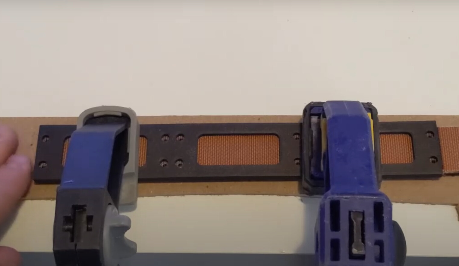

One thought is just to use the jig for marking and not drilling. Then line up and punch the holes. You’d just want a fine tipped marker and you can use the sight in the punch. A punch like this Whitney punch make a nice hole through tread without needing to clamp the tread so it doesn’t twist with the drill bit. I say this with the caveat we haven’t done the bulk number of tread that others have so clamping and drilling probably is better for some, but I think the 3d printer jig would be simpler without it and you can get faster after using the punch.
Edit: some reason I didn’t see there clamping solution in the first picture which isn’t too bad either
